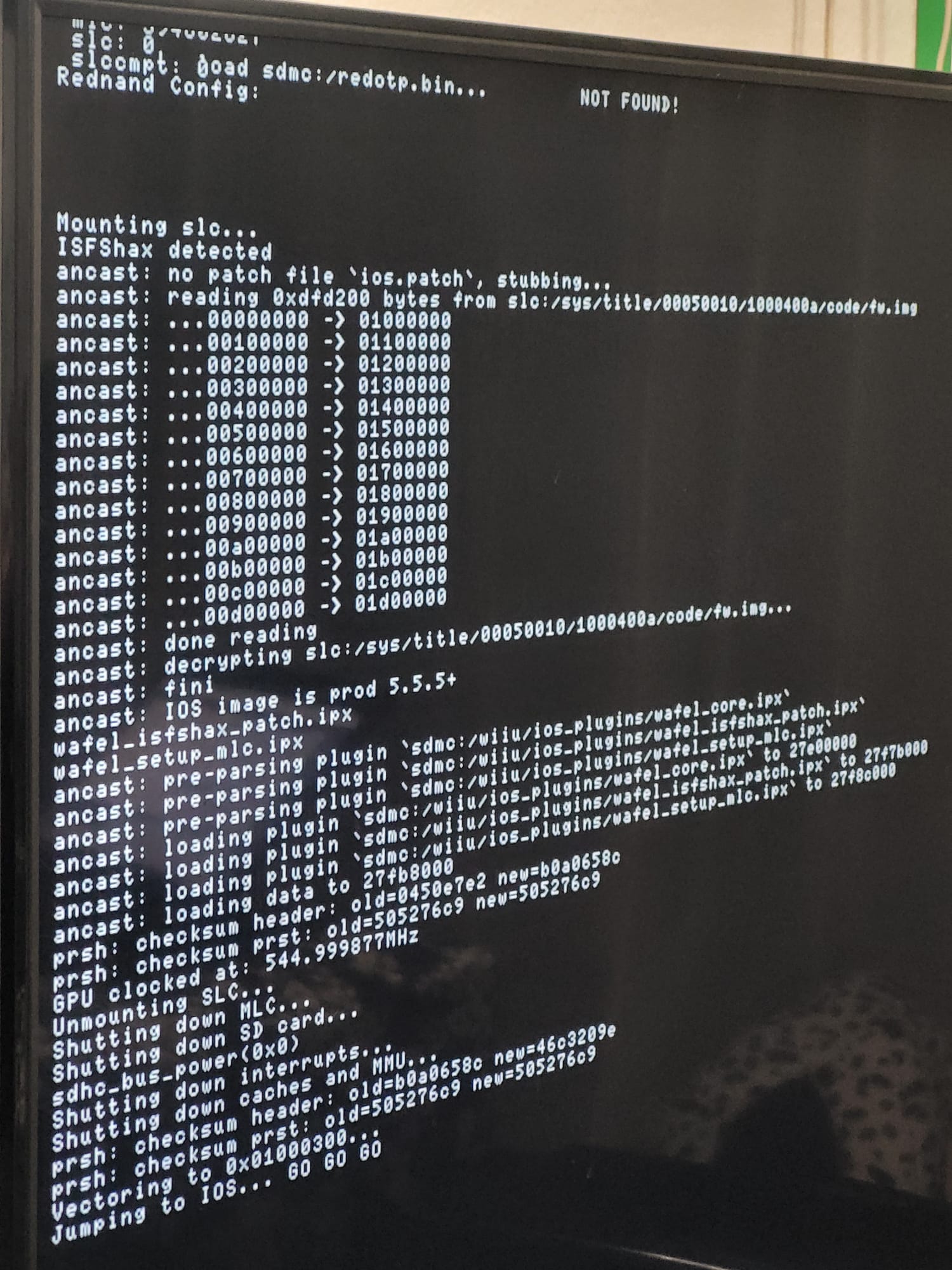

I tried with two 256 GB micro SD cards and one 128 GB SD card, every time everything seems to work well initially. The log file shows the installation of all channels, and the setup menu appears, but after the Wi-Fi settings, it gets stuck on the Wii U logo. After a few minutes, it fails with Error Code: 160-0101. What am I doing wrong?
I tried again with a 128 GB SD card. Before proceeding, I checked both FAT32 and NTFS partitions for errors and bad blocks, and both partitions were healthy. I copied all files, took backups, and rebuilt MLC. Everything looks fine, but when I checked wafel_setup_mlc.log, it didn't show the installation of all 57 (SLC and MLC) channels (the log is attached here).
I also copied minute.ini for autoboot and forgot to delete wafel_setup_mlc.ipx. Every time I went to the setup menu and exited, it got stuck on the Wii U screen. After realizing my mistake, I removed wafel_setup_mlc.ipx, and now it returns to the home menu successfully after I enter setup, make some changes, and exit.
Can I consider this successful, or should I redo everything until the log shows the installation of all 57 channels?
In case I need to rebuild the MLC again, as the log file shows only a few channels were installed, what is the best way to proceed? Should I drop the partition, reformat it as NTFS, and then rebuild, or is there another method I should consider?
