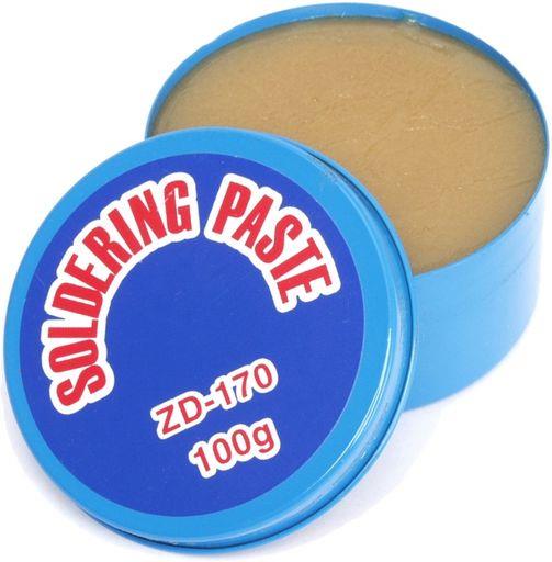

    Dear mitchjn:
    I want to inform you of the problem, it is a false contact on the ribbon of the buttons.
    [​IMG]
    I used soldering paste on the terminals and reconnected them to the gamepad and solved the problem.
    I hope this helps other people.
