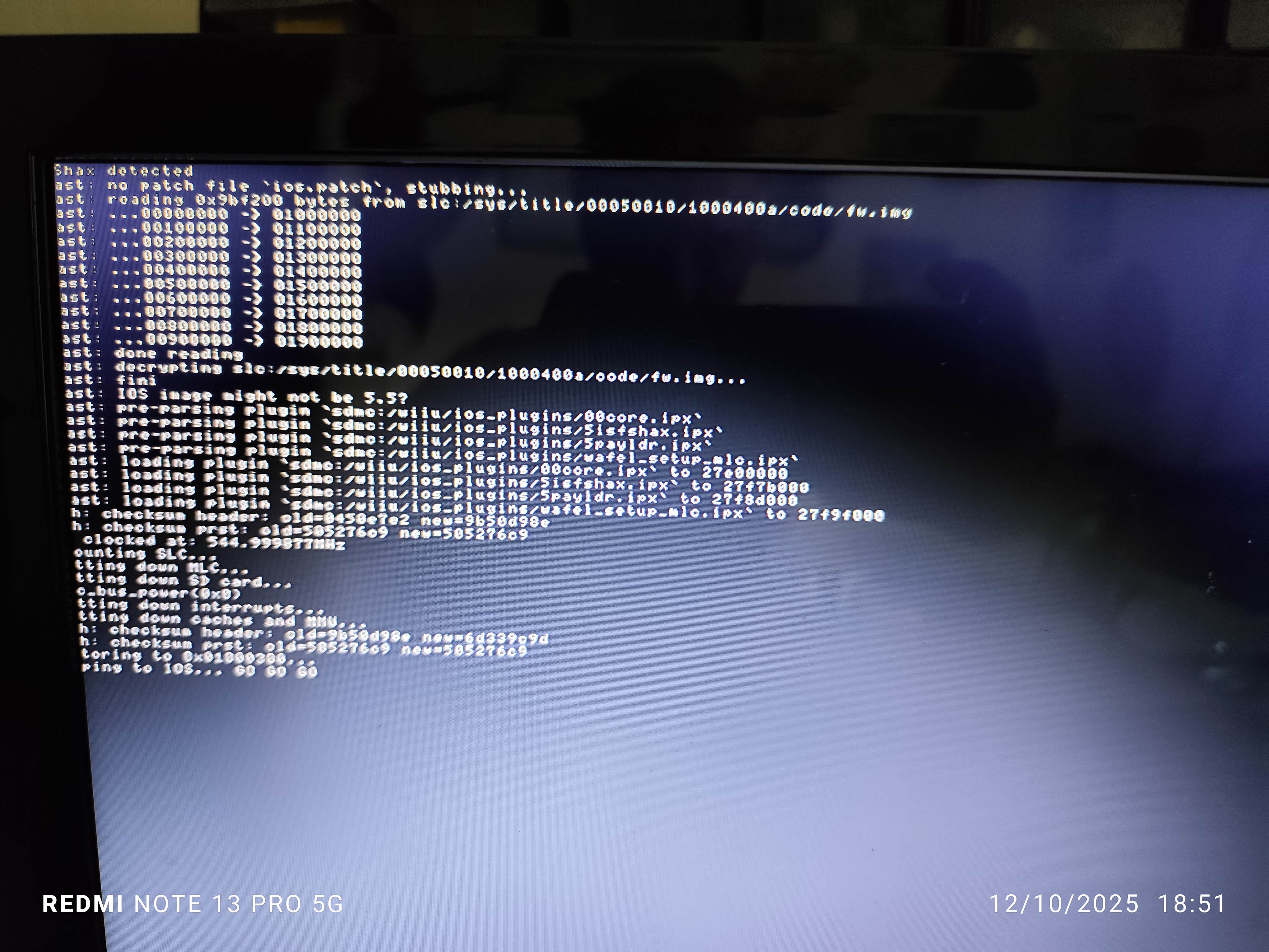

Good evening, I'm back 😁 I haven't been able to make any progress on this Wii U. In short, it starts and boots from the SD card with the quick menu. I created the RedNand partitions on a 64GB SD card using the RedNand format function. But unfortunately, when emptying the MLC using Patch (SD) boot iOS (SLC), I get this. I don't understand why.

For setting up redNAND use the redNAND guide: https://gbatemp.net/threads/how-to-...0-0103-failing-emmc-without-soldering.642268/
Nowhere does it say to use the format redNAND option in minute.
Also your firmware/IOSU is too old, so you also need the SLC titles and need to load the latest IOSU from SD for the install: https://gbatemp.net/threads/how-to-...ii-u-internal-memory-mlc.636309/post-10385733
If you are setting up the redNAND, then use the redNAND option with the ios_orig.img instead.

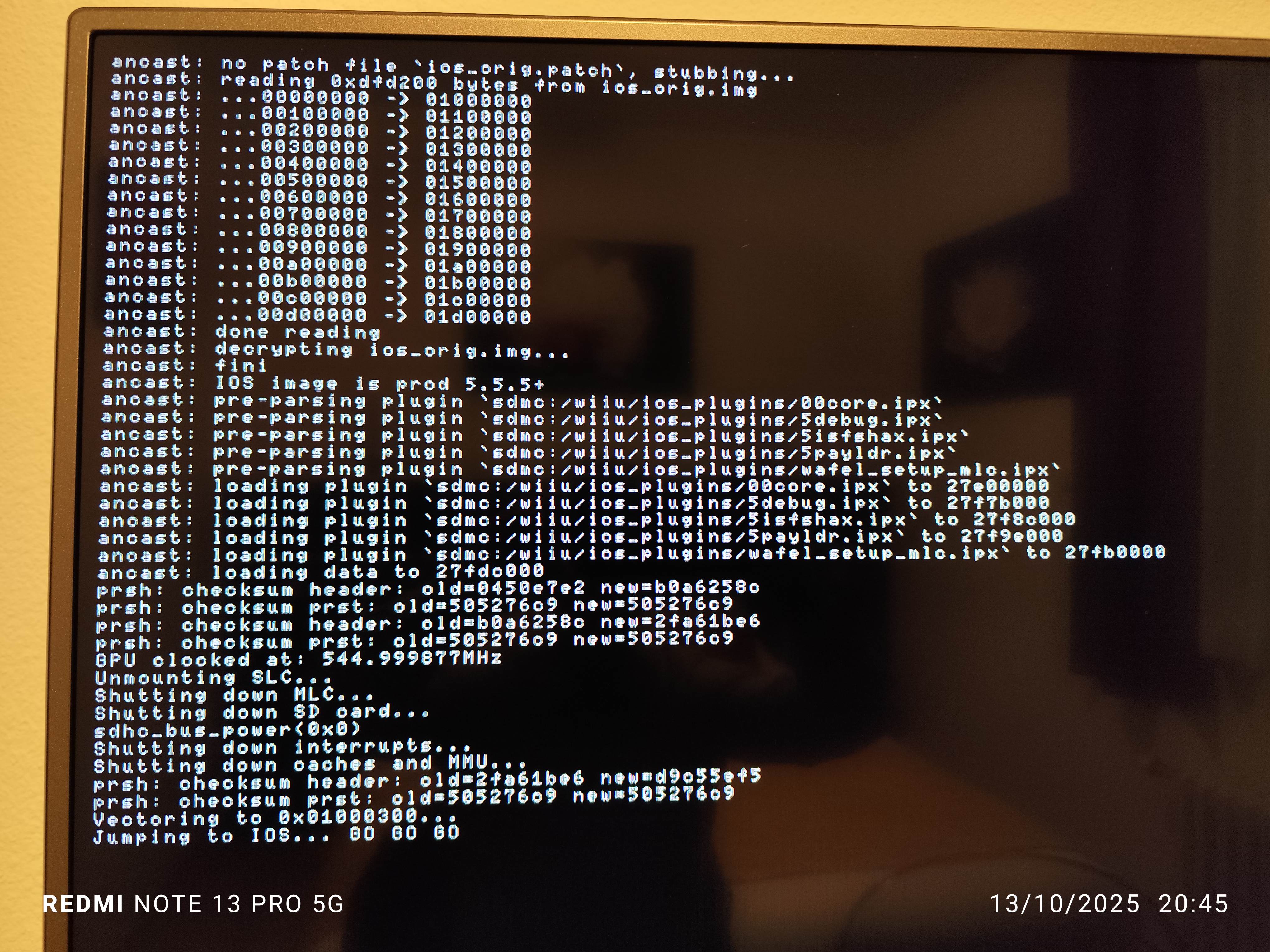

Good evening,
Thank you again for your help.
I followed the RedNAND guide. My SD card has two partitions, as indicated in the guide.
I downloaded OSV10.
When injecting (Patch (SD) and boot SDMC: /ios_orig.img RedNAND), I got what you see in the first image.

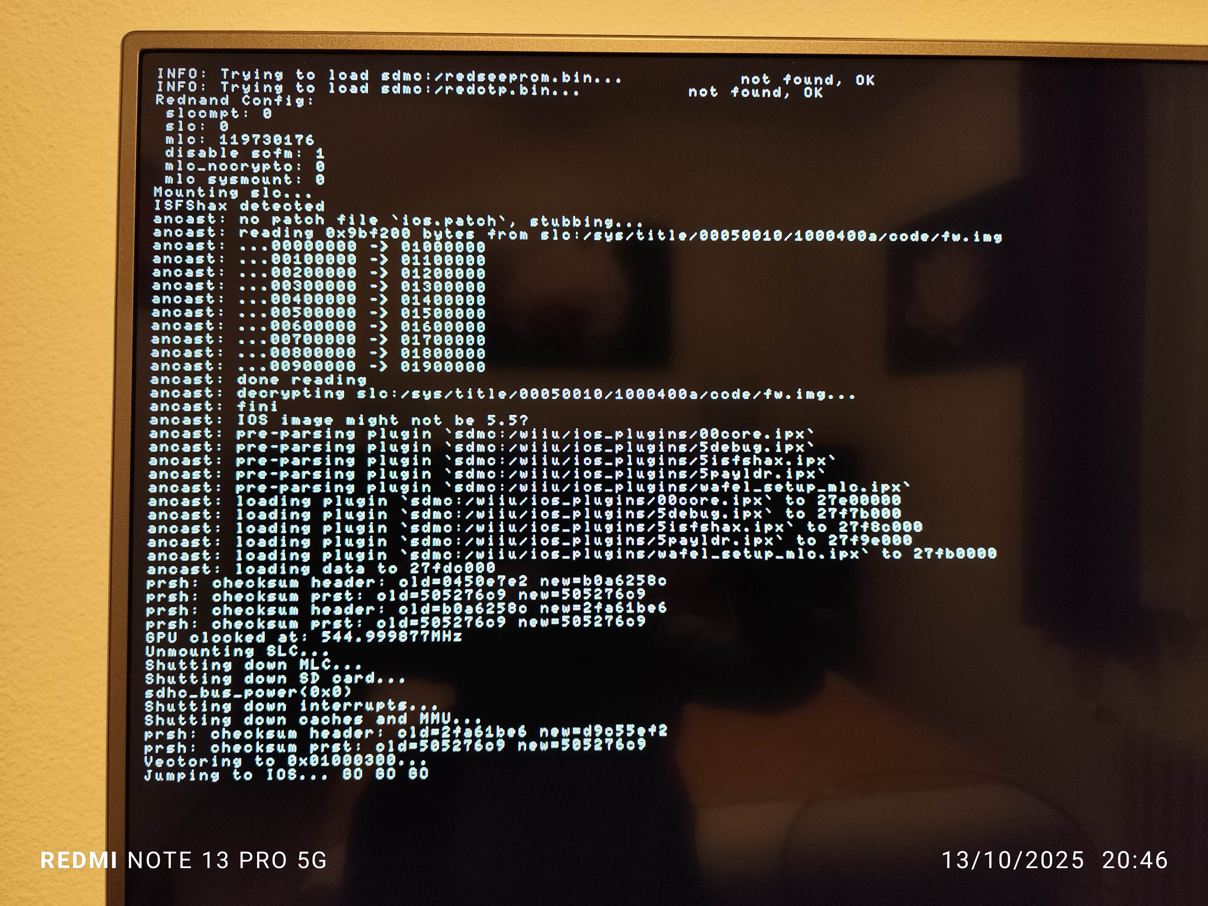

And then, with Patch (SD) and boot IOS RedNAND, what's on the second image.
