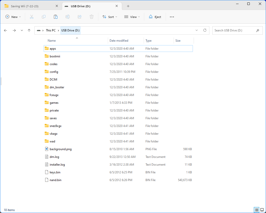

I bricked my Wii years ago trying to install a theme. Thought about dusting it off and try to fix it again. I believe I had bootmii installed but when trying to hold reset down, it does nothing. Thankfully I do have a backup of my NAND and all my SD card files. Anyway I can flash the NAND back on it or are there new methods that may help me fix it?

Tried putting those files in the bootmii folder on the root of my SD card and tried booting the Wii while holding the reset button and nothing. I can't remember if I only installed it as an ios but I know I never installed PriiLoader.
