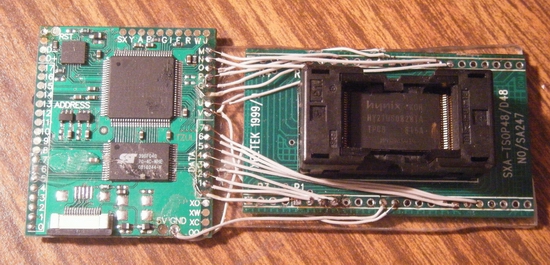

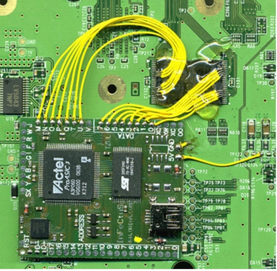

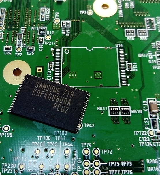

Simply desoldering is like picture #1. Or if you have Infectus 2, it's like picture #2.
The rest will depend on whether you have your NAND memory backup, your keys for it, any other (even diy) programmer for this type of memory (picture #3), a second "donor" Wii, etc. and so on.
Edit: This raises the question of economic feasibility. Infectus 2 is a hell of a lot harder to buy. Programmers cost money too. You will need equipment for soldering.
