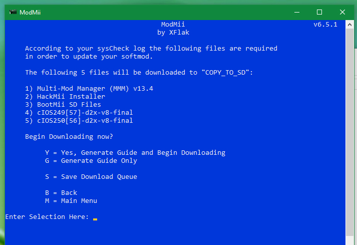

According to your sysCheck you can update/change your
- cIOS 249
- cIOS 250
That maybe helps on USB issues.But I am not sure it fixes your Gamecube problem.:unsure:

I managed to download the vanilla MIOS file from ModMii and install it using YAWM which gave me back my retail discs. I've also installed the latest Wiiflow and Nintendont now to restore my Gamecube USB loading.
Thanks for the tip about the cIOS versions. Is there any way I can upgrade my actual firmware version? At the moment I have to use Wiiflow to launch one of my Wii discs to skip the firmware check.

Well ermm truth is that I've now tried to install the recommended USB loader updates you gave and now Wii USB loading is borked...
I've updated Priiloader and installed a couple of the hacks to help me out as well.
