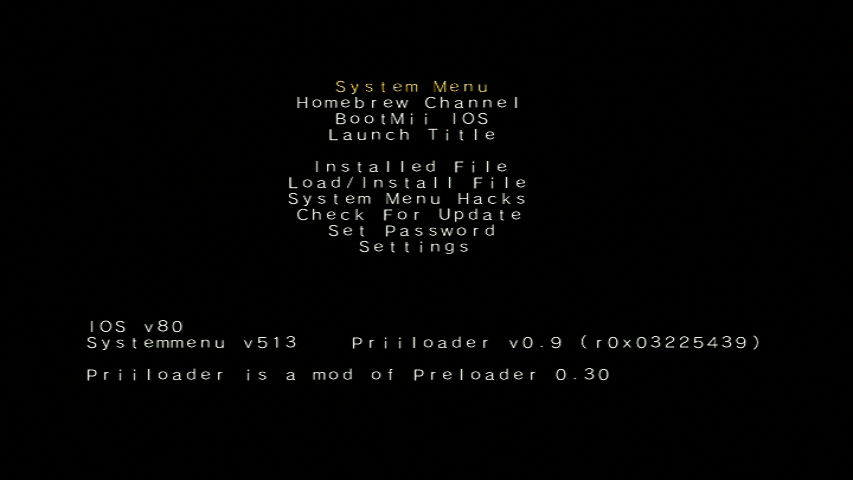

Hi. I'm trying to play a mod for Fortune Street that lets you play online with Wiimmfi, but I need a NAND. I own 2 Wiis, one RVL 101, one 001. I'm asking if it's possible to get the NAND without a Wiimote, as all of mine have broken. The 101 is unmodded, so that probably wont help, but the 001 is modded. It's a black color Wii, and so it has boot2v4 so i was unable to set boot2 to bootMii.
Is there a way to connect my Wii to my PC to dump the Nand? (Sidenote, the SDcard that had most mods on it has been wiped a few months ago so i only have access to a few things, but if i need to i can set it back up.)
Priiloader yes, gc no
You should have the option to run bootmii ios via priiloader, which iirc you can navigate with the front buttons:
Sorry, I misremembered, I thought Priiloader was like Bootmii in terms of navigation.
Pretty recent features Priiloader features, both support for USB keyboard and console buttons.
No Wii Remote, no GC controller… Can't be that hard to get any one of those.
