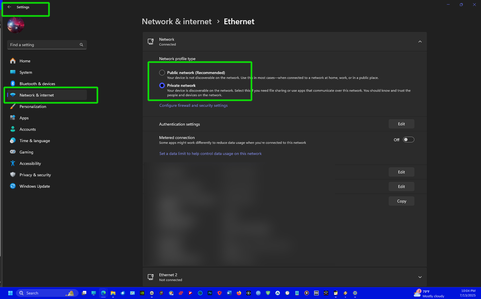

Hey there chief, go to your PC (Mac?) and make sure that your internet connection is set to "Private Network", and not "Public Network". If it's set to Public Network your Vita will not be recognized by your PC and VISE VERSA. So that's SETTINGS >> Network & Internet >> Ethernet and MAKE SURE YOU ARE CONNECTED TO PRIVATE NETWORK.
Hope this helps!!!

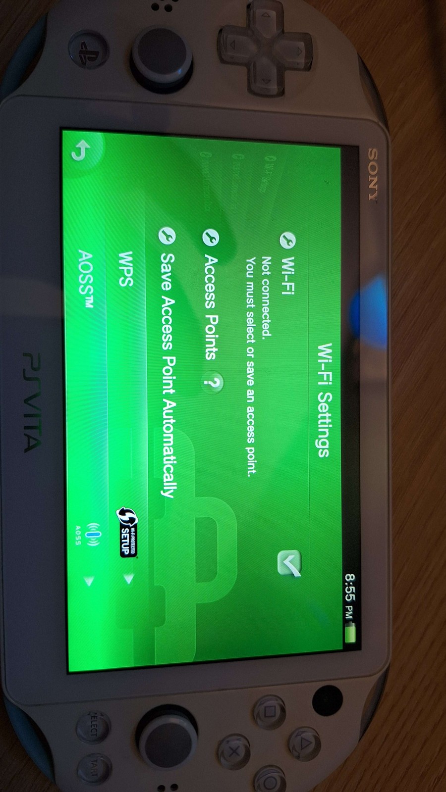

i did,i've tried pretty much everything i can think of. from what i could find while researching and talking to sony support,it looks like the wireless chip might've been defective and the new update "triggered" the defect. it can't connect without a mac address and it was gone after it updated.

i did,i've tried pretty much everything i can think of. from what i could find while researching and talking to sony support,it looks like the wireless chip might've been defective and the new update "triggered" the defect. it can't connect without a mac address and it was gone after it updated.View attachment 517010
Damn dude that really blows. Sorry to hear that. :(
