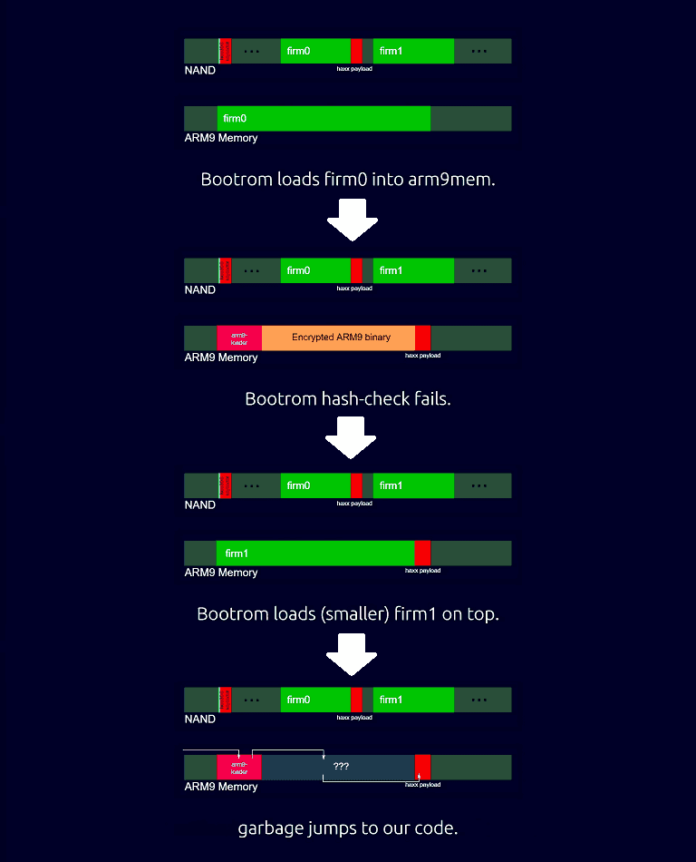

So above in the CFW Explanation you have more details about Luma. It is not really wrong but also not really true. Luma3DS is basically just a signature Patcher that Patches the Original Firmware. It is not a Firmware replacement at all.
1. Bootrom reads FIRM0, but due to our payload presence, the signature check will fail.
2. It will read FIRM1 on top of FIRM0, and our payload will still be after it.
3. Check its RSA signature, since it's good it will jump to its arm9loader.
4. The arm9loader will use our crafted key to decrypt the ARM9 binary as garbage, then jump to the kernel entrypoint.
5. With our key the garbage kernel entrypoint will make the cpu jump to our payload location.
6. Code execution!
1. Ensure the firm0 and firm1 partitions are arranged such that the size of firm0 is greater than firm1. Both need well-signed FIRM headers so that bootrom will load them into memory.
2. Put the payload at *(firm0 + (sizeof firm0 - sizeof firm1)).
3. Find a key that, when decrypting the firm1 arm9bin, causes a jump to the payload in the size difference between firm0 and firm1.
4. Encrypt the key and place it at the second key of the secret sector (sector 0x96, offset 0x12c00).
5. Write the firm0 and firm1 to NAND.
6. Boot.
7. Bootrom9 loads up firm0 and find the SHA-256 hash mismatching because of the payload at the end of firm0.
8. Bootrom9 loads up firm1 on top of firm0, decrypts it and jumps to it.
9. arm9loader decrypts the arm9bin with the preinstalled key and jumps to it.
10. The first instruction in the arm9bin jumps to the payload.
So for short Neither ARM9LOADERHAX is a CFW it is a persistant (low-level) system exploit, nor Luma3DS is a FW Replacement, it is a Signature Patcher.
