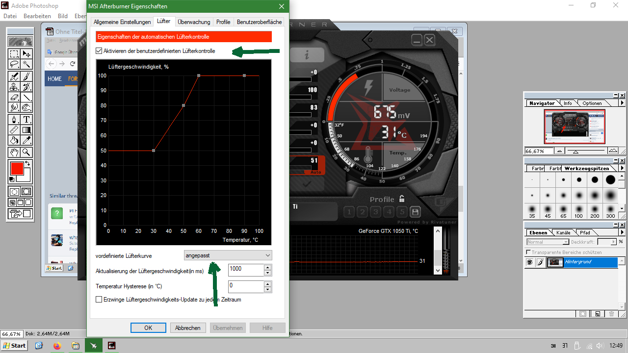

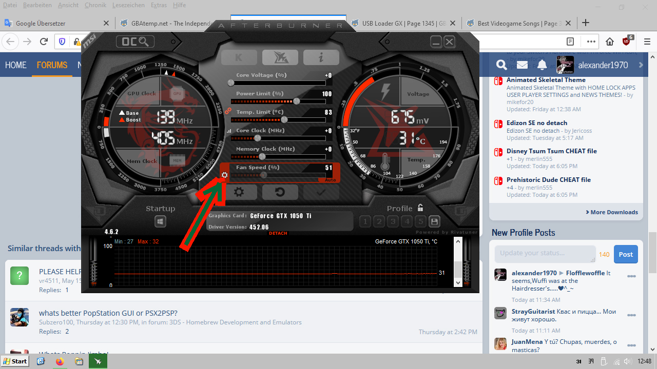

A little Addition to the MSI Afterburner - the Fan Speed is set to Automatic on default.
It has the be enabled in the
FAN Settings (green Arrows !)
and set to Custom.
And on the Main UI also (it is still set to Automatic on Default.)
Then you can change it to your own Setting.:)
Good Luck.
and set to Custom.
Good Luck.
Thank you.:)
Yes that's what I did haha, by default it's on auto yes. I clicked on the auto button and then I could slide the slider, but it wouldn't change the fan speed. I can do it now though, so I'm wondering what has changed.
