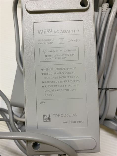

Hello, bought from Japan, a japanese Wii u premium, don't have it now at hands yet.
But when researching I found that ac is 100-240V, but some say it only 100V, will they work with 220V outlets or I need buy transformer? Not familiar with such tech questions
Japan is a wierd territory, in so far as its mains power can be one or the other depending on what area you live.

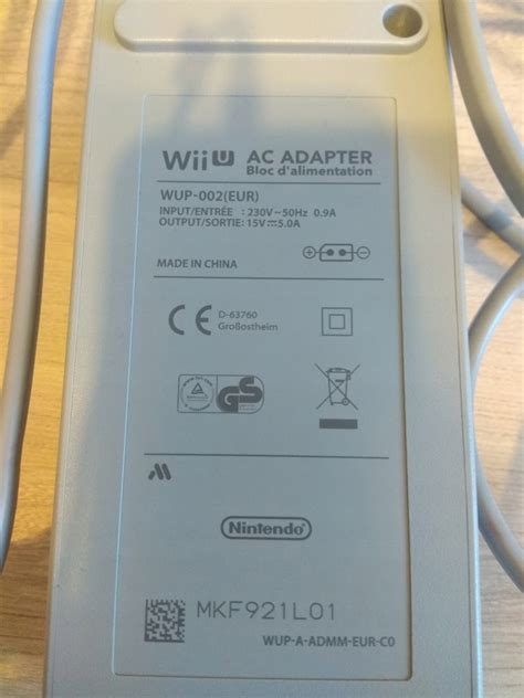

In your particular case; firstly I'd wait to see what voltage info is printed on the psu - if you can't use it on your local mains supply the next option would be to buy a Wii U psu for your region (the input voltage to the console from the psu will be the same).
The output from the power supply for each region is the same - 15V 5A.
So use the power supply for the your local region - WUP-002 (EUR) - and it will work with your imported console.
This is a better solution than using a transformer.

That's doubtful. 240v AC will blow a 100v AC PSU... dangerously so.
Look at the pics of the two PSU's above; they very specifically state 100v AC input on the Japanese one and 230v AC input on the European one. Neither says "100-220v".
The only thing that's 'region free' (ie, common to all PSU's) is the 15v output to the console.
I have a Japanese Wii U, the power brick specifically states 100V input, but that's wrong. Apparently, hardware inside the brick supports 220V as well, and mine runs just fine without any problem.

On the Japanese charger, the input says 100V, then you need either a step down transformer, or a European charger. Japanese charger work with US region because they fall into the same 100-110V.
