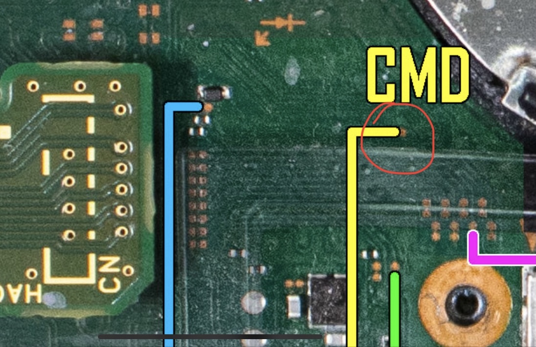

Hi all, I have a defective switch v2 here. The CMD soldering point is completely torn off and the switch no longer boots up. Can anyone tell me if there is an alternative point? I was thinking of making a bridge between the 4.7k resistor and an alternative point.
I have seen this kind of issue at OLED‘s and a posting where sb says it goes directly to the APU. Is it same here?
Thank you very much!

Can you grind it a little? Maybe you can reconect the missing pad
That point goes it to the board and then to the SoC

Hi, I was able to solve the issue with a little grinding and UV paste :)
Now it works!
