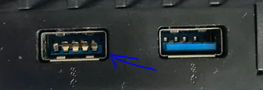

One Thing to clarify first USB Port 0 Is Broken The USB White thingy popped off with a USB so my only choice is the 1 Port
What "popped off" exactly? Are you using a sd to usb adaptor or usb flash drive? As there's nothing to pop off & the port is pretty sturdy (unless the pins are bent inside..etc.)

It Was Just Like This

If you can't use port0, you need to use d2x beta53, which has support for both ports (keep everything else the same, just reinstall 249-251 with same base IOS as before but using beta53)
Not true, IOS58 is for USB 2.0 support natively (which cIOS already support) it has nothing to do with both ports, you need d2x beta53 for that.
The V10 Beta35 d2x-v10-beta53-alt?
