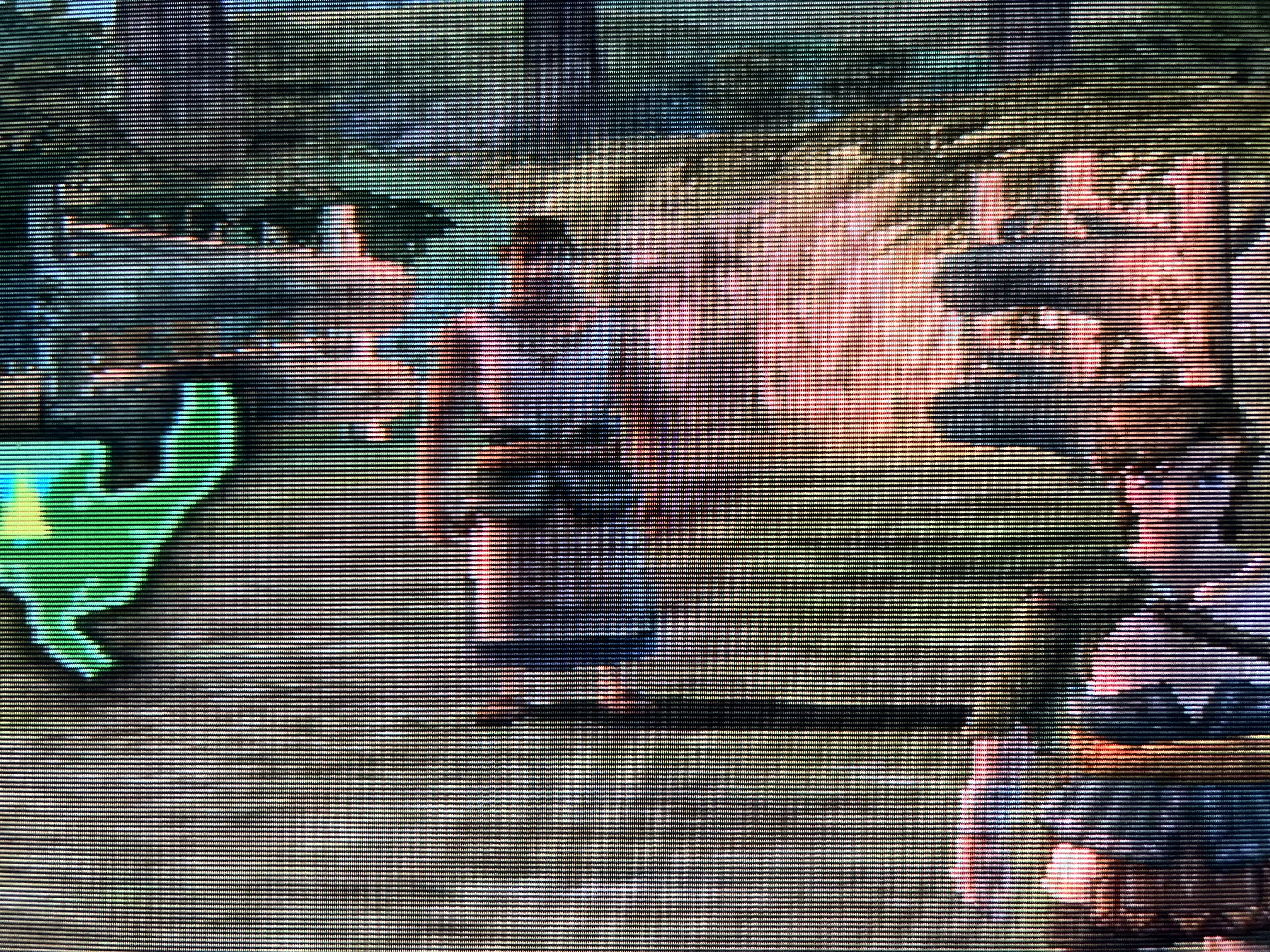

there’s been rumours that the original revisions of Wii are sharper when applying 480p patch than the later “already fixed” revisions. Here’s a comparison between Rev-01 and Rev-50 model. Same settings (deflicker, 480p patch, 4:3 aspect ratio). Pics taken directly of a BVM D24 using OEM component cables.
Reactions: Amuro-san
