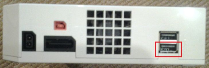

And please check your USB device is plugged in the CORRECT USB Port:

and yes, i already knew that it had to be in the right port so that is plugged into the right one
