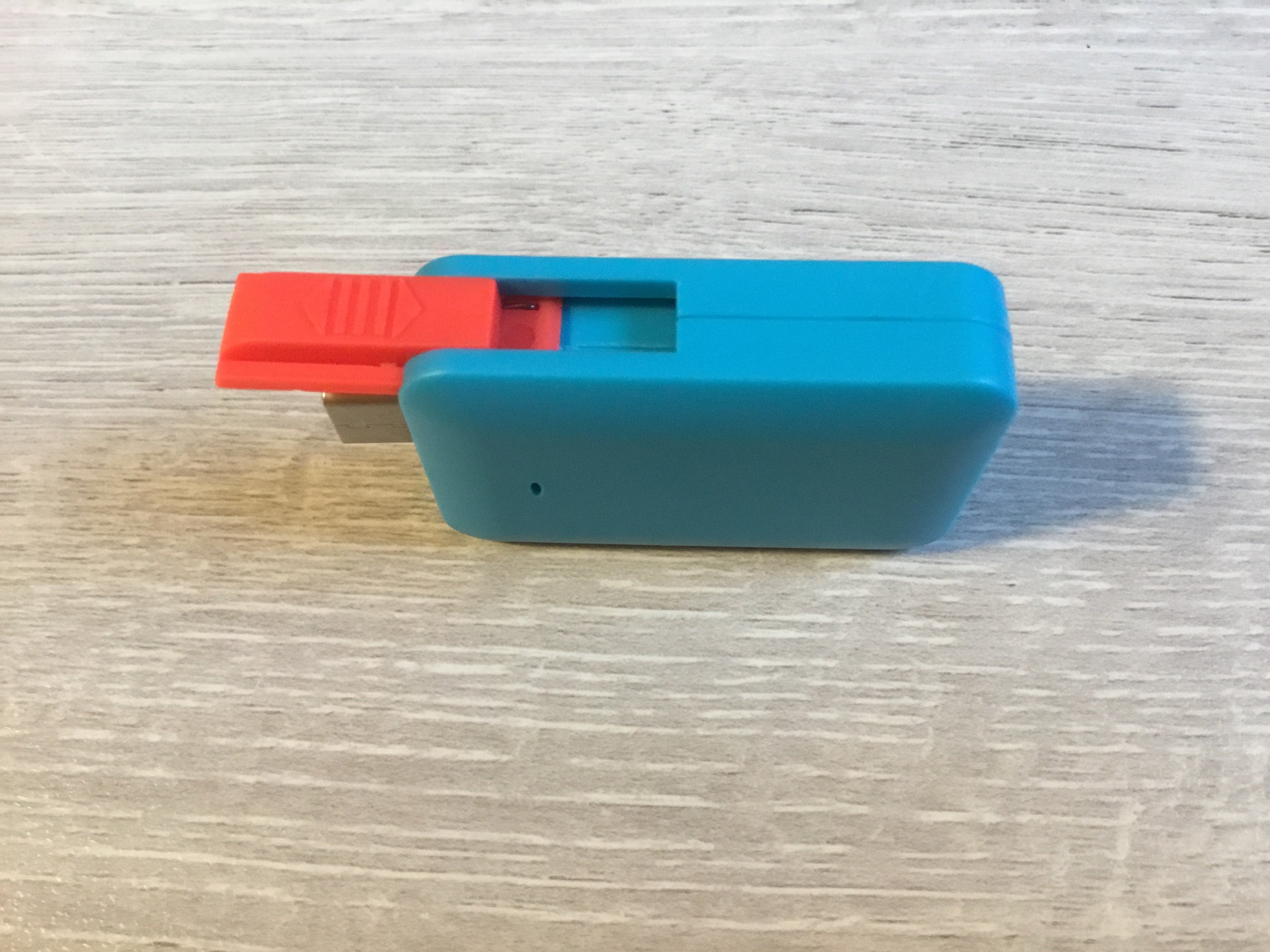

Hey, guys. I came to the rcm loader from aliexpress. I ordered others, but the seller slipped me this one. The default bootloader to run ReiNx. Connection to the computer is absent as a class, but there is a connector for the micro SD memory card - apparently it is possible to download payload. But how to do it-it is not clear, no information about this function I found. Can someone faced with this “miracle”of Chinese industry. I will be grateful for any help

Ok. Let's wait for the ready solution. I do not want to open it yet. There is a Chinese version). No information about the loader. There is no information at all)

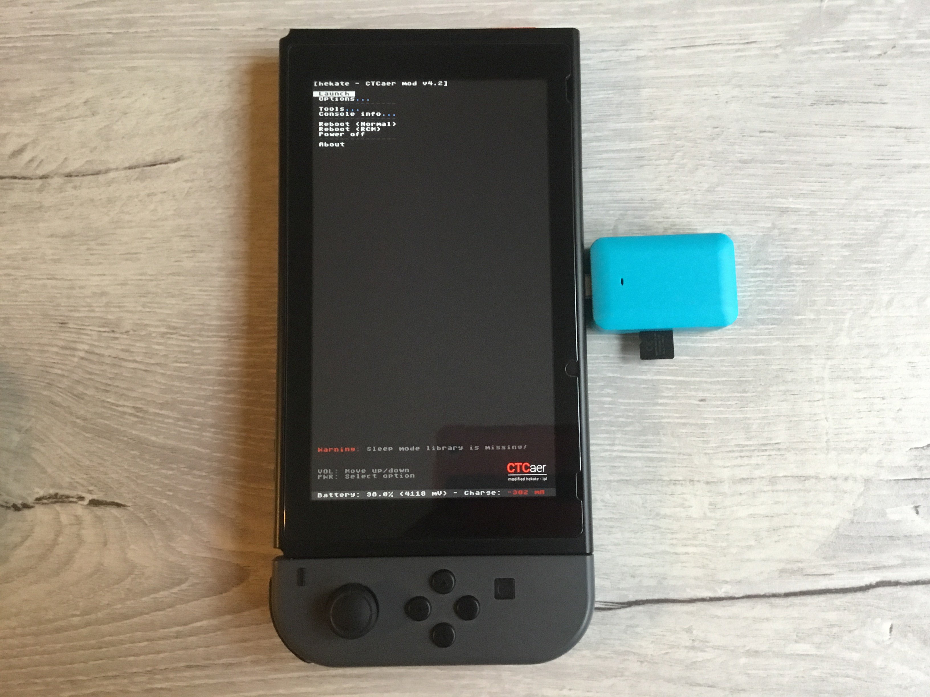

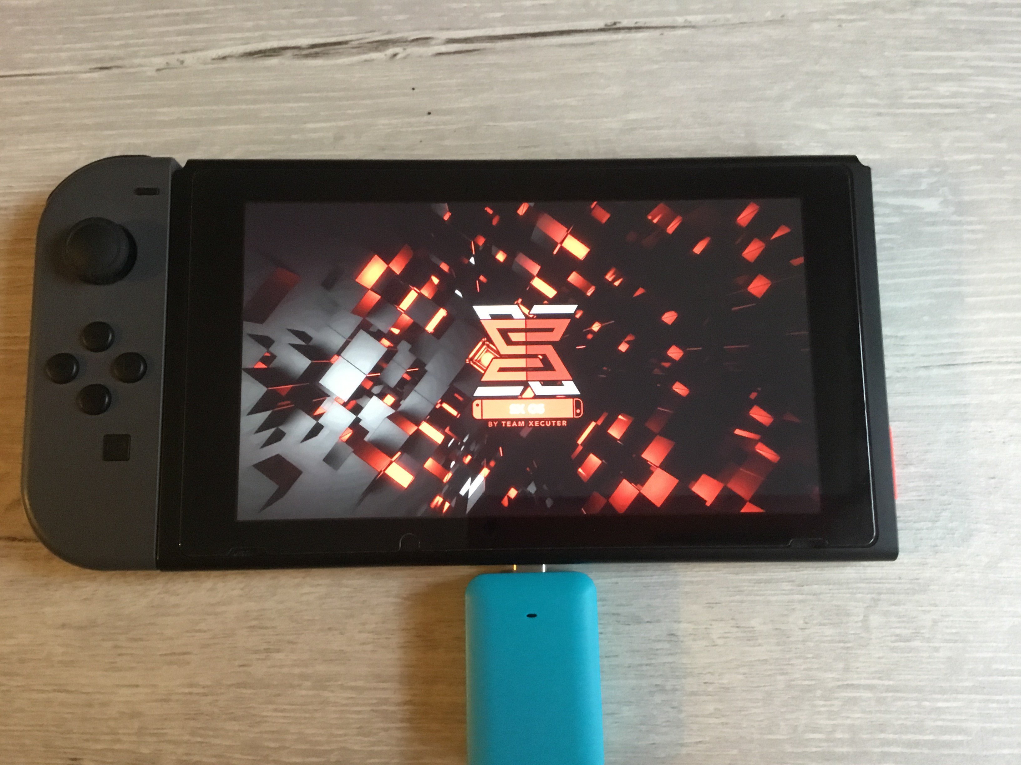

oh wow talk about luck, i had the same dongle as the OP and have spent a few days looking for how to update the dongle w/ a new payload. Back and forth conversation with the seller and they ended up giving me a refund. And I didn't realize that it has a sd card slot until I read this post!
Turns out updating the dongle is very simple!
1. download the payload of your choice and rename the payload to "payload.bin"
2. copy "payload.bin" to the root of the sd card
3. put the sd card in the dongle
4. enter rcm mode
5. plug in dongle, you'll notice that the red light flashes much longer
6. once you have booted you can take out the sd card, the dongle is now updated w/ your new payload and no longer require to be present in the dongle.
Since it comes default with ReiNX, I put Hekate 4.2 in and verified that it does boot hekate. Removed the sd card from the dongle and it still boot with Hekate this confirms that the dongle is updated.
Now if you put the sd card into your pc, you'll notice that "payload.bin" is removed from the sd card.
Hope this helps!

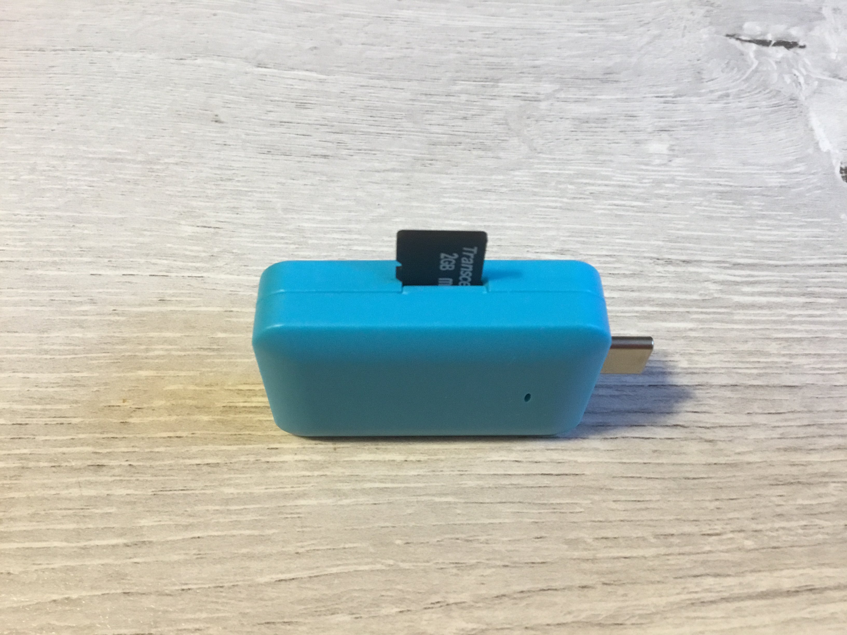

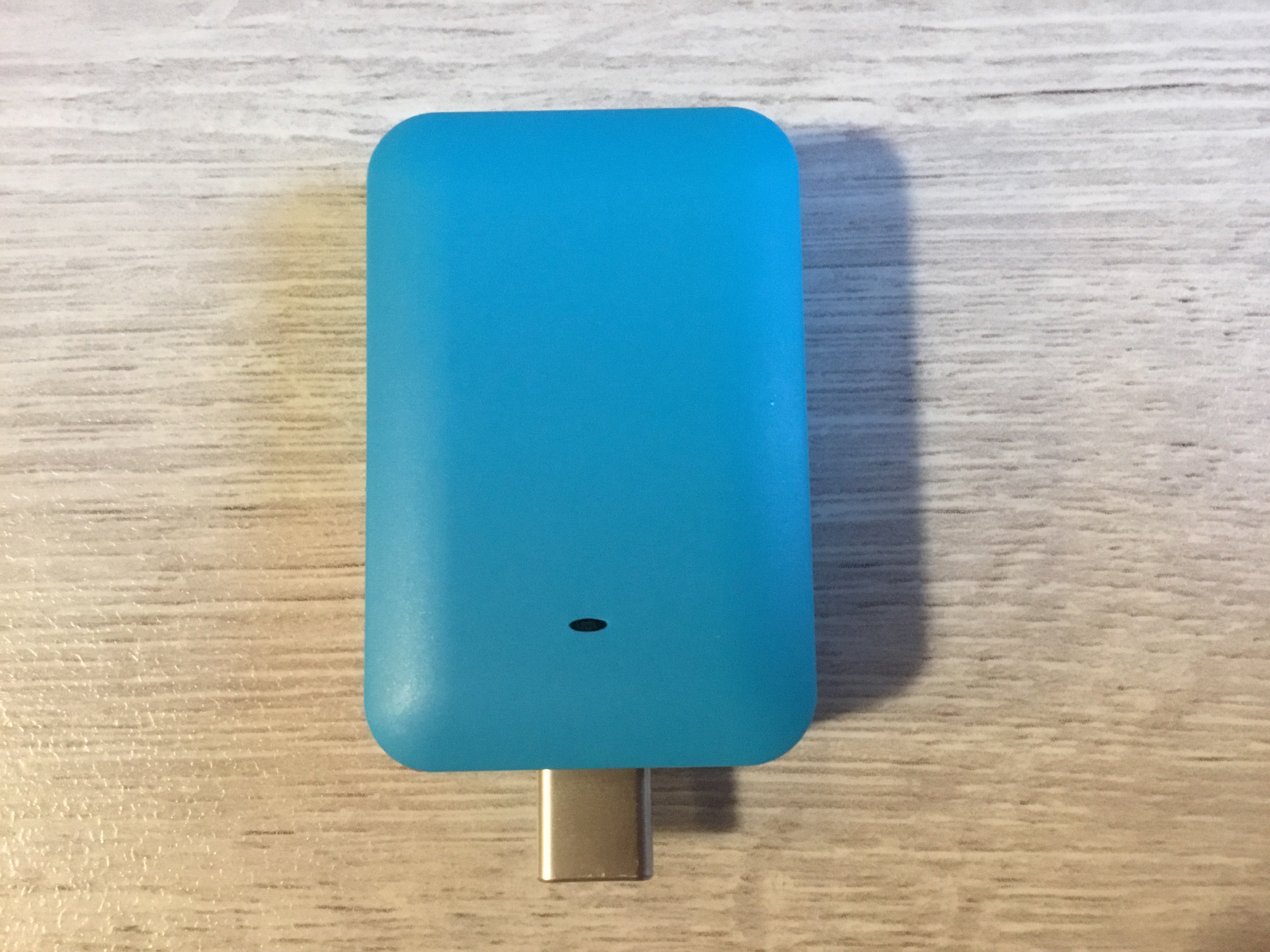

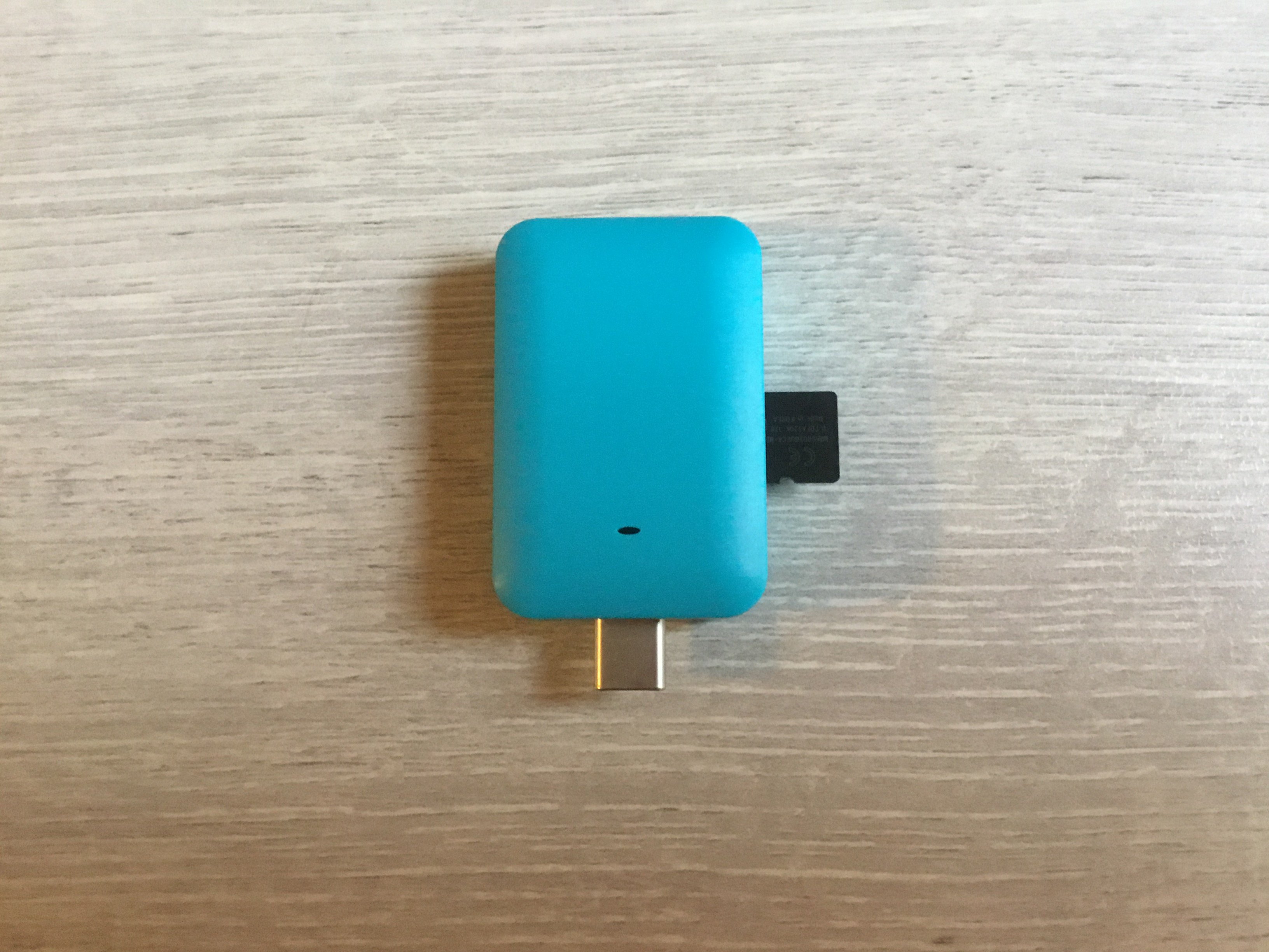

Yes, everything is perfectly updated in this way. Anhlon - thanks for the decision. This dongle and runs on a special-first you have to hold down the button, and then insert it. Some people in the reviews on aliexpress wrote that it is not working, as inserted it first, and then clamped the combination of buttons to enter rcm mode. For SX Pro and R4S dongles is absolutely not important the order of connection to the console.
P.S - the third photo shows how to insert a memory card - it was also not obvious at first.
CC11D531-BD2A-4AA9-9CDB-D3CEF982DB7A.jpeg FC018919-5BFE-4975-8869-B2F812355341.jpeg 2309CD99-E47A-4A03-BFA2-83AE62BAD949.jpeg
