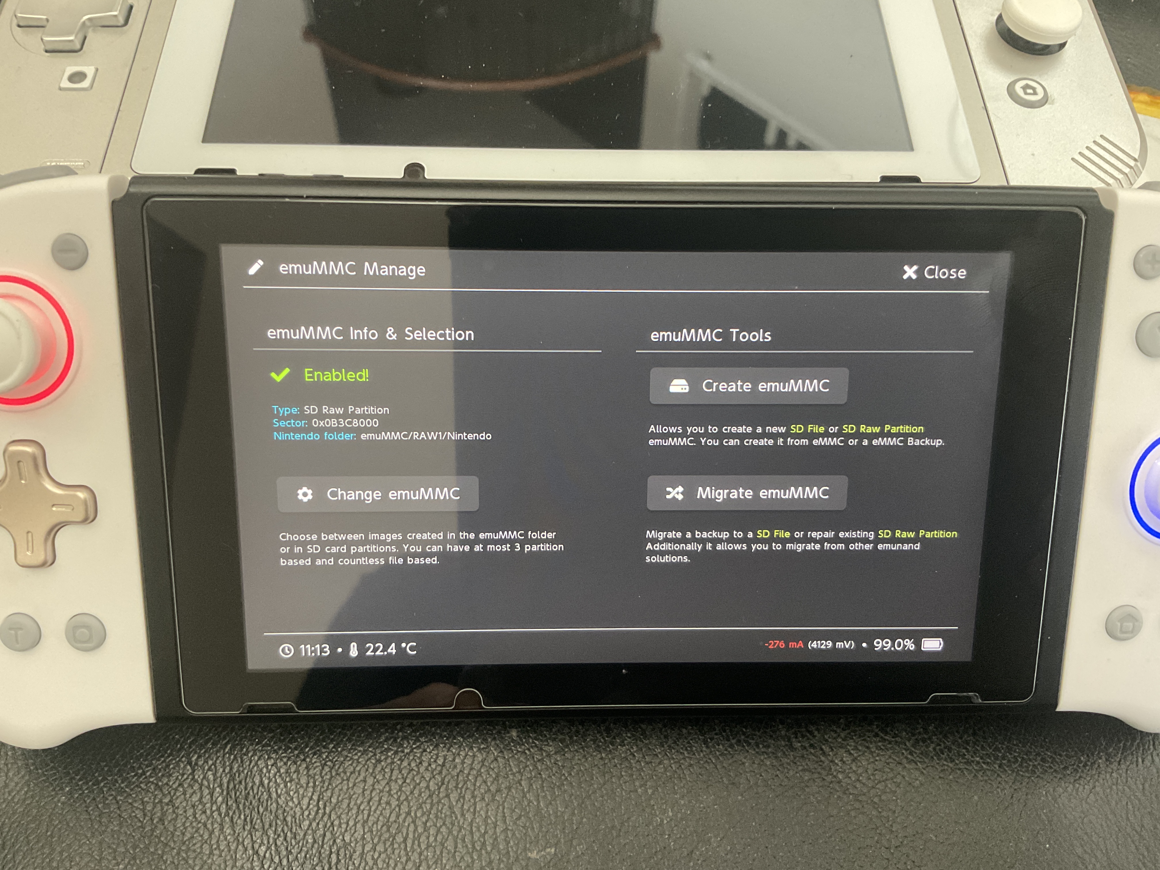

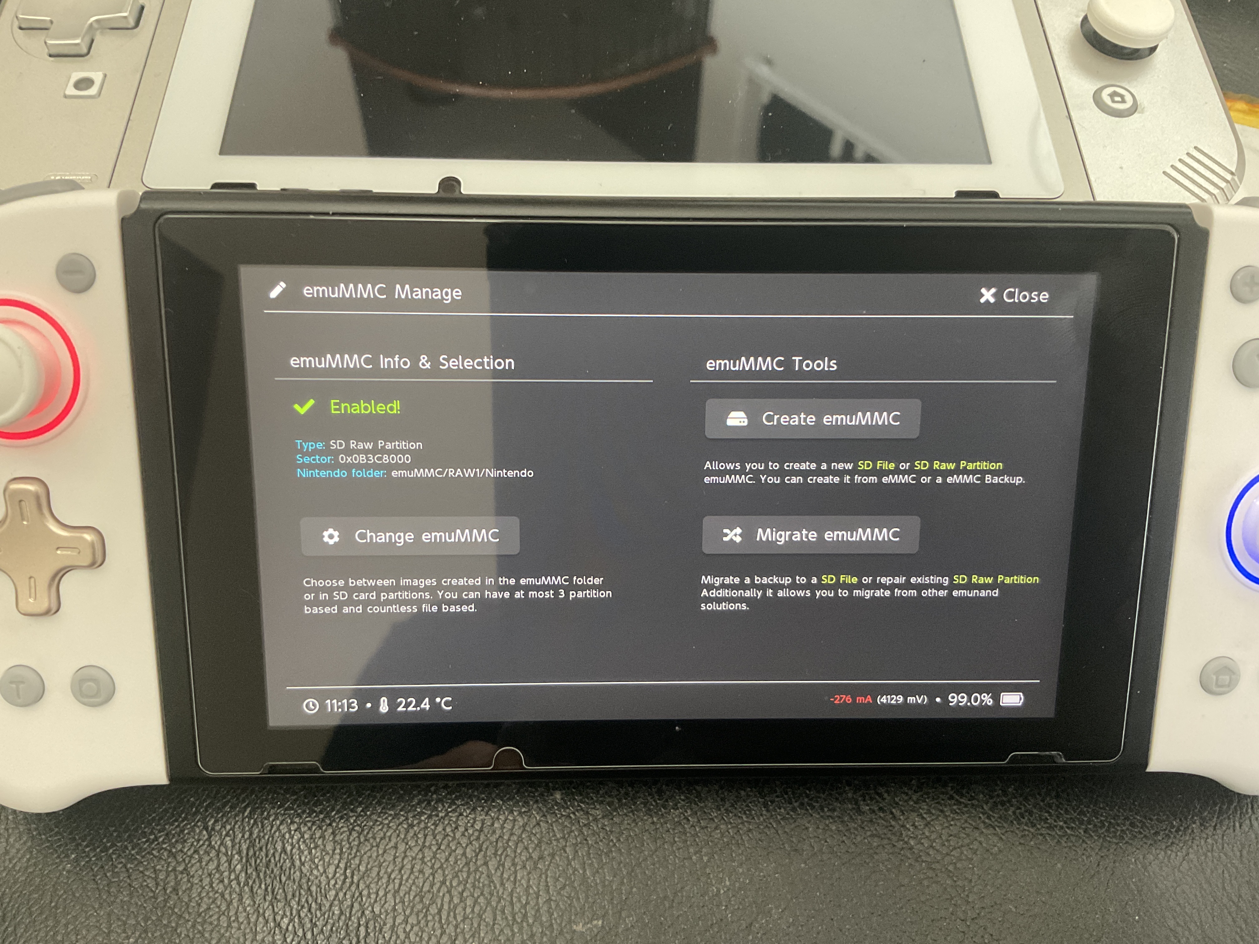

Using your old sd card, please go to Hekate and click the emuMMC tile all the way to the right and take a screenshot of what you see.
Mine looks like this:
If yours says Type: SD Raw Partition like mine, it means we need to copy that over as well. Here’s how you can do that. https://rentry.org/EmuNANDNewSDcard (I prefer the Hekate method because it’s all done via the Switch.)
If on the other hand it says it’s Files based we’ll need to pause and rethink…
