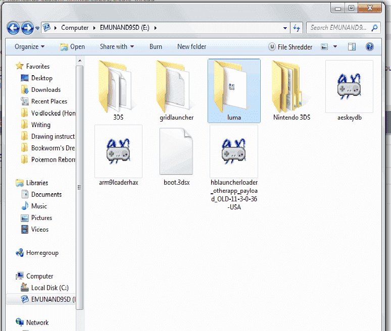

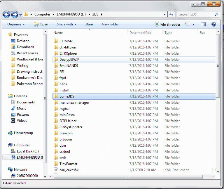

So back when 11.3 came out I updated without thinking about it, and now it only shows black screens. I had given it up as lost when it happened, but I have heard that it can be fixed. i tried looking for guides but I couldnt get any to work. I'm including screencaps of the files on the sd card I use for it. Luma is v5.5, I couldn't get it to update to the current version when trying to follow other guides. I used menuhax, decrypt9, hourglass9 was involved, And I have backups of the emunand and sysnand I made when first hacking it back in june of 2016. I haven't updated any of the programs used in hacking it. Any help that you would be appreciated. Thank you.

Follow these steps and report back:
  1. Download this version of Luma3DS.
  2. Put arm9loaderhax.bin from v7.0.5 of Luma3DS onto the root of your SD card, replacing the one already there.
  3. Boot the 3DS while holding the Select button.
What happens?

If after updating Luma, you still don't get anything when holding Start, make sure you have some bin files in sd:/luma/payloads/. The menu won't show unless there's two or more payloads available.
If you don't have any, extract the bin files from these tools:
https://github.com/d0k3/SafeB9SInst...d/v0.0.7/SafeB9SInstaller-20170605-122940.zip
https://github.com/d0k3/Decrypt9WIP/releases/download/20170607/Decrypt9WIP-20170607-104551.zip
If you get the menu, then follow this:
https://3ds.guide/a9lh-to-b9s
And since you probably had games on your emunand, you can restore it on top of your sysnand. There's a call out for that in the guide.
