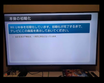

Hello i have this error code 160-1710 and i can boot with UDPIH and set cold boot title but after reboot same error code anyone know how to fix? My console is MLC
Hi there, would anyone be able to provide links to the raspberry pi pico or zero for purchase? also, is there a preference between the two for wii u purposes?
If it's Raspberry Pi Pico you're looking for, I've personally purchased one linked here (one from AliExpress, in fact) for setting up my GameCube's Picoboot. It's one of the ways to support the Picoboot developer and it's pretty cheap as well (provided shipping costs aren't ridiculously high for you for one reason or another).
That's neither the error code for eMMC corruption, nor is it the CBHC error code (so changing the CB title won't help)
Maybe it is SLC corruption, I don't know the error code for that from the top of my head. Please dump and upload the logs.
From the logs we can probably see what's wrong.
