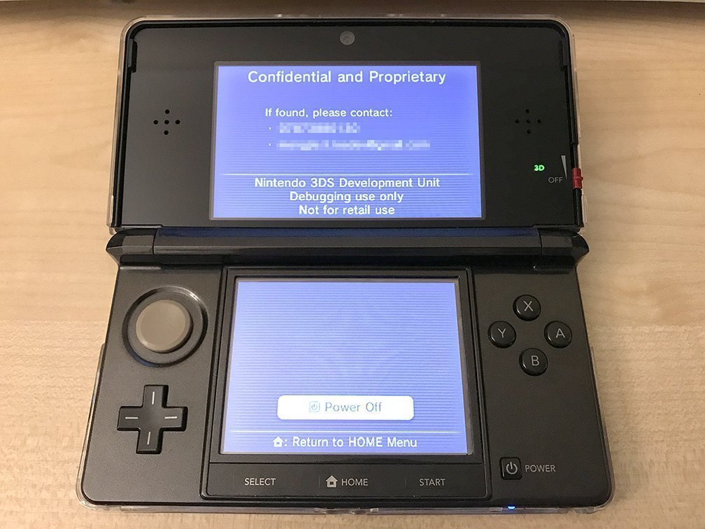

That’s awesome! I don’t have a dev unit, but I might make mine say something similar just in case. I had a 3DS stolen from me once before... Something like this would make it worthless to pawn off.
