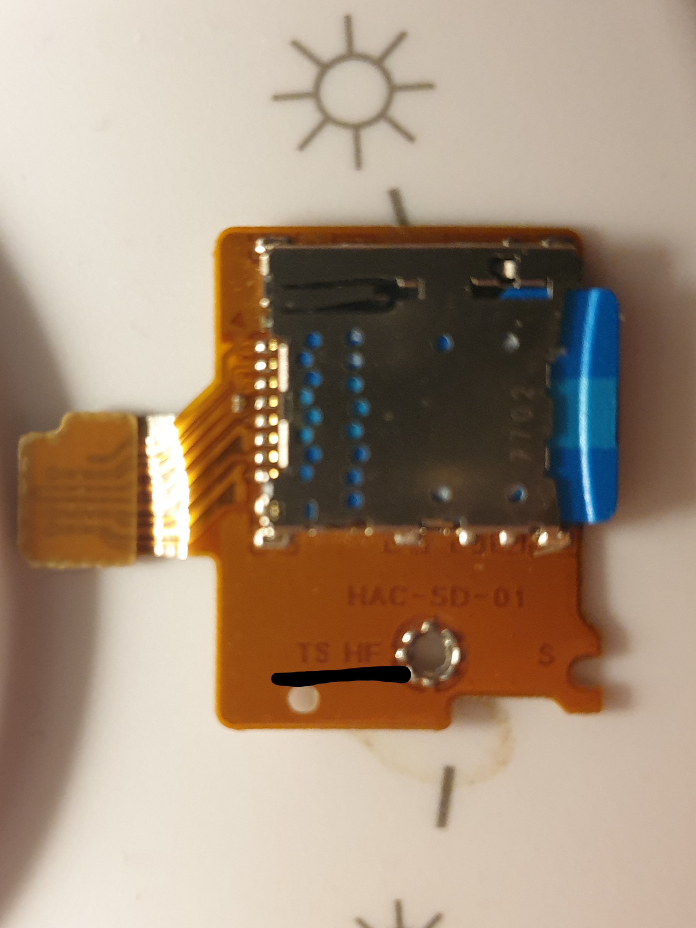

Hey, regarding the TS HF model of the switch micro sd card reader, for the life of me I cannot find a TS HF model anywhere (aliexpress,ebay etc) Only CA HF which doesn't seem to boot in atmosphere or any other CFW that doesn't support 1 bit bus width. Would anyone be able to give some advice on where I may be able to locate one or an alternative?
There is no fault with the micro SD card itself, verified tests, just the reader itself is faulty from heavy usage.
(Apologies for the blur, there is an issue with my phone)
Thanks :) , no idea why they didn't show in my search results, even now, luckily they ship to the UK when all others were US only on ebay
I picked AliExpress because I assumed you were USA Google searches gave me UK Amazon links
