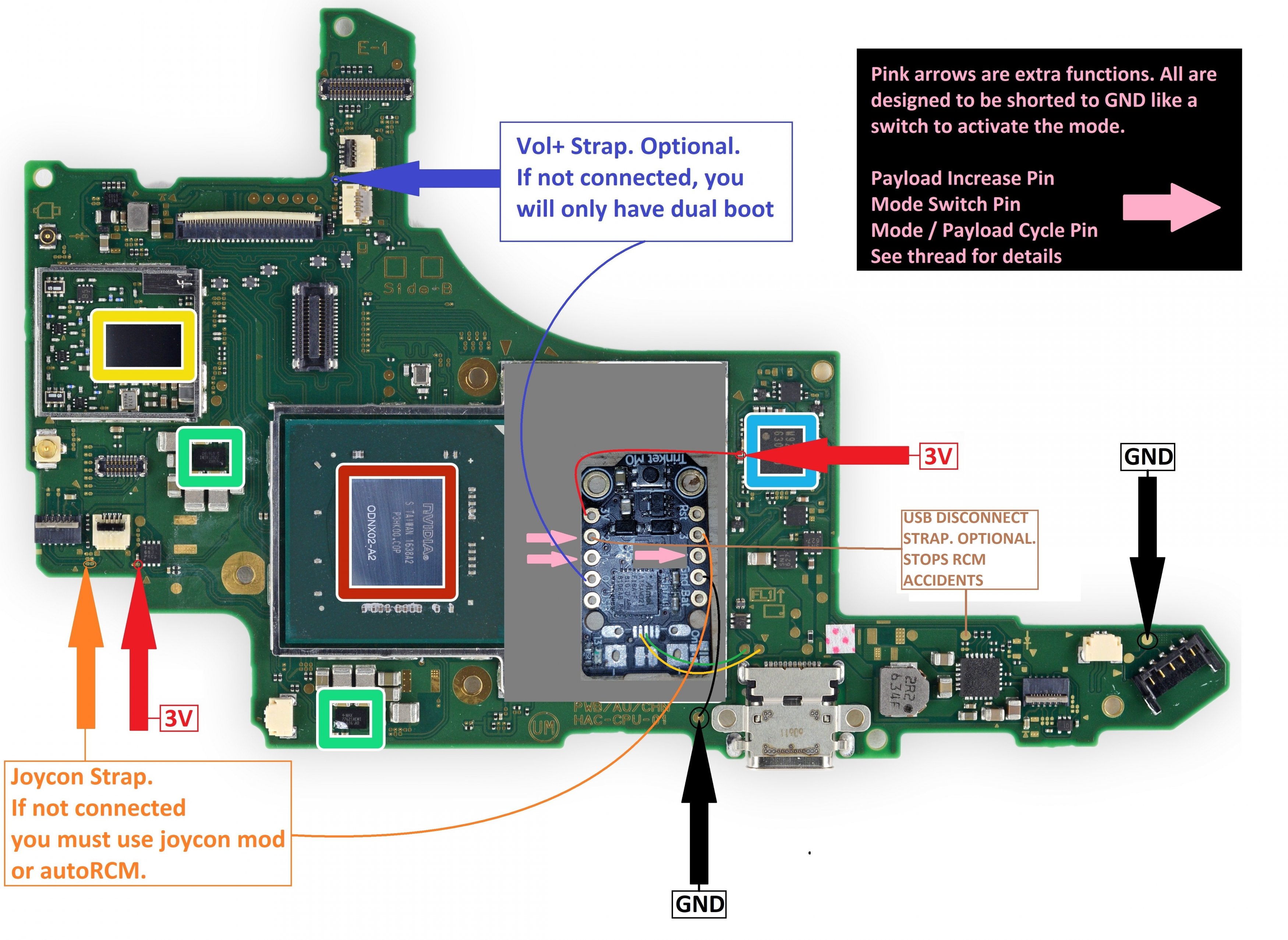

1 - i have to copy hekate.bin in the chip memory via usb, and atmosphere files in the sd card, right?
2 - the image attached is correct for trinket m0 and console WITHOUT autorcm enabled, right?
don't apologize, actually it's me who should thank! maybe i've been quite inaccurate in asking my questions.
i try to make more simply and clear questions:
Nono, the chip needs uf2 files.
Then I recommend you use Kosmos on the SD Card. (https://github.com/AtlasNX/Kosmos) you need both Kosmos package and the signature patches from the Release Page. Kosmos use Atmosphere as default but it's a friendly package with a lot of tools and everything done for you.
No modchip require AutoRCM since they do the button presses self :)
