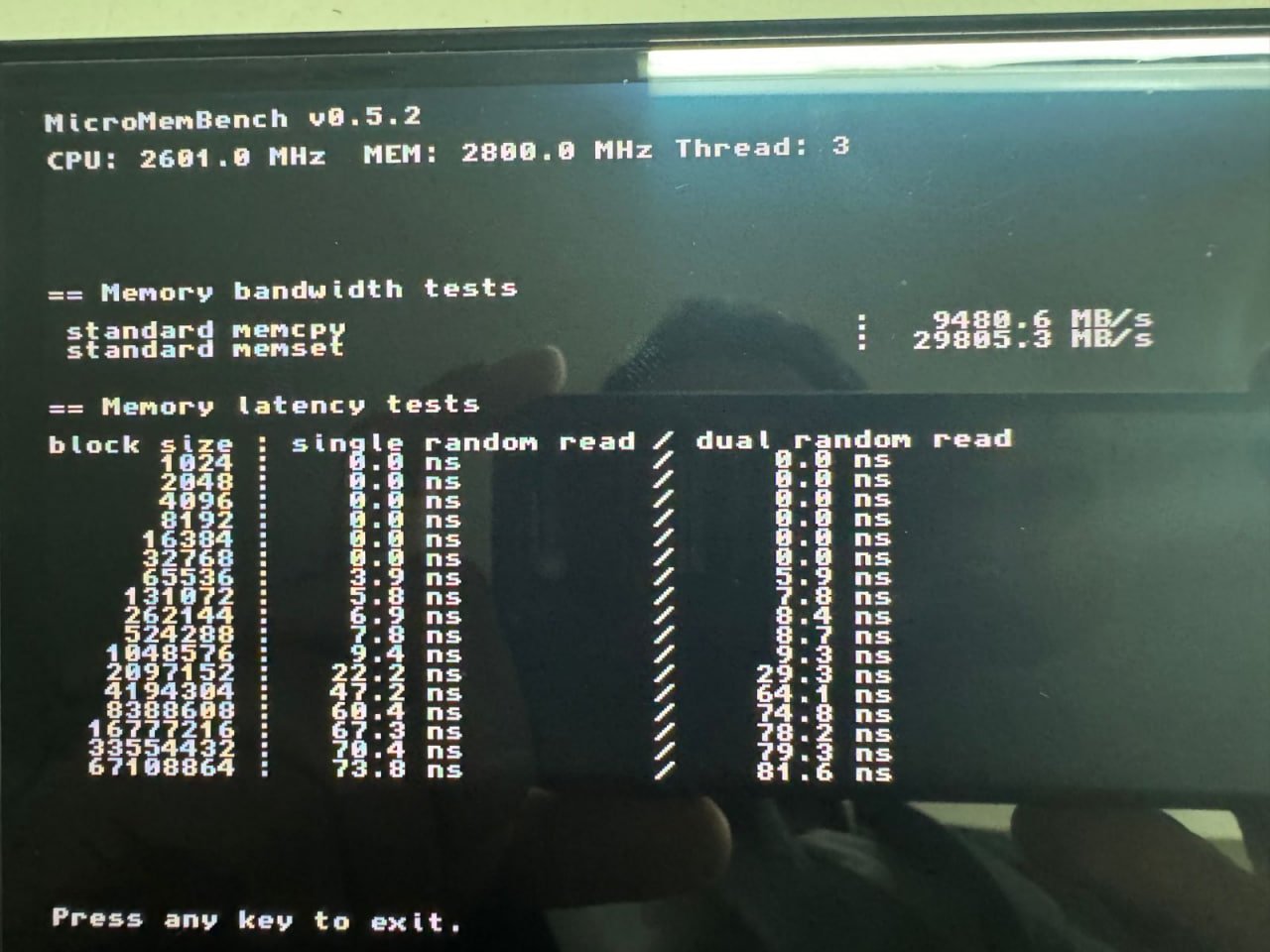

Install 4IFIR and the version of zelda totk needs to be a especific one, i am running zelda botw and Totk at 64fps stable at 2800Mhz memory! temperature at 50 max
Nintendo Switch Oled (Mariko) RAM: Samsung AA-MGCL, for Zelda TOTK and BOTW 64FPS stable all the time.
CPU: 1768Mhz
GPU: 1075Mhz
RAM: 2800Mhz
CPU: 1768Mhz
GPU: 1075Mhz
RAM: 2800Mhz
CPU: 1768Mhz
GPU: 1075Mhz
RAM: 2800Mhz
You use any mod or something else? i´m using 4IFIR in the same config but not get 60fps. Any help please.
