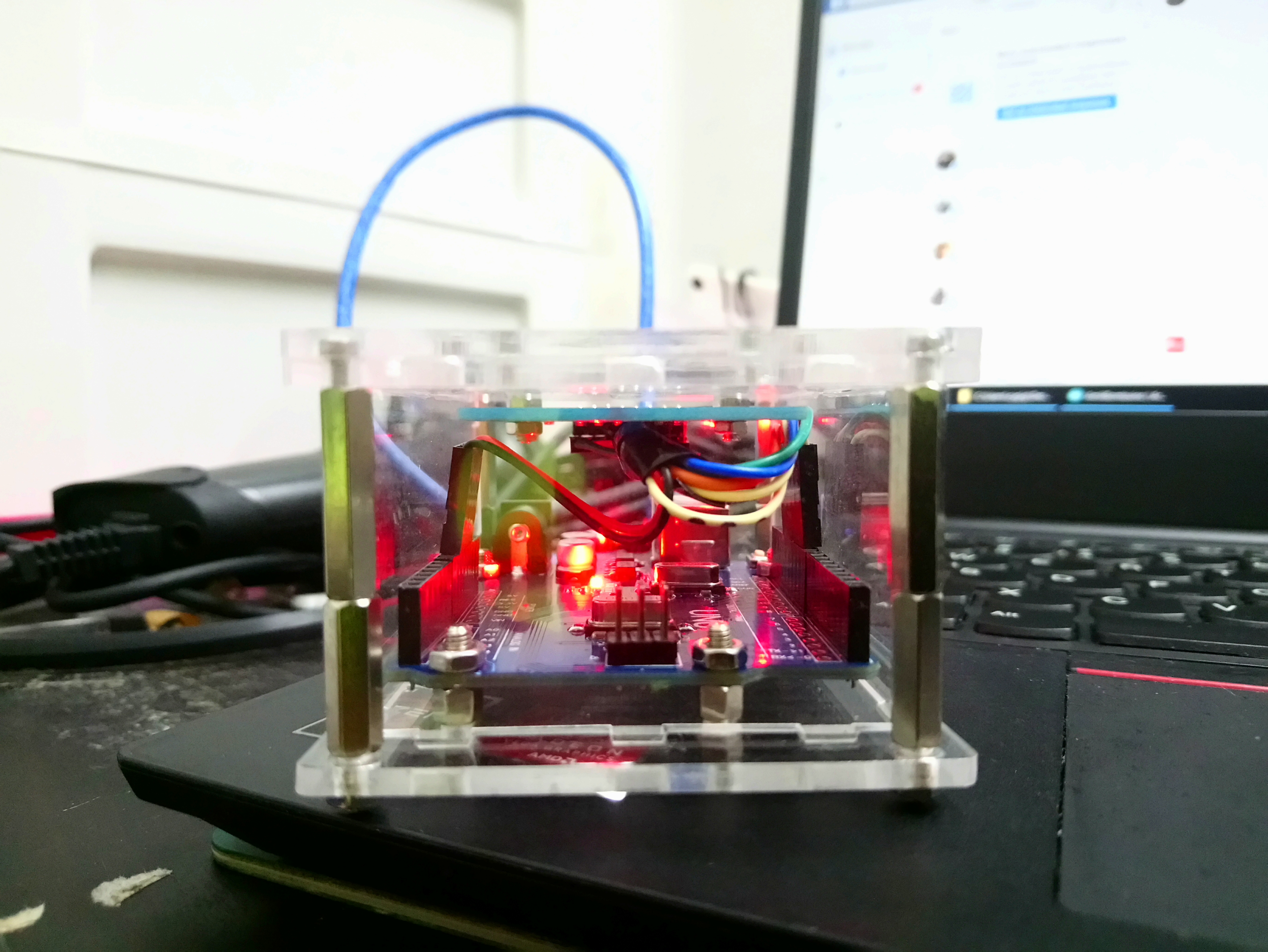

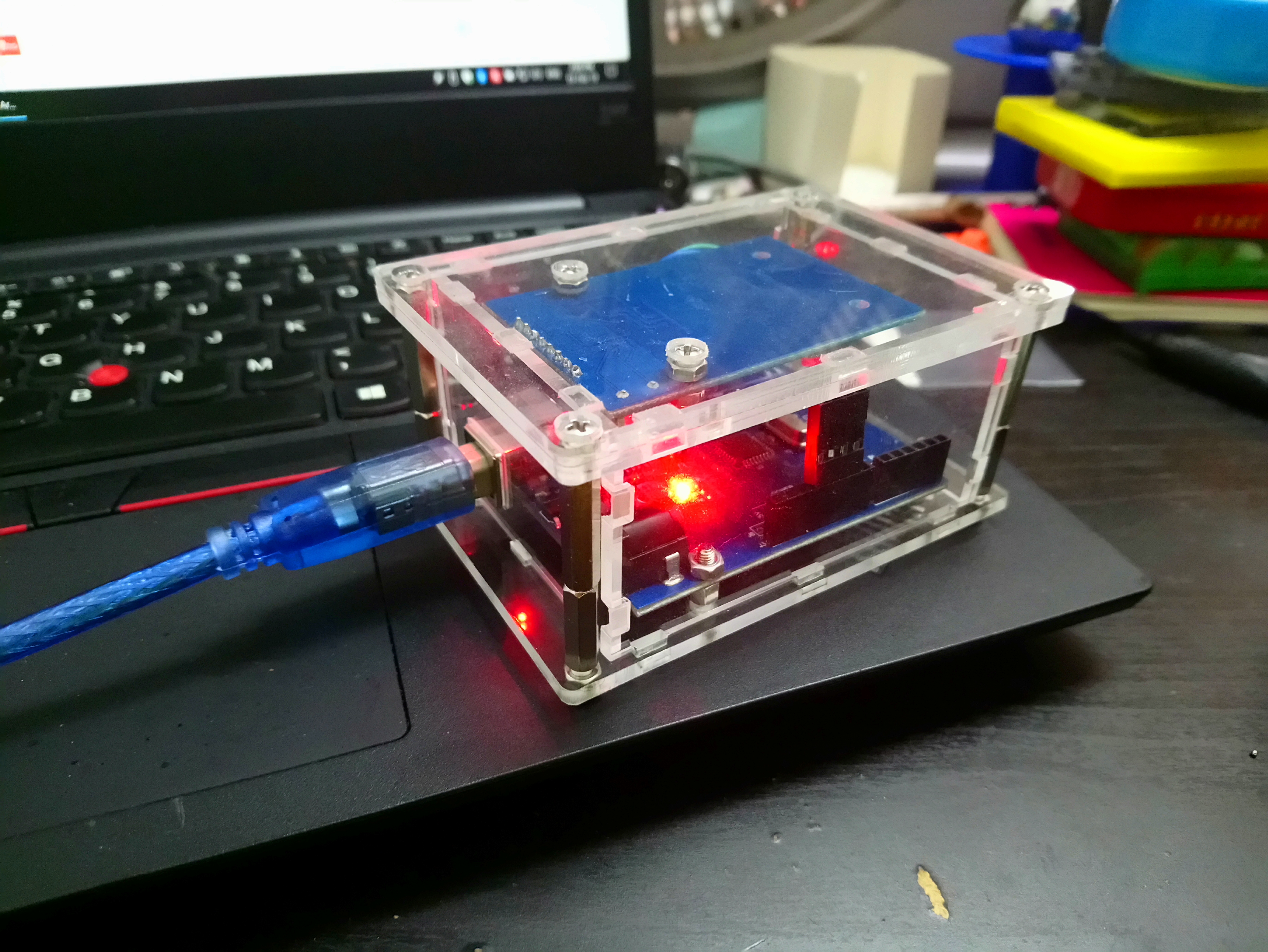

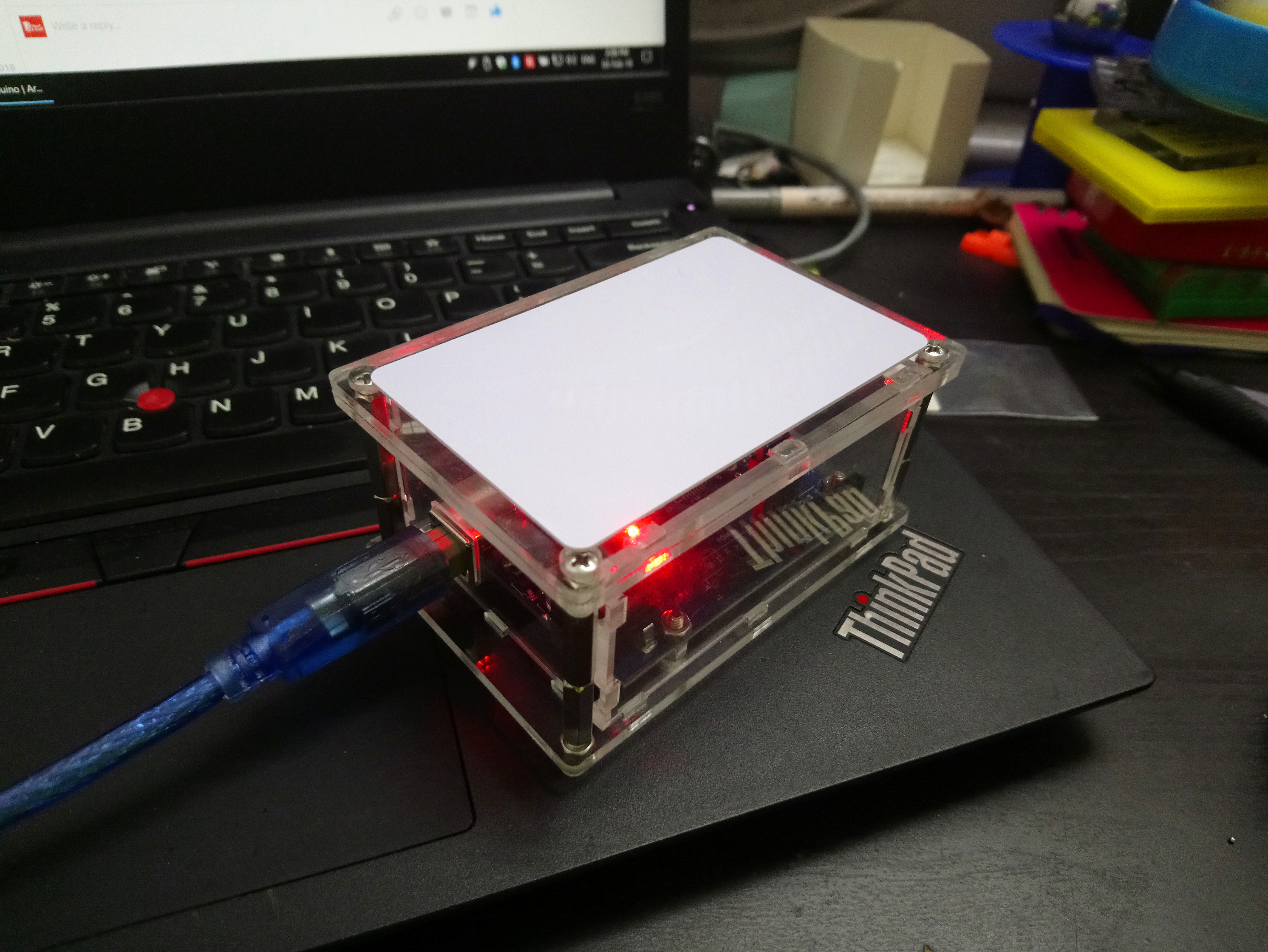

Just discovered this recently. Custom made an acrylic case for the Amiibombuino. I hope this will convinced Ac_K to continue development for Amiibomb.
And..it seems like I cannot post any images as a new member so I shall leave it as an attachment.
Anyway my experience isn't perfect: I can make amiibos, but I cannot dump amiibo from a tag what was already written to. In fact, Amiibomb would not even recognised any tag that was already written (it keeps asking for the NFC tag as if it is not there), with the exception of blank tags. Strange....

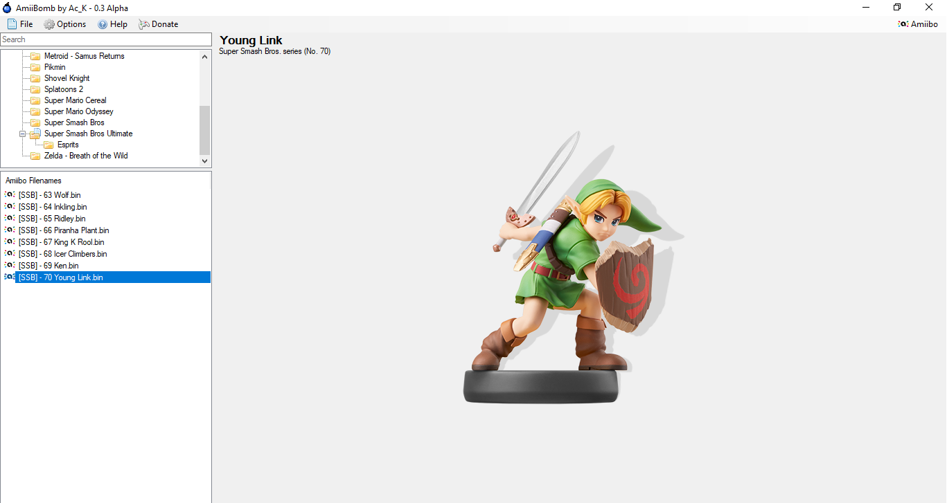

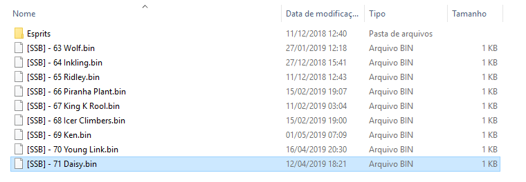

I have a problem with the new Amiibos files. Saved to folder and does not appear in Amiibomb.
Can someone help me?

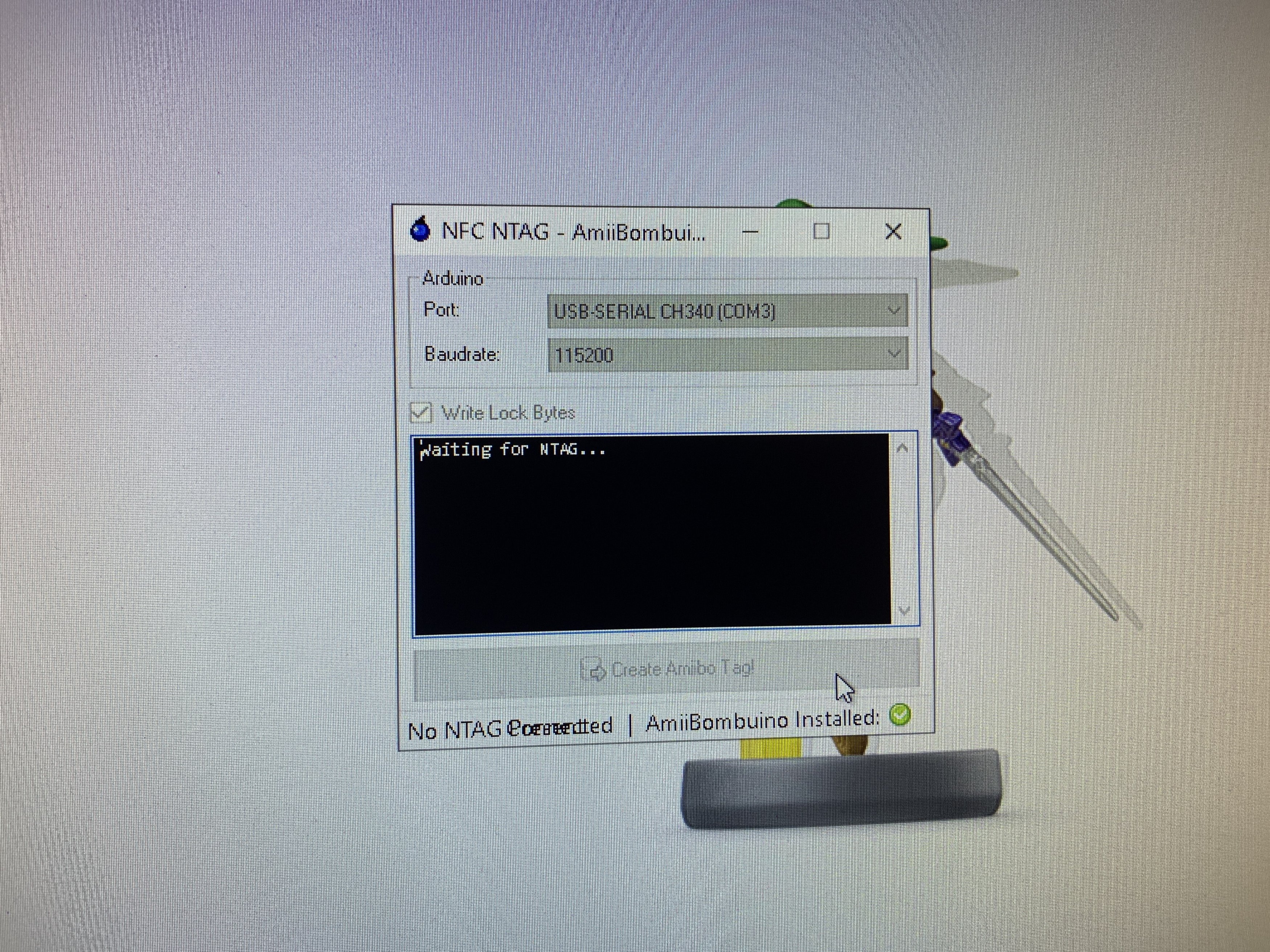

Not sure if this thread is still active. I have connected Everything up. Got some ntag215 stickers type 2. And have the correct amiibo key files and bins. When I go to create NTAG and select the correct port. Once I hit create amiibo rage it just hangs on waiting for NTAG. And then error your tag isn’t probably not a ntag215.
