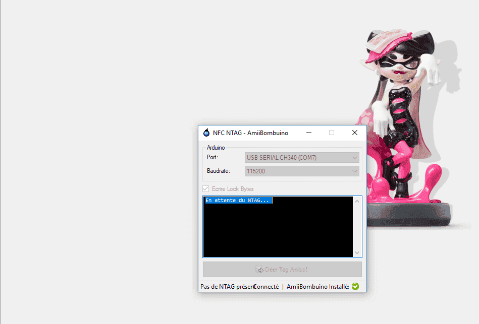

i'm getting this error as a recent when i press create tag

Now I have the fourth problem. When I try to flash my Arduino from the Amiibomb Internal Flasher, In version 0.3 I kept getting a "Device Error" message, and in version 0.2 I kept getting a "Establishing sync..." message.
I moved the entire Amiibomb folder to c://Temp but the error continue....
you can help me? THANK YOU!!
