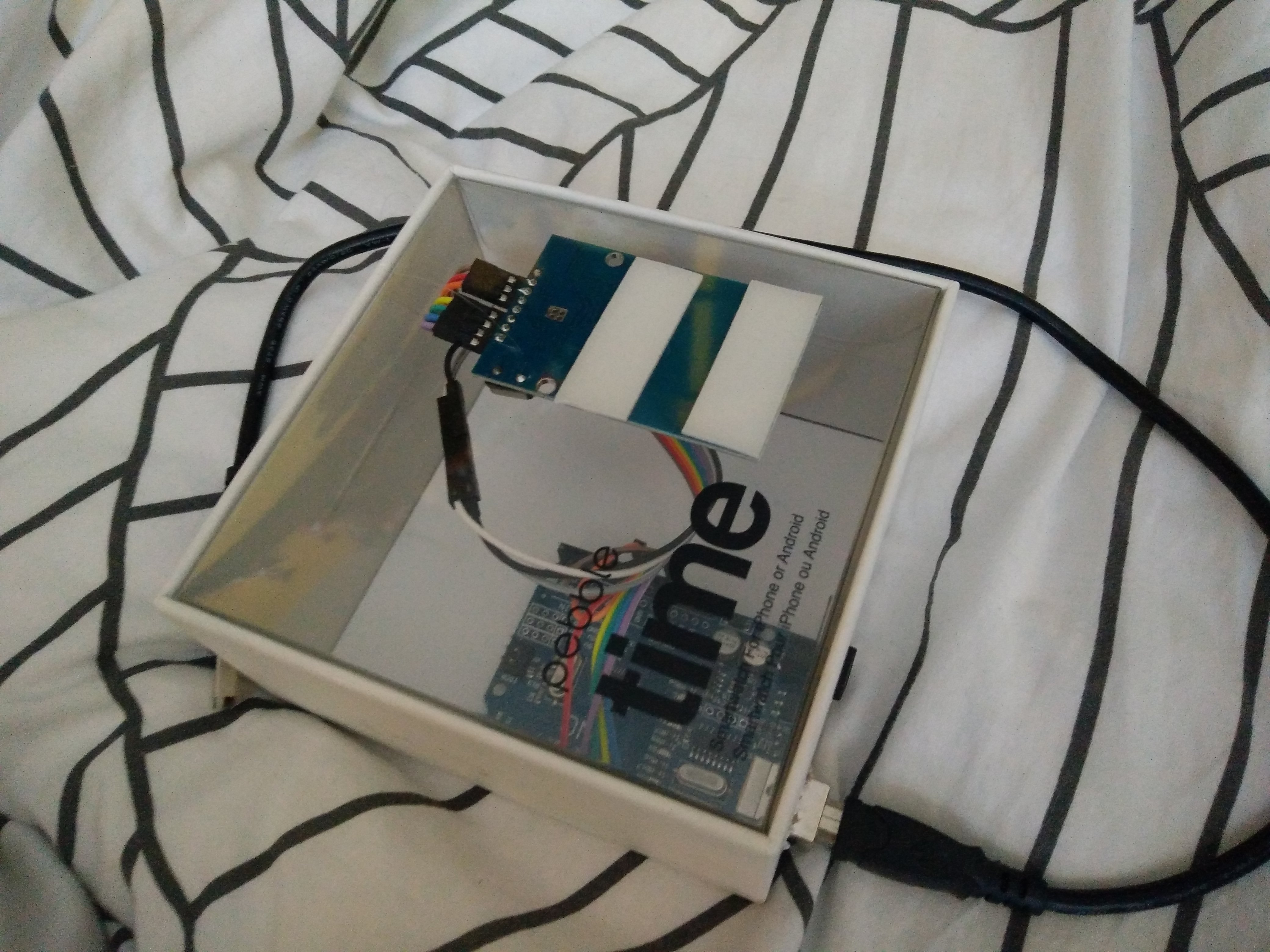

I don't like to keep bare pcb's around on my desk.
So while waiting for my UNO R3 hardcase, i used the box from the kit to keep things a little safer :)
It's ugly and temporary, but it does the job, keeps it protected and steady when flashing or not in use :D , ow and it doesn't take that much extra space on your desk ;)
It's free and shows you how to recycle stuff :P

just got mine gonna do what you did with the box 10/10 idea.
