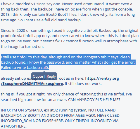

I have a modded v1 since say one. Never used emmunand. It wasnt even a thing back then. The backups i have on pc are from when i got the console, 2018 i think, only contain Boot0 Boot1 files. I dont know why, its from a long time ago. So i cant use a full old nand backup.
Since, in 2020 or something, i used incognito via tinfoil. Backed up the original prodinfo via tinfoil app only and never cared to know where this is. I dont plan to go online ever, but it seems fw 17 cannot function well in atsmophere with the incognito turned on.
I still use tinfoil to this day, altough and on the incognito tab it says: clean backup found. i know the password, and no matter what i do i get the error: Failed to write backup cal0.
already set up exosphere.ini on root as in here: https://rentry.org/ExosphereDNSMITM#exosphere, it still does not work.
thing is, if you got it right, my only chance of restoring this is via tinfoil. I've searched high and low for an answer. CAN ANYBODY PLS HELP ME?
INFO: I'M ON SYSNAND, exFat32 running system, NO FULL NAND BACKUP(ONLY BOOT1 AND BOOT0 FROM AGES AGO), NEVER USED INCOGNITO_RCM NOR EXOSPHERE. ONLY TINFOIL INCOGNITO VIA ATMOSPHERE.
