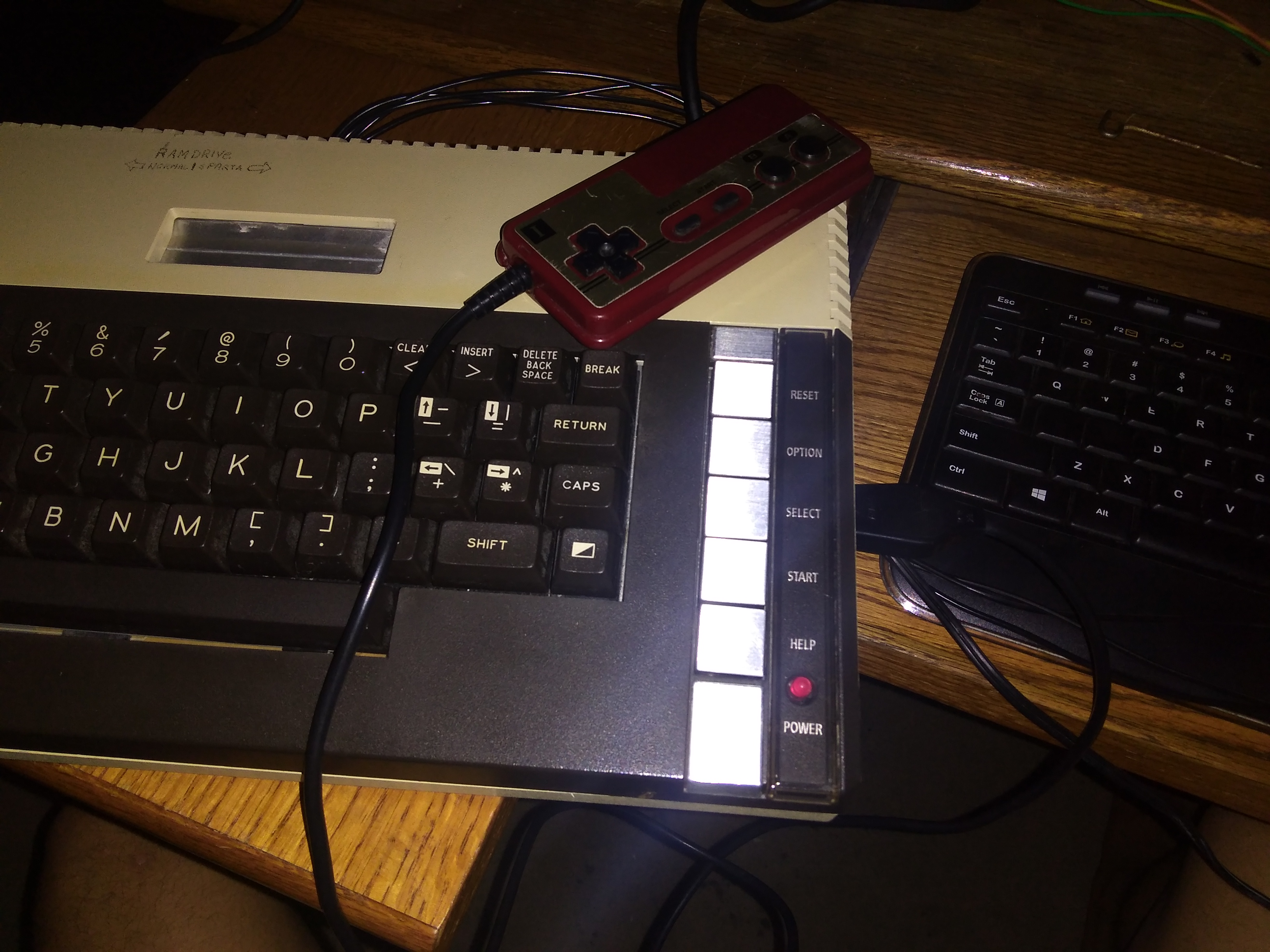

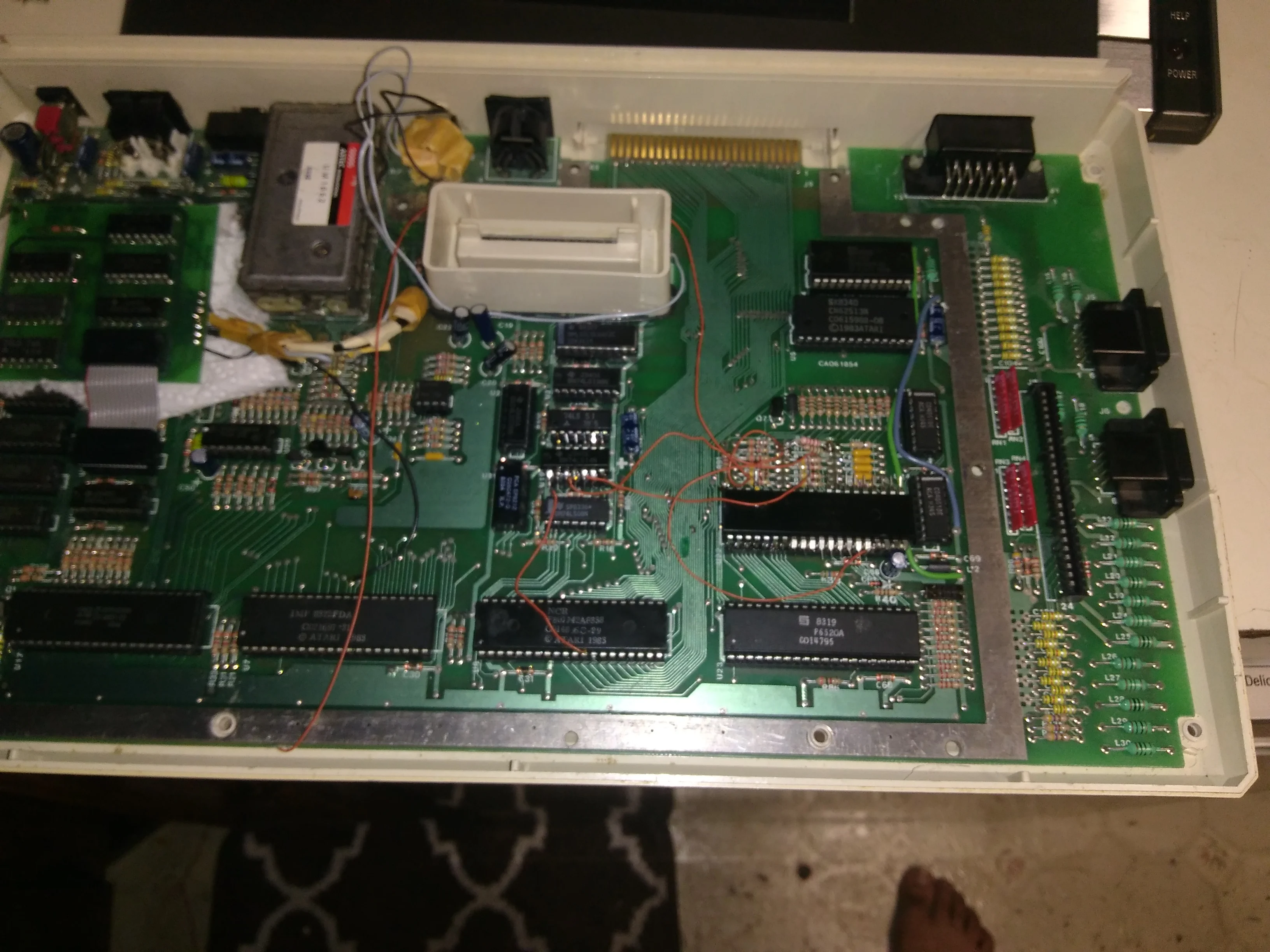

converted a famicom controller and and added another POKEY
STEREO POKEY ftw!
i just need anohter 256k, or an Ultimate 1 Megabyte upgrade...

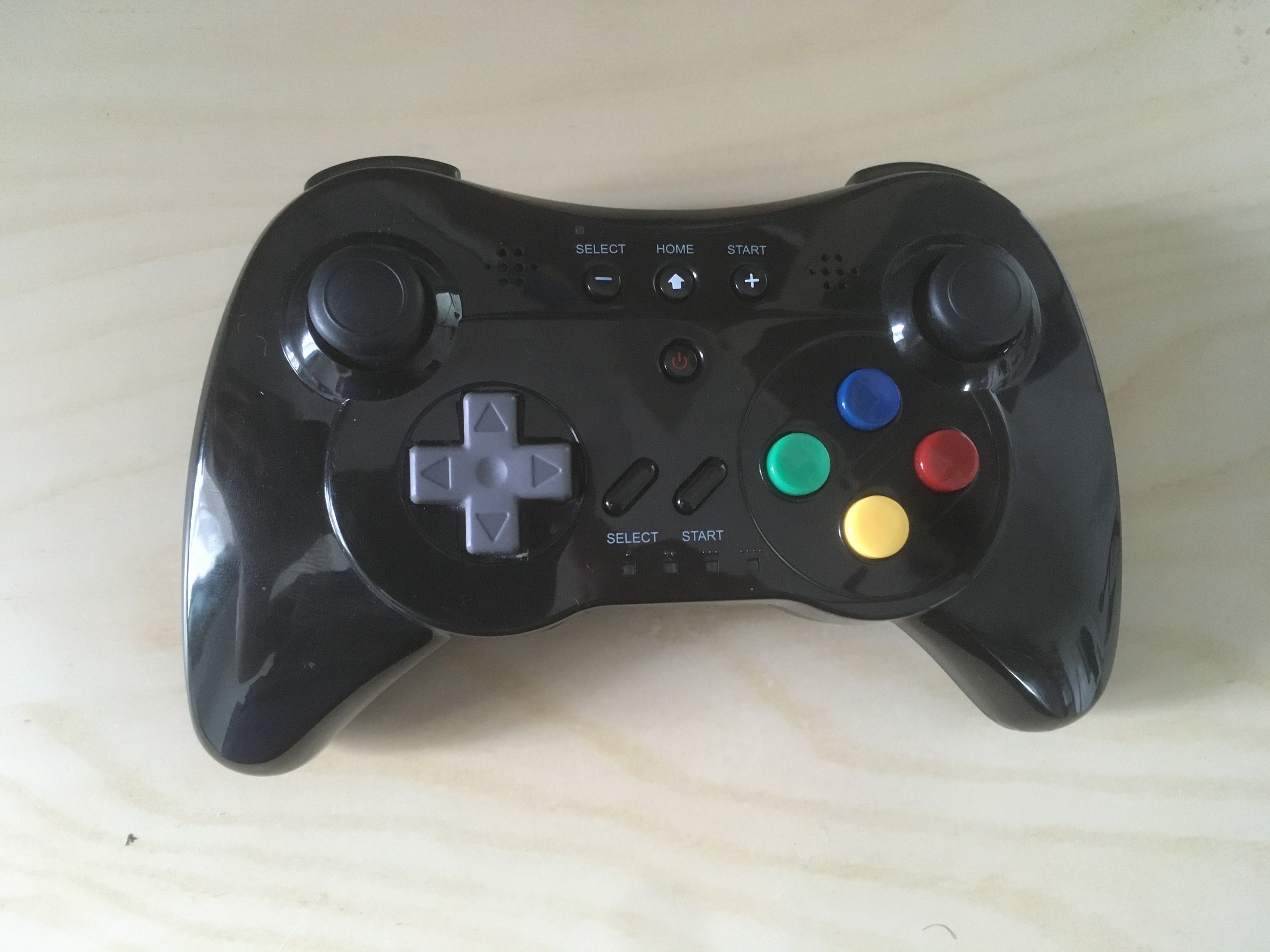

Modded: Controller Pro U (Wiimote / Classic Controller hybrid)
I was curious to try this controller (as modelled by the cat in my avatar) for games like Super Paper Mario and Metroid: Other M that use the Wiimote on its side, as that's normally not very comfortable. But the first one I got was actually a third-party Wii U Pro controller in the same shell (complete with non-functional IR window…) and it wasn't worth paying the return postage to get a few pounds back. The second one I got was the actual Wii one. I had heard bad things about getting accidental diagonal inputs on the d-pad, so I opened up the case and put several layers of tape under the pivot. I subsequently replaced the Wii U-style d-pad with one from an N64 (for which I had to enlarge the + hole in the case with a file), as the original edges were quite sharp. As an unexpected bonus, the d-pad is slightly tilted (up extends further from the case than down), which is more comfortable. I also transferred the SNES-coloured buttons from the WUPC.
