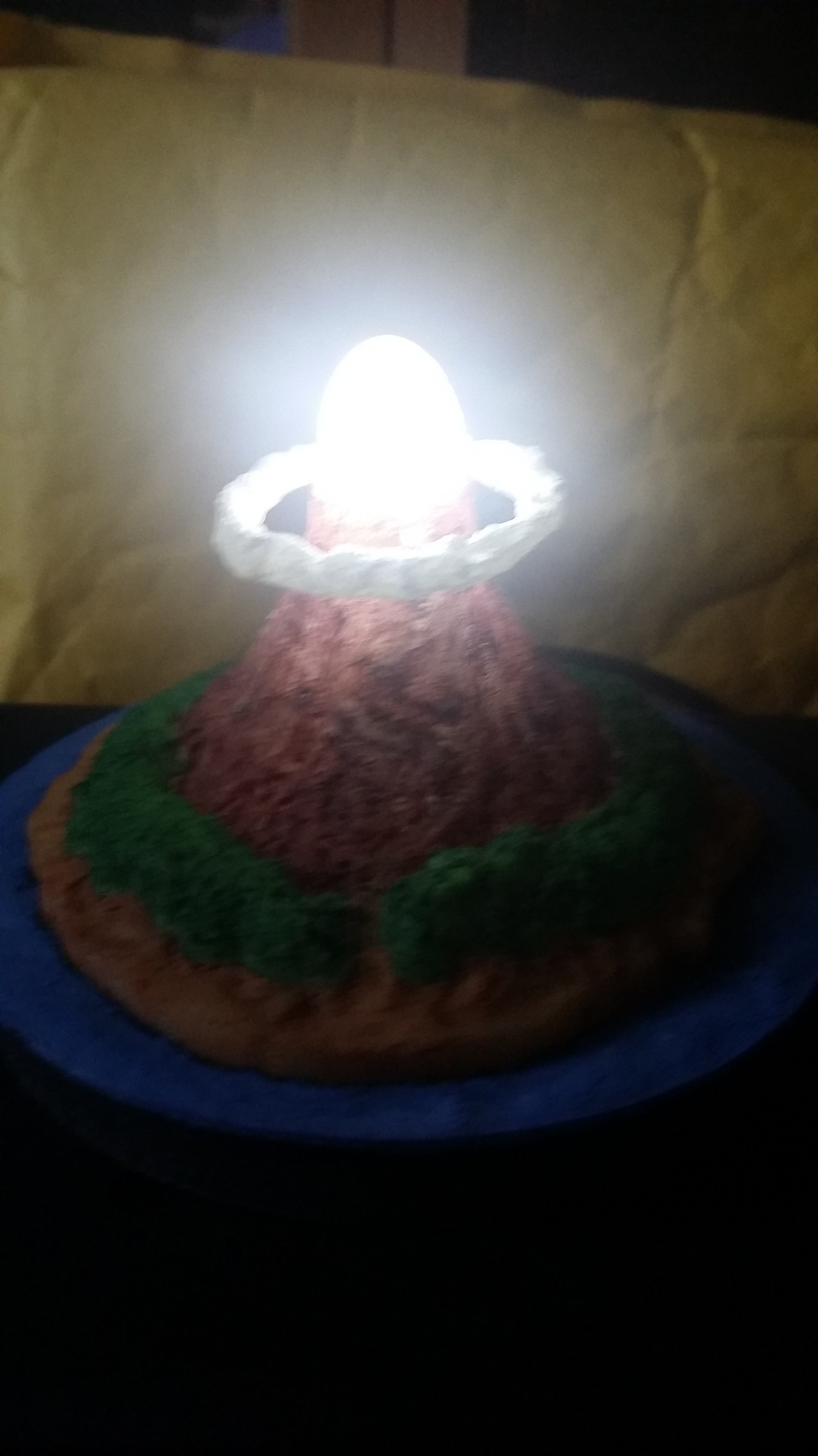

Finally, I made a small nightlight for my niece, and slightly modded a 3d print of Koholint island to have a LED in the wind fish egg.

And Koholint
