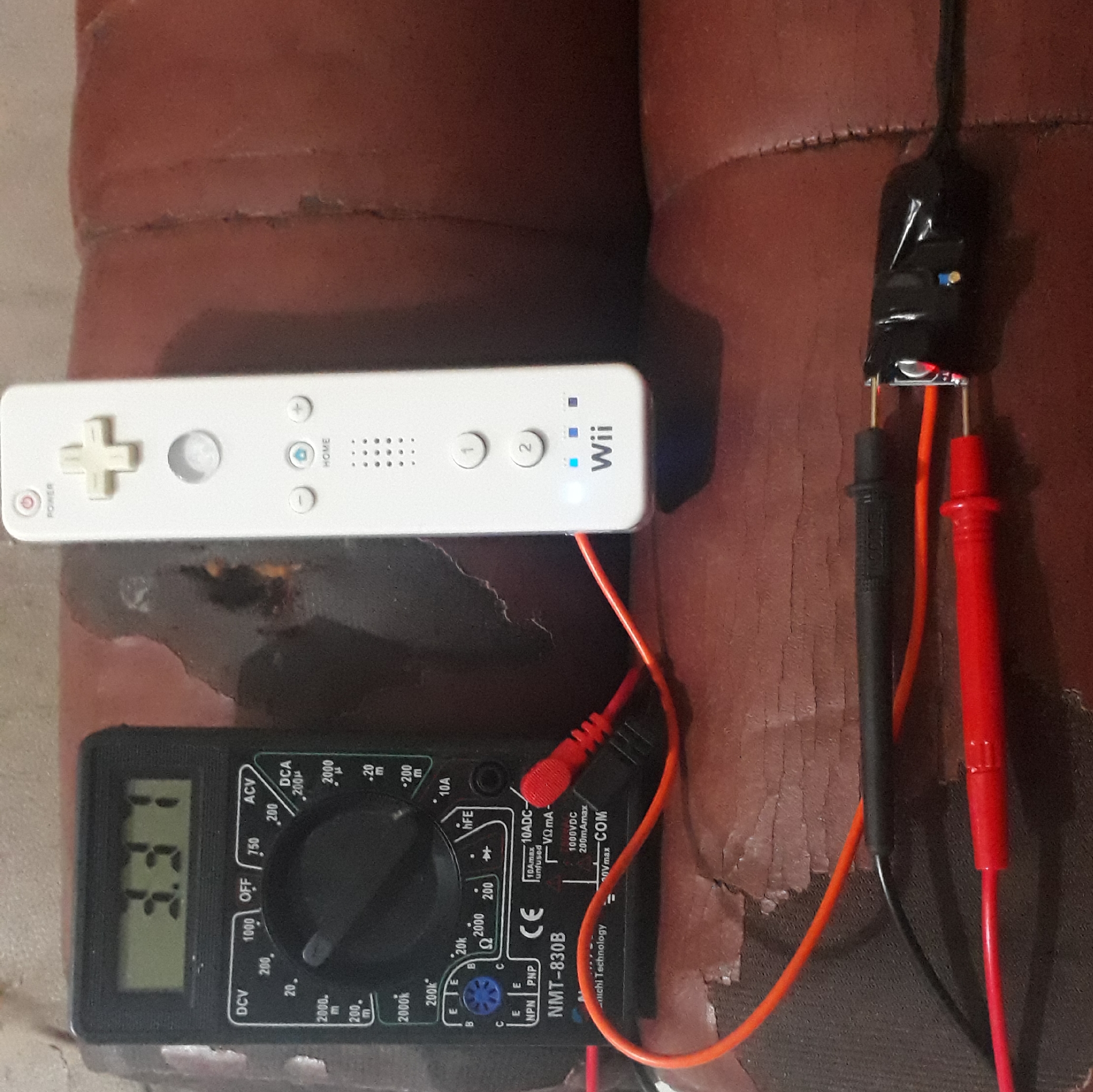

i make an adaptor for my wiimote from 12 volt DC to 3.3 volt DC. i buy adjustable DC stepdown for $1. and it works great. wiimote working voltage range at 2.5-3.5 volt DC. but now my wiimote have some problem. so it works only at 3.2-3.5 volt DC (with rumble and sound) if you want to make like this one, dont put the voltage more than 3.5 volt DC. or it will screw the motion control.

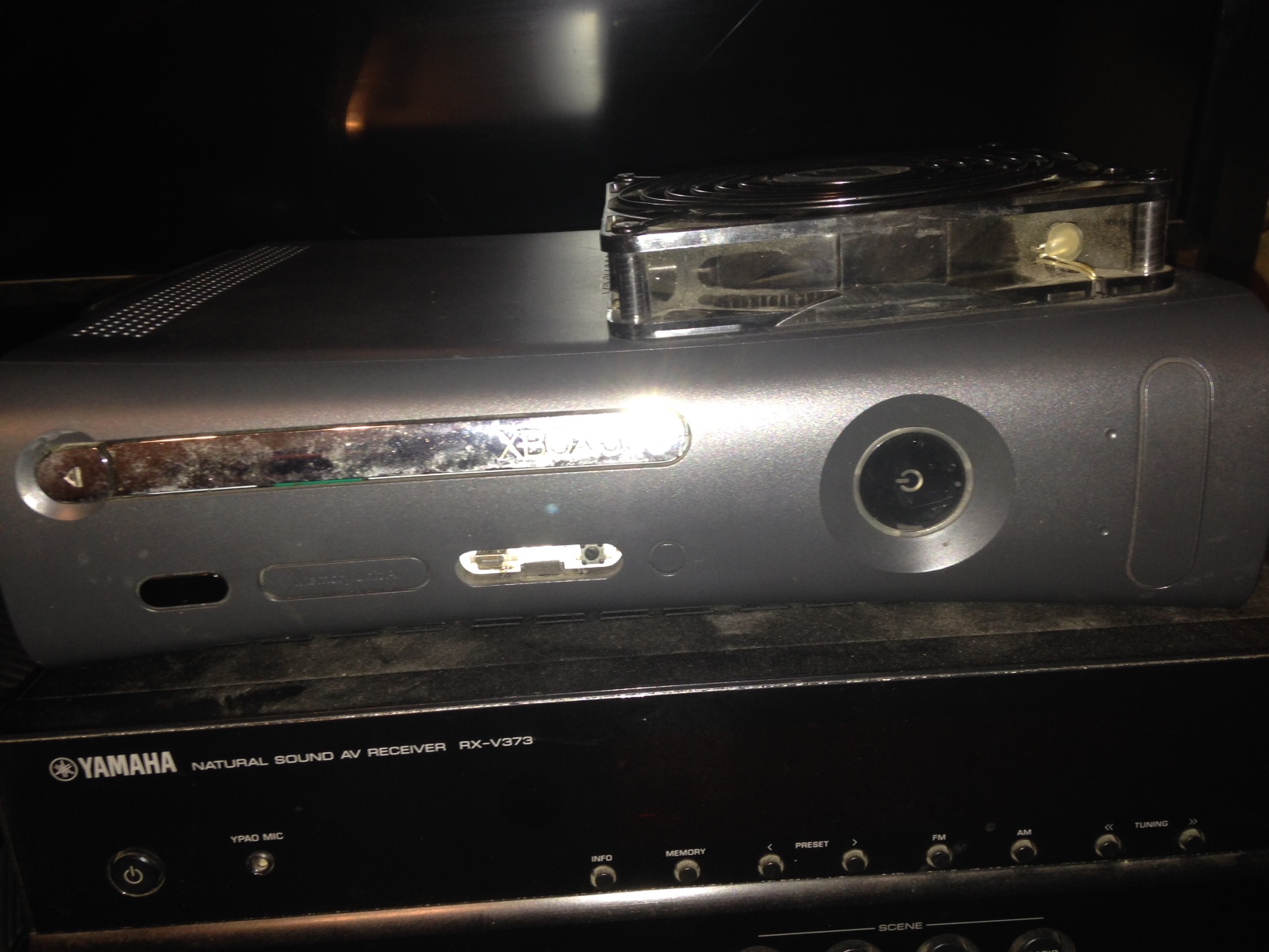

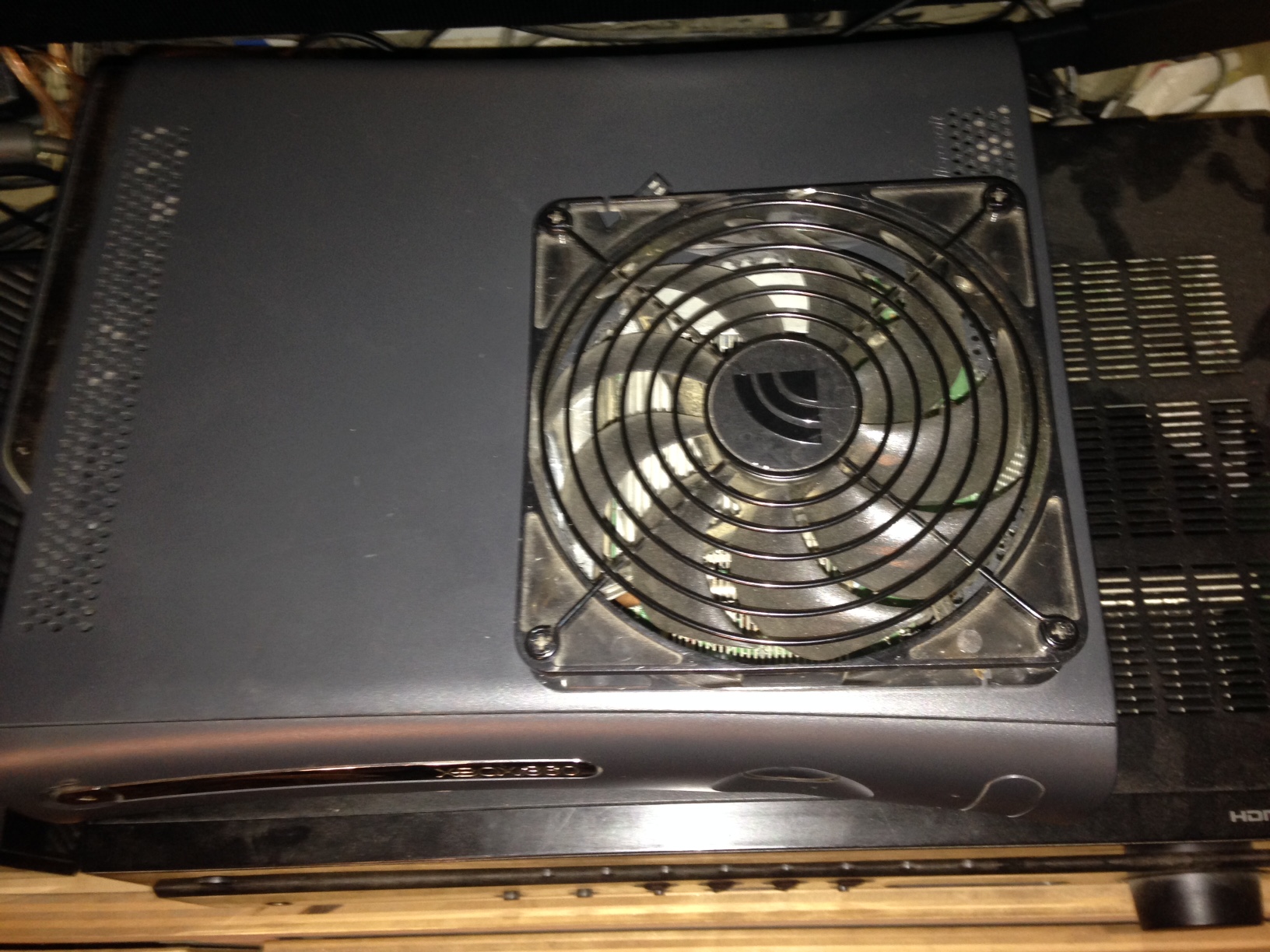

I got tired of my loud ass stock fan in my chipped xbox360 when it got warm, and I had a few extra pc fans lying around so I traced and cut round hole on top of case right above the heatsinks, using a dremel tool, and used 12 volt from inside the xbox to power it, and few nuts and bolts to hold it to case. It's not pretty but works great! Temps real low. Stock fan hardly runs, and I can't hear fans running at all now. May get a slim style fan for it later.
