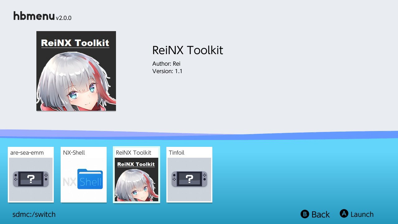

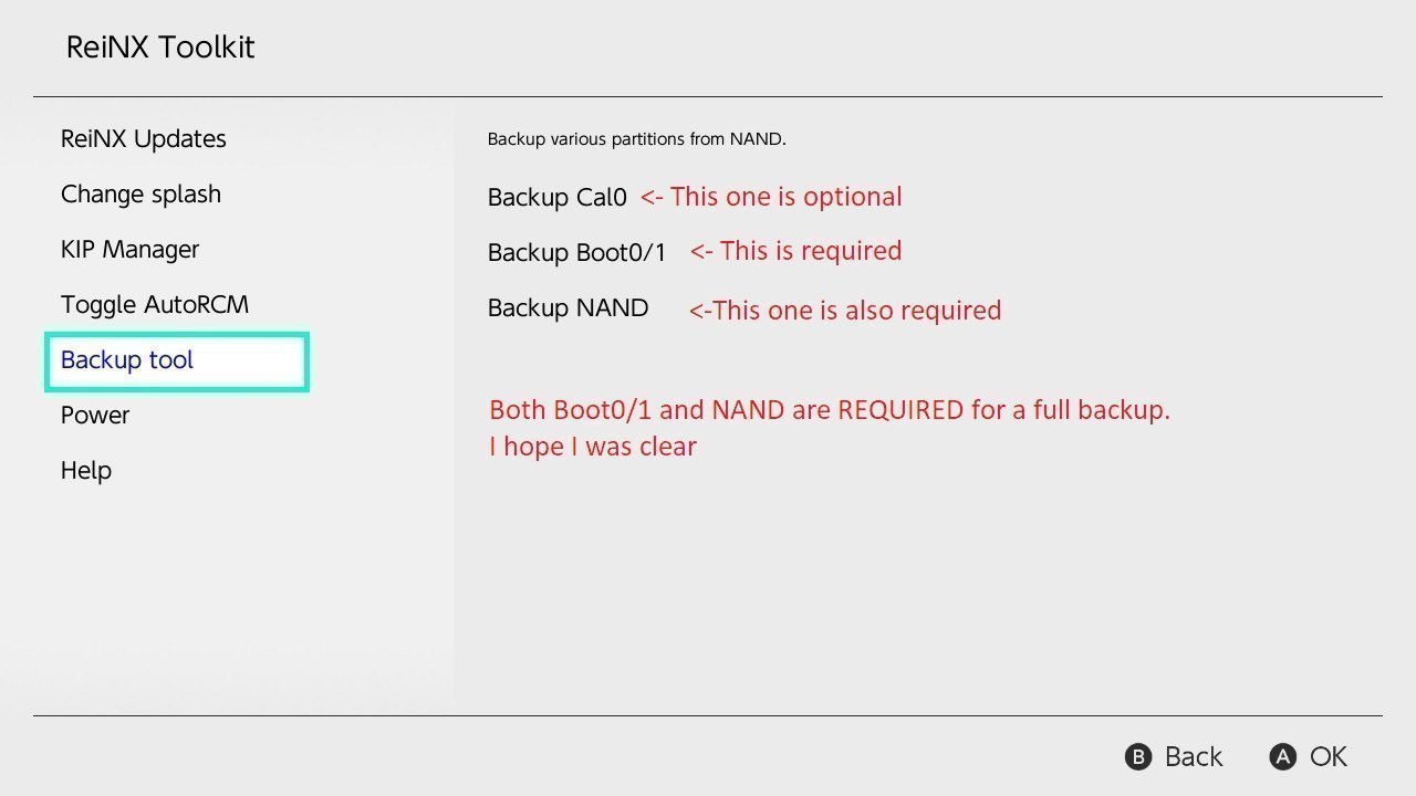

    Using ReiNX ToolkitUsing Hekate
      1. Compile/download the latest ReiNX Toolkit Found Here.
      2. Copy the ReiNXToolkit.nro file to the /switch folder
      3. Open album and select ReiNX Toolkit
      4. Scroll down to backup and choose BOTH “Backup Boot0/1” and “Backup NAND”
      If you are confused, please see the pictures below.
      STEP 1:
      STEP 2:
      STEP 3:

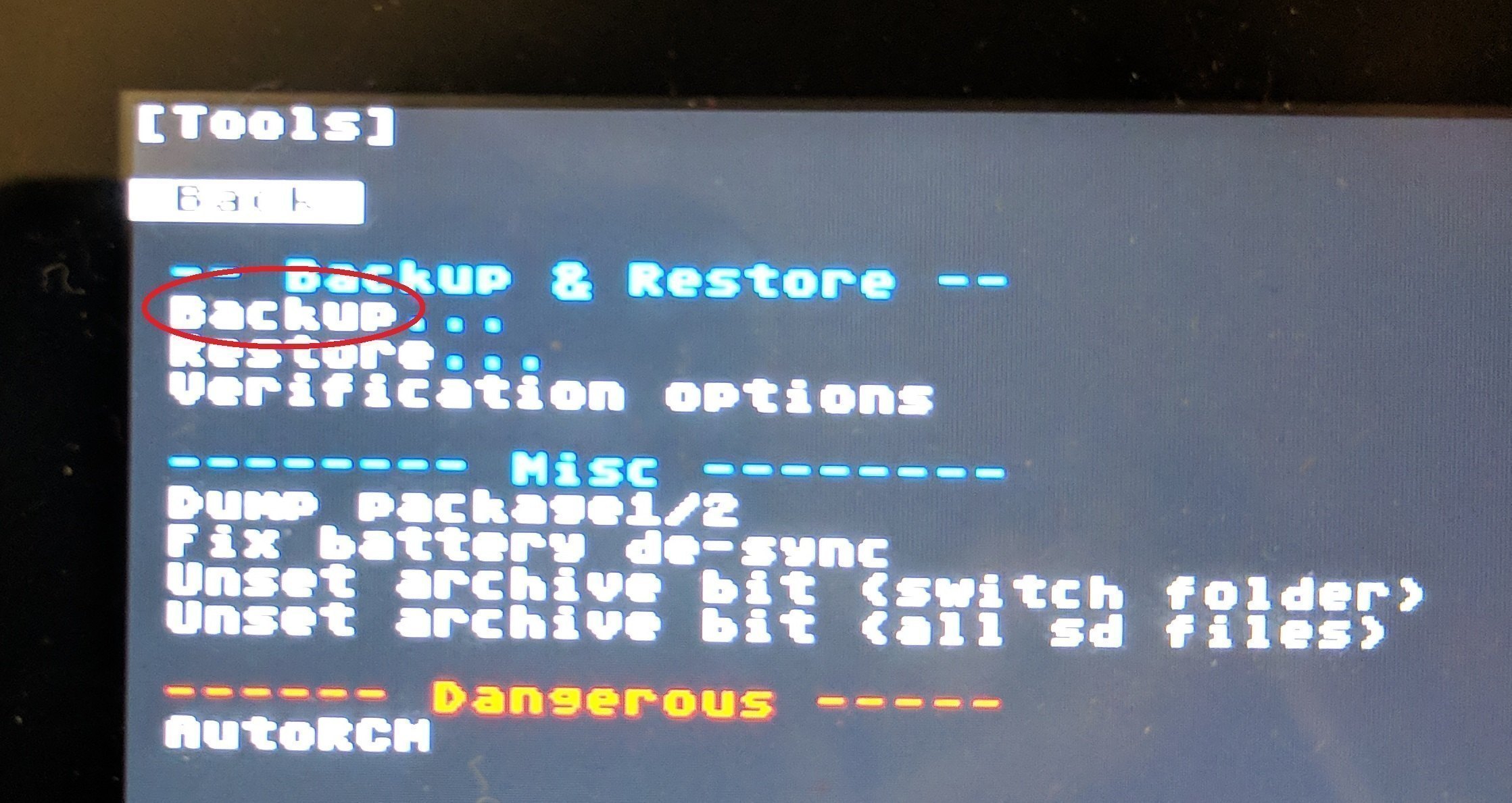

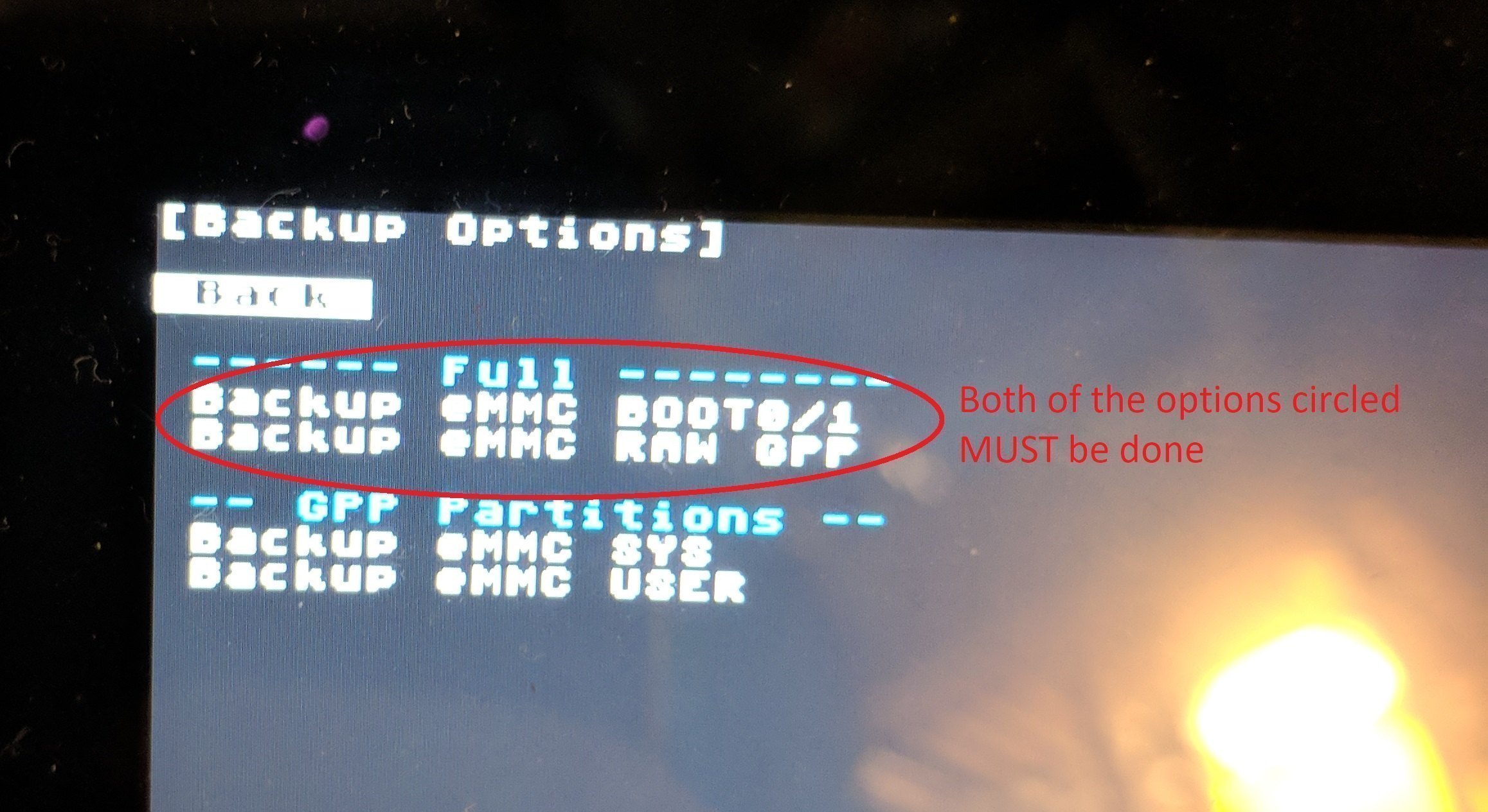

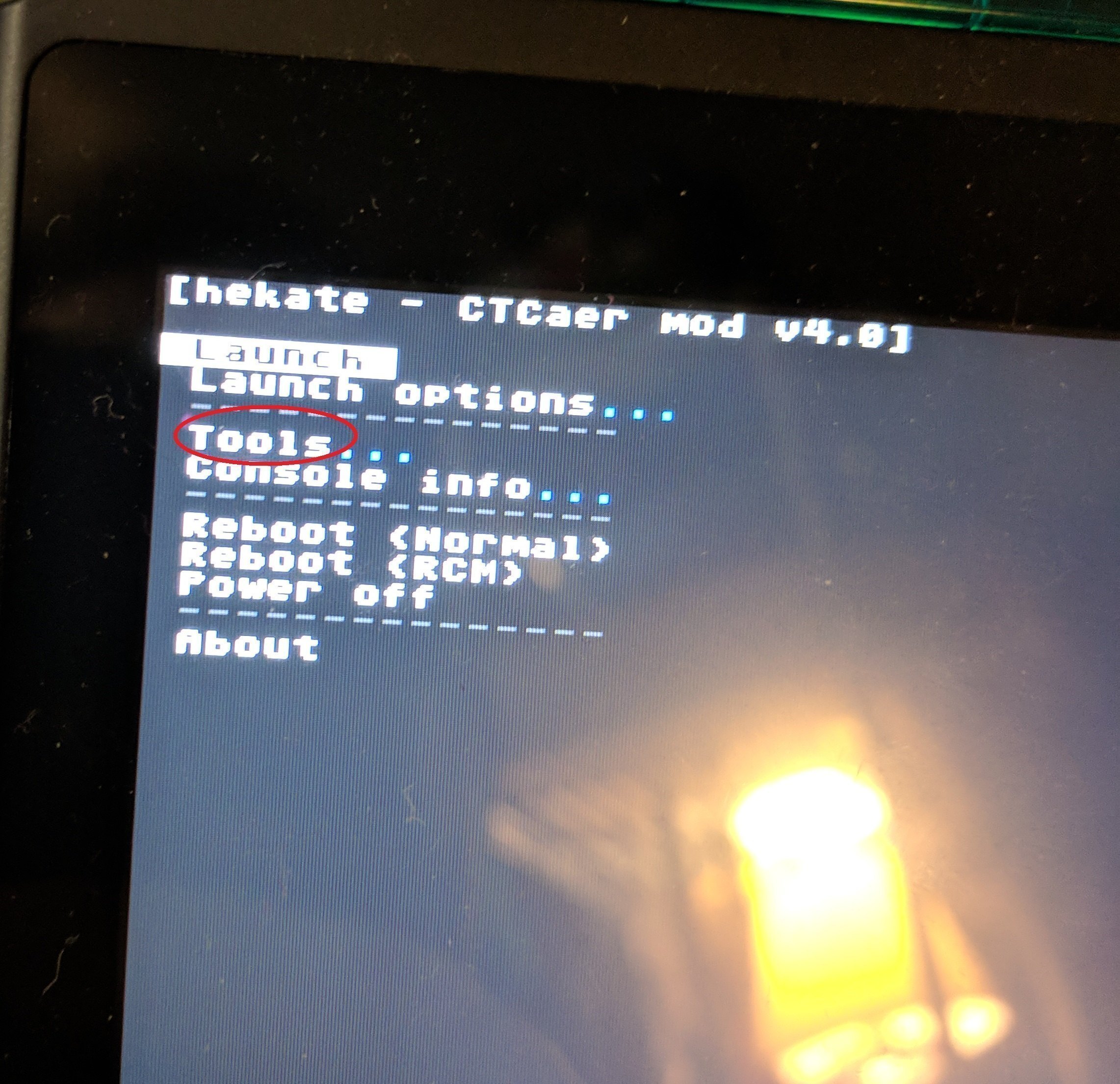

      1. Compile/download the latest Hekate Found Here.
      2. Once you’ve pushed the hekate payload, go to Tools>Backup
      3. You must run BOTH “Backup EMMC Boot0/1” as well as “Backup Raw GPP”.
      STEP 1:
      STEP 2:
      STEP 3:
