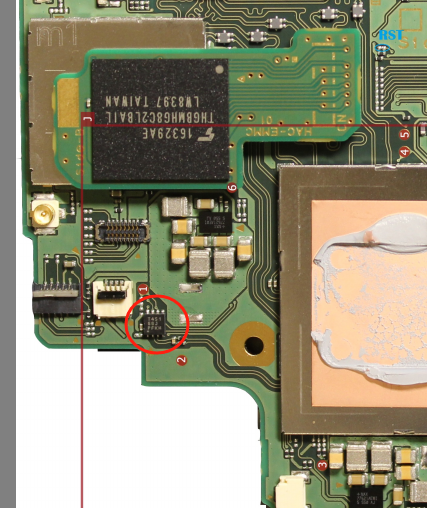

I do hot air blow on the temp sensor if I want to know fan works or not. Or you could test the other way around, blow cold air to stop fan spinning.
