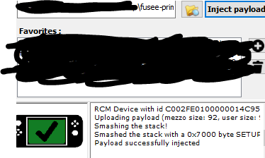

Im getting all the right messages but nothing is happening on my switch screen at all. I've tried different versions of atomosphere and different payloads but I still get a black screen. I can boot my switch up like normal but then it's just normal with no extra stuff.
