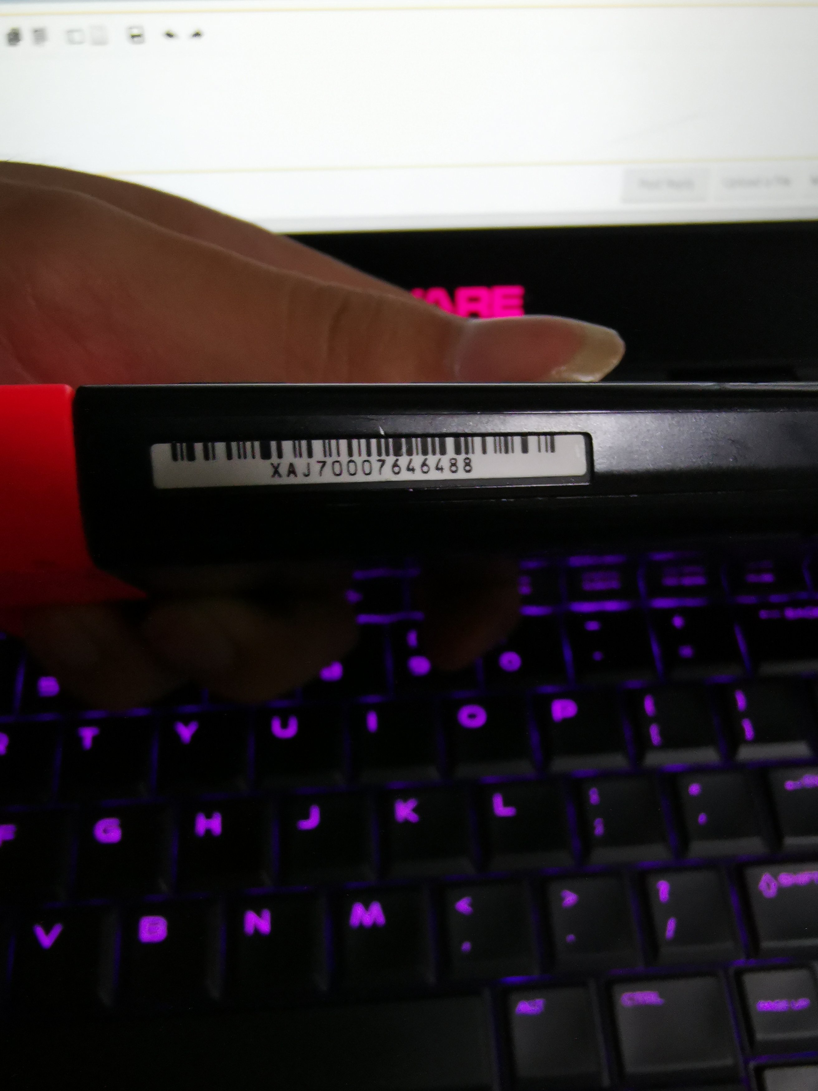

Is the serial at the bottom the same as before? A lot of hardware companies call it 'repairing' when they actually just ship you a new or refurbished unit. Walmart does it with TV's. If that happened in your case then, well, that sucks. Might have gave you a patched unit.
Nope, I had checked the serial number matches the the ones I see in my system info. I am not sure if it is related to the voltage issue on the memory card ic chip
Those serial numbers would match if they sent you an ipatched switch.
Try inject hekate.
I will try it after I get off work.
But anyway guys my switch is 70007 version in terms of my acct and everything was still on my switch so I am quite sure it is not ipatched switch

Could it be when they fixed your switch they replaced the mainboard with an ipatched one?
Boot normally and format the SD card with the Switch to make sure it is seeing it.
Then turn off the Switch and setup SXOS on the SD card and retry.
cuz i checked with them they only replace the micro sd card ic chip. And also the serial matches with my console
