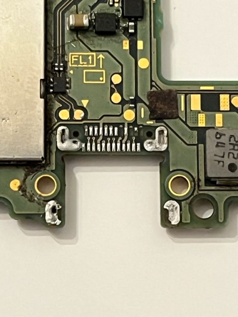

Hello,
I have a OG switch that had a bad usb-c charging port. My son dropped the game while plugged in and the usb-c port became loose. I opened it up and unsoldered what was left. Upon inspection it appears the leads on the motherboard were ripped off slightly and I'm unsure if solder will just complete the connections or if I'm SOL.
is this salvagable?
Well it is salvageable. You can make repairs with pads like that but it isn't easy.
I've seen repairs on Switch USB-C ports that looked a lot worse on Youtube.
I would honestly check up a repair shop to do it for you.

This is very much salvageable. It would require a bit of work to fix those broke pads, but it is 100% fixable. You would basically need to scrape off a bit of the solder mask on the board to expose the copper and run a short wire.

To add
You need to do a "Drop" method on a Switch. Since you can solder the pads that will be under the port. Only the backline that is damaged in this case.
Copper wire, so like fine wire that you can easily salvage from a dead speaker.
Yes exactly. Just make sure to only remove the coating from the ends. Don't want to have to worry about any bridging of connections. That could very easily fry the system seeing that this is the charge port.
A set of wire strippers or a soldering iron with a fine tip at a high temperature can easily remove the copper insulation.

You could ship it to https://northridgefix.com/
1st roll pins are no brainer. And seems missing pads still get the node/via over the top. just tiny bit jumper wire with proper seat new port and good to go.
