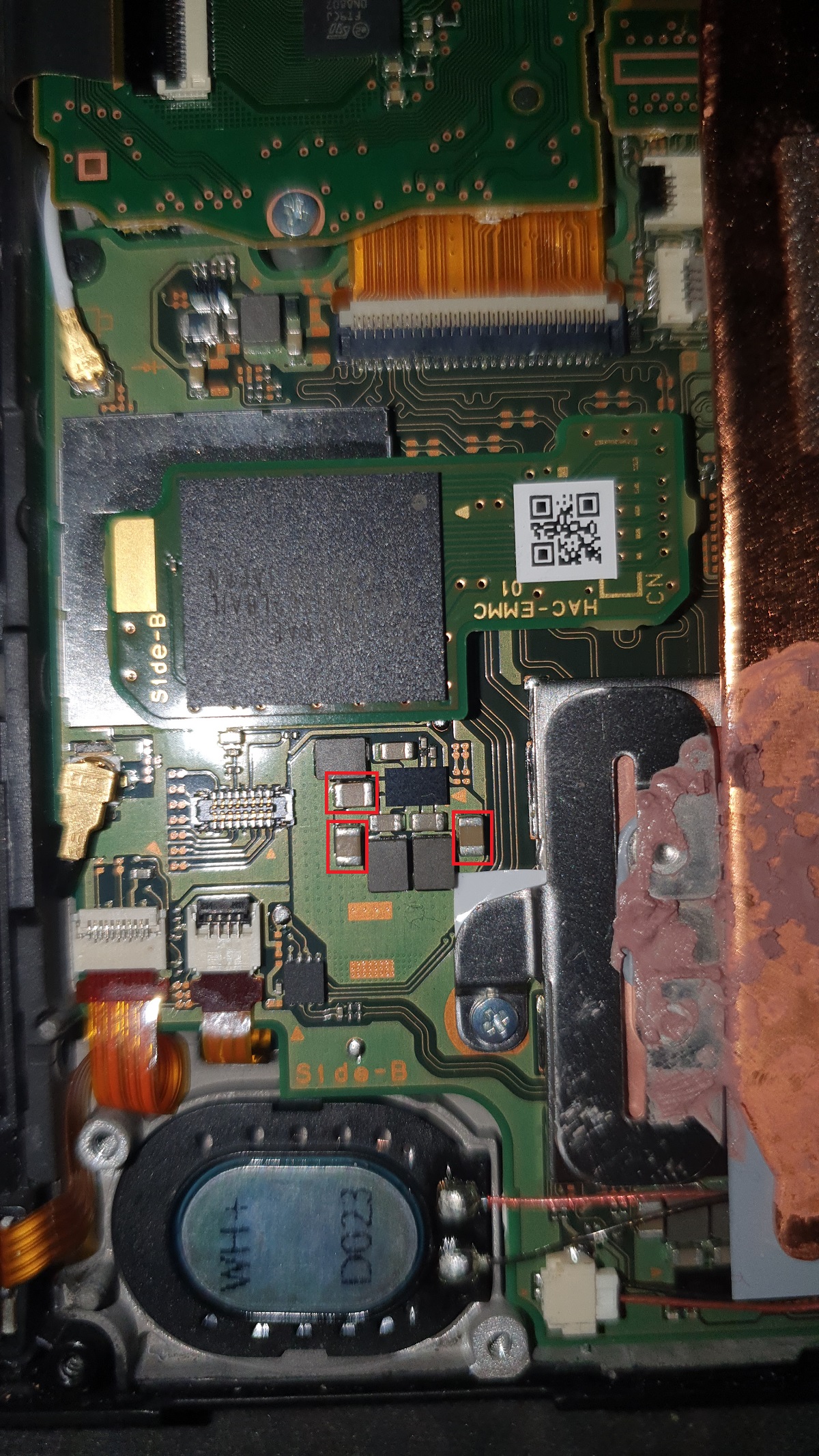

Hello Everyone.
I got the same problem, this happen to me when my switch was in a original dock in standby mode, When i lifted the switch en putted it back in the dock to start, it was automatic restarted to the hekade menu.
Then i turned it back on either the OFW or CFW didnt go past the switch logo.
I tried everyting with the software part nothing helps.
Now i was looking on the hardware part and did some research on the capacitors.
I found 3 shorted ones next to the max77621 chip but didnt trace the routes yet, i think they are going to the max77621 chip.
Found the chip on aliexp, i can update this later when the chip arrived.
Sorry for my english.
Will keep this updated.
Reactions: DripZ

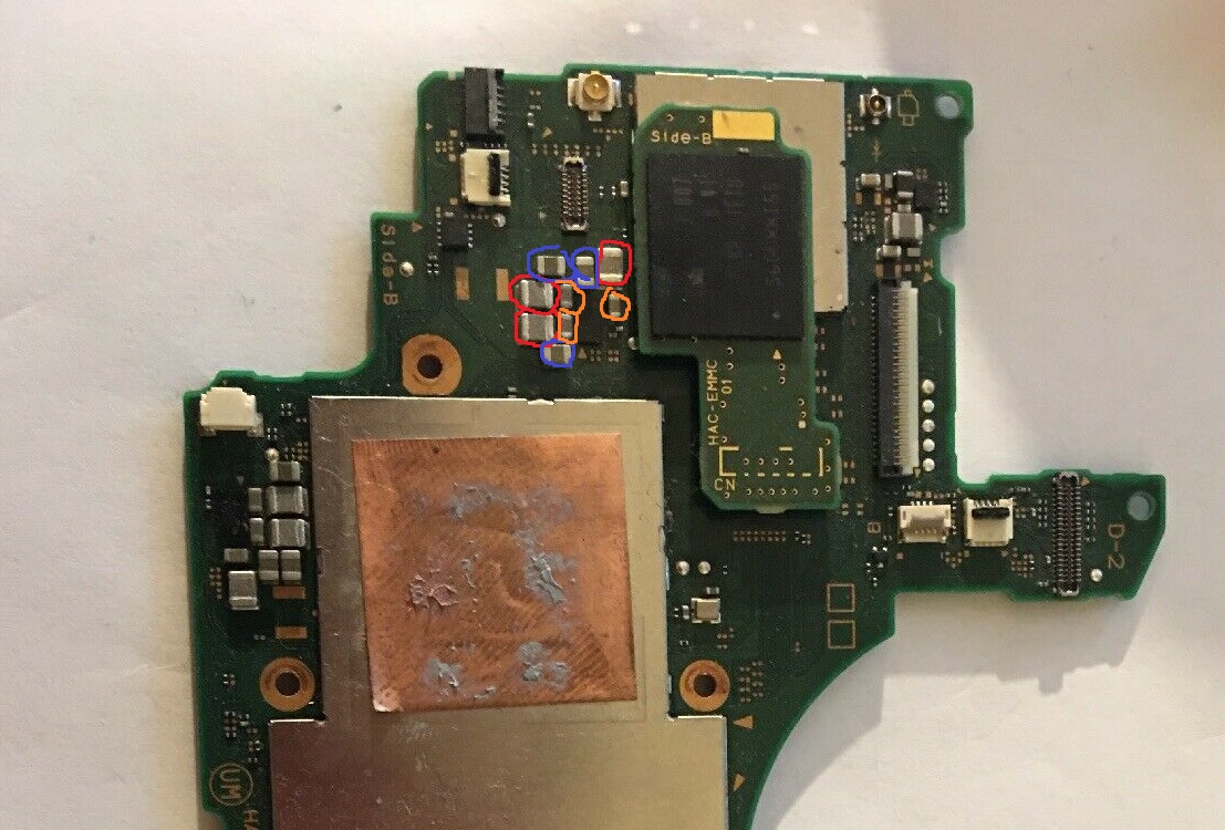

Hello Again ,
I changed the Max chip and still the caps are shorted.
can someone please tell me which capacitors these are next to the max chip , So i can buy new ones ?
Reactions: DripZ
