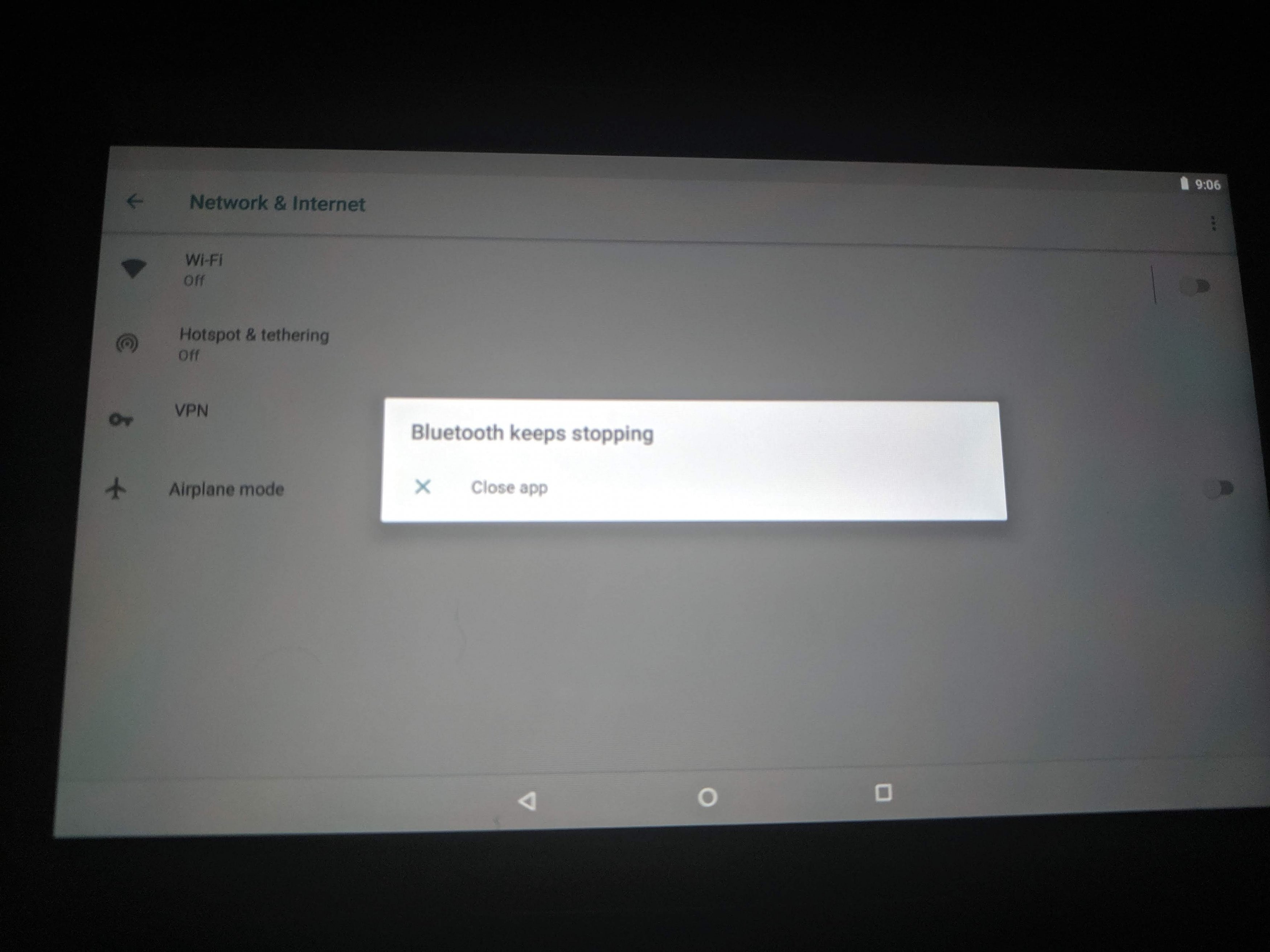

Hi again, I've installed android on my switch and everything was great until I boot it up and my bluetooth and wifi won't work, Maybe my switch won't boot the CFW or OFW because the bluetooth/Wi-fi module is damaged (I don't even know if it's a separate module or is integrated on the motherboard but you got me). Can someone tell me if that could be possible?
Here I attach a picture of the bluetooth crashing, can't turn wifi on either.
Here I attach a picture of the bluetooth crashing, can't turn wifi on either.View attachment 185168
Yea, that’s probably the issue, for whatever reason the system refuses to boot normally if the WiFi/Bluetooth chip is malfunctioning.
It’s soldered the board in some way.
Damn it, if it soldered it would be impossible for me to fix it :( well at least I knew what caused the whole problem. I hope Tigermean74 can fix it
