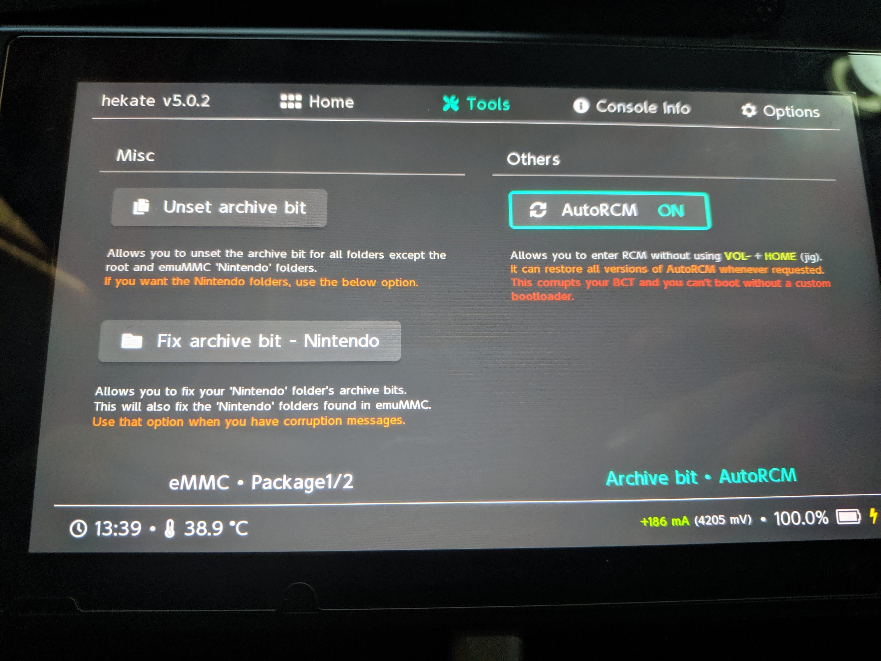

Hi here, no that was version 5.0.2 - hekate_ctcaer_5.0.2.bin
My hekate looks like this
DripZ
Nov 2, 2019
35
26
89
Panama
Wow thanks, that is different. Am I missing something off of the sd card perhaps because I definitely loaded the hekate_ctcaer_5.0.2.bin with TegraRCM and that's not the menu I get, the one I get is the screenshot I sent you
Yeah, that looks like the old heakate, before the 5.0 version, you must update or rebuild your SD files

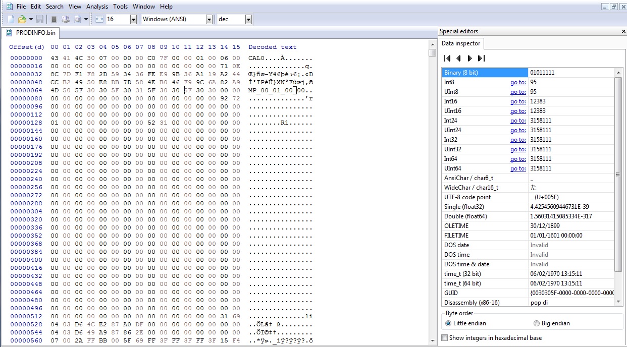

>bought broken
>Stuck at Switch logo
Have you checked it’s prodinfo? Having a fucked prodinfo is a thing that can cause it to get stuck at the Switch logo.

I already tried hekate version 5.0.1 as the guide suggested then I tried 5.0.2. I also already had the kip1 file on there as well as the kekate.ipl.ini. I followed the guide very slowly . As you can see from the screenshot, this is how my hekate v5.0.2 boots
The switch also seems to be stuck on a black screen which I assume is always in RCM mode, because the switch does not power on anymore to give me any logo's...so possibly even in a more worse state.

I just had a thought, does the sd card have to be formatted to exFAT for Hekate to work properly, currently formatted as FAT32

Hi Dripz, Just wanted to let you know...so I finally booted into Hekate properly like your screenshot!!
What i had to do was, copy all the contents from the "sys" folder that was in the 7-zip file for Hekate v5.0.2 over to my sd card which also included the nyx.bin file so thank you to KuranKu as well for pointing that out....
Well, here goes, I will update to let you all know if it works or not
Thanks again
Reactions: DripZ

Hi,
Do you have a guide or instructions how to do this please?
Run memloader, select emmc, open hacdiskmount on your pc, open a physical drive (the Switch will be Linux UMS disk or something like that) in hacdiskmount, select prodinfo, put in the required biskey, press test then save, if it gave you no error dump it to a file.
Tigermean74
Nov 2, 2019
94
47
185
Thank you very much for the quick response, I was able to do it through my nand backup, would that work the same ok?
I have attached a screenshot of the output using a hex editor HxD, does it look ok?
Thanks...
