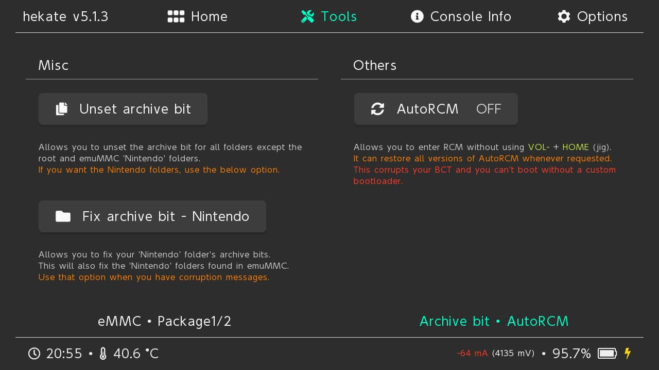

And I have one more question, why does my switch only turn on through hecate, it does not respond to power?
Look in Hekate/ Tools and see if your AutoRCM is turned ON, if so, that is how it's supposed to work. So you can use the RCM payload launcher, without needing to use a jig on the right rail on each boot.
Reactions: Nephiel
I have another problem now, fw 19.0.1 atmosphere 1.8.0 and it won't start :/
