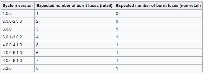

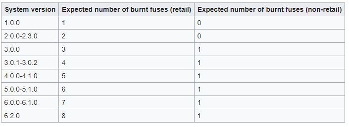

Once into cfw You should run the ChoidujourNX and update the system to the current or same fuse count aka the system version that matches ya fuse count or the system version your switch is currently updated to...
You may use a payload called briccmii to check ya fuse count and check here for the system version your switch supports normally.
