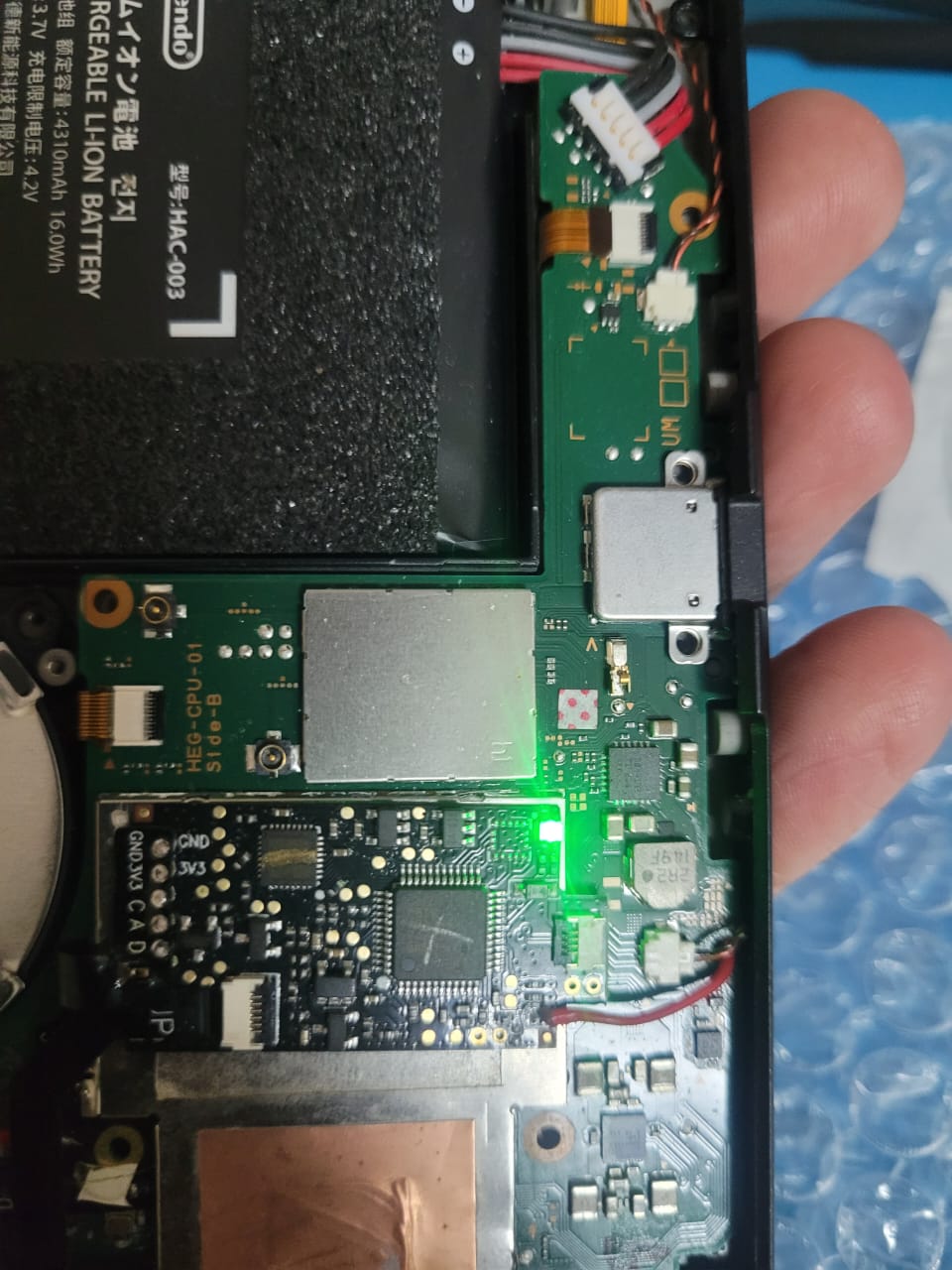

hello, I would not have posted this if I could find an answer to this issue, can't seem to find a similar problem. complete beginner to this stuff (first time modding )
Installed OLED v4 hwfly chip.
( Diode values are within 0.5-0.8v for A,C, D, and 3.3v .B point :2v)
Initially led was blinking yellow (i kept it going for 40 minutes with no progress). after switching it off and turning it back on, it blinked purple then solid green (2 sec), then slowly blinking green. The switch turns on but goes directly to OFW. can't seem to load into CFW Hekate.
I tried connecting hwfly chip to pc but it doesn't detect it (tried updating drivers, it doesn't show up on the USB port, tried different ports,pc, and windows versions). Seller says it is updated to 0.7 version, Doesn't need updating, direct install.
Another issue might not be related but it makes a sound whenever it turns on (like when you put water on a hot pan ) not present before installation. Any help is appreciated.
The dat0 installed is a side L-shaped one because ii am not confident in reflowing emmc (skhynix is fragile I read )but the connection is secure and the reading is consistent even when moving and shaking the board

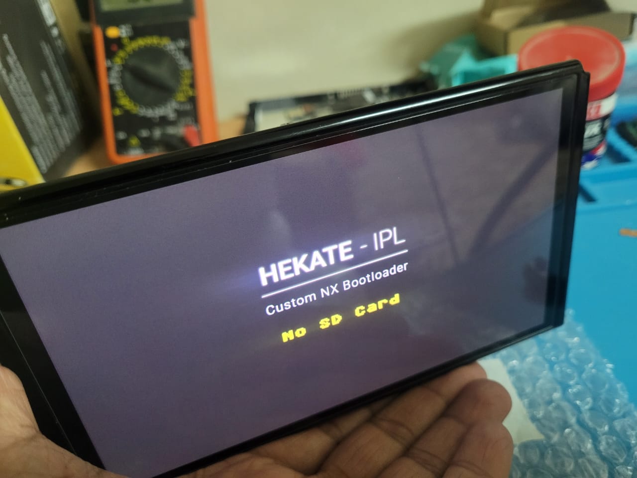

att: there is yellow light blinking , i got it to blink green ( dont have an image now will post later)
