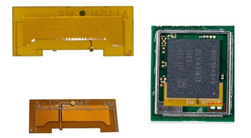

i restarted my switch in order to update it but instead of going to atmosphere and cfw it went straight to OFW
to be more exact when i boot to cfw it shows atmospheres logo then goes to the home menu of my cfw
instead it show nintendo's logo then the nintendo switch logo then goes to the home menu of ofw
i tried power off and power on so many times and it didnt work
does anyone know why it happens and how to fix it ?
dat0? is this in the chip i didnt do the whole installation thing someone did it for me
what can he do to fix it?
It will need taken apart and reflowed, or repositioned.
Have you tried to boot by holding vol + and power button together ?
10 times already yes apparently its a dat0 problem i need to go back to the guy who did the soldering for me and fix it
got it i hope who did the soldering knows about the problem as well
