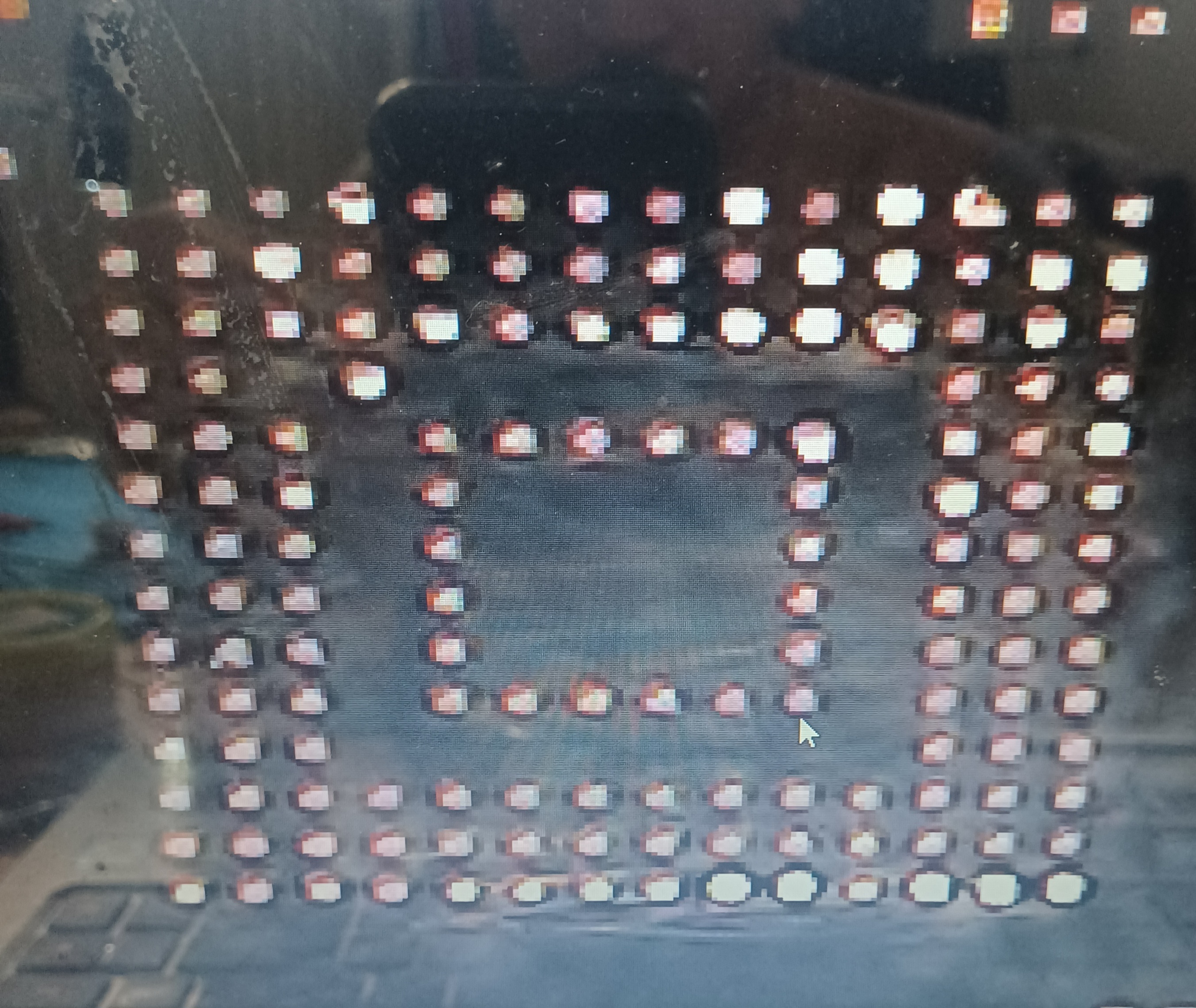

I reballed...these pins did not soldered...i think if i put the solder ball on it it will solder but i dont wanna stress the emmc with heat....and none of them is marked wjth nothing so i think its NC. Do you think i can leave it whitout the balls or worth try to reball then?
Yes absolutely fine, there are NC and it's working fine whiteout solder balls.

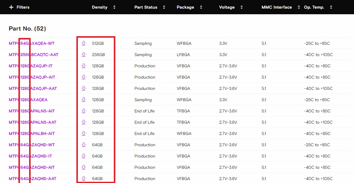

Another player entered on the select 512GB eMMC group. The MICRON!
With model MTFC64GAZAQHD-AIT
https://www.micron.com/products/managed-nand/emmc/part-catalog/mtfc64gaxaqea-wt
I definitivelly buy then if available!!!!!
Edit: False alarm guys, the Micron's site is listing erroneuosly a 64GB chip (512Gbit)
No that's 512GB alright. I think that's the only flash with parallel interface on this capacity
It is 512Gbit = 64GByte. The size is also in the product code: MTFC64GAXAQEA.
From the available datasheets, there is no 512GByte variant available in that range.
Density is written 512GB which is not what you're alluding to. You cannot have 64GB in your part number and have 512GB density.
From micron pages you can clearly see it written as capital B as in Bytes not bits to be consistent with the rest.
Though after thinking more about it I believe there's an error perhaps 512GB was a mistake. No way to find out until these micron b!tches open up their datasheets to the public not just their business partners.

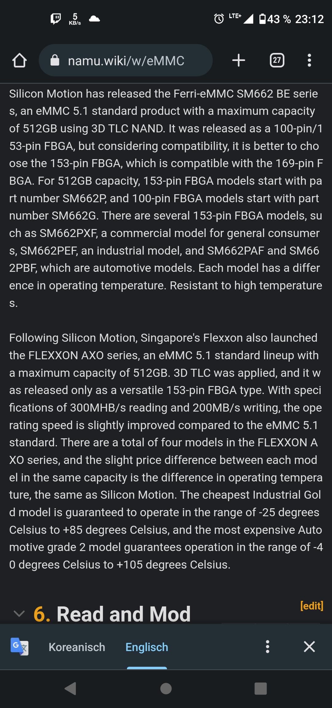

These two are 512 GB chips.
Ferri emmc (Silikon Motion)
SM662PBF-BESS 512gb
Flexxon
FEMC512GBG-E540 512gb
