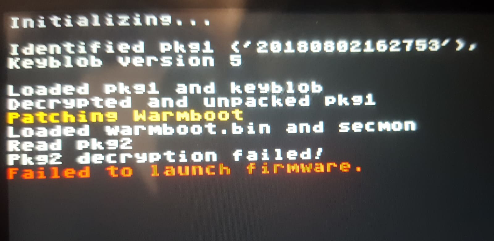

yeah sorry pkg2 error is because there's a mismatch between pkg1 and pkg2.
You will need to use choidujour to fix the emmc
I can't find a guide for you to follow, so wait a little bit while I do that or some else helps you.
Btw, did you restore a NAND backup or something? Because that's usually the reason. Or SX is super crap.

This makes no sense
I've taken backup and installed the same error waiting for you, thank you. Choidujour guide couldn't do much mixed :(
Do you think my console will open?
What do you think the problem is my friend?
if you follow the right guide, yes, choi can fix the emmc for you
do you have your original BIS keys? as you will need them
Reactions: Scofield_TR
I'm at work and will not be at home for at least 3 more hours sorry. First make a fresh backup and try to translate everything and get a good understanding. Pay attention to the huge red warning signs.
Thank you my friend.I understand.
fw and keys.txt files? Where will I find them?
