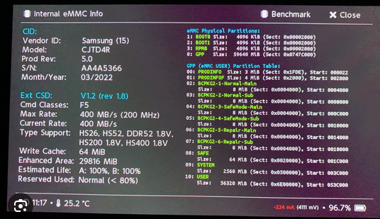

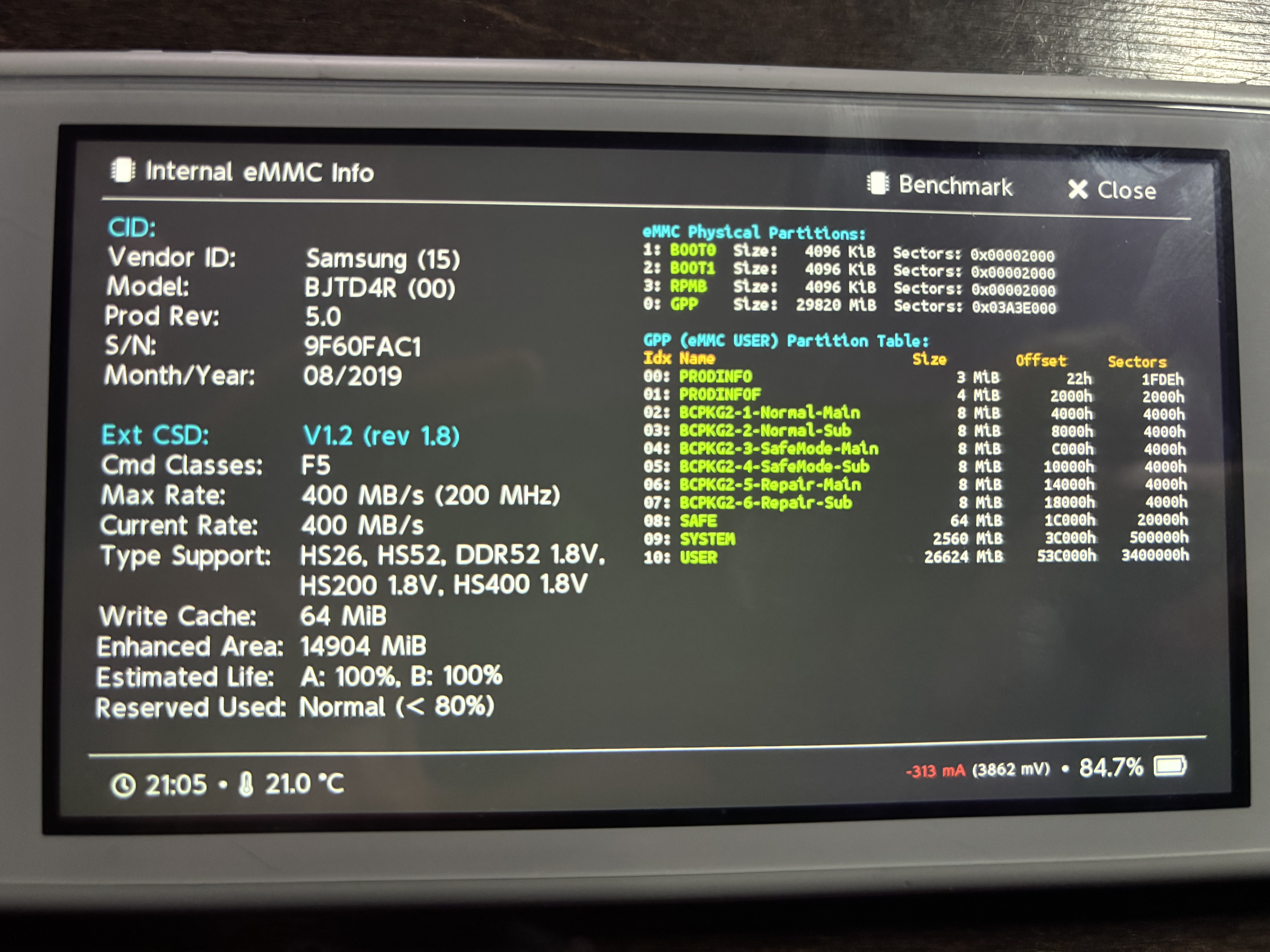

Hekate has page that shows some information about the internal emmc memory :
Especially the right part is important.
If that doesn't show this kind of information, then something might have corrupted the internal memory.
That can happen when there is some issue with installation of the modchip.
The internal emmc memory contains the OFW and the safe mode data.
I don't know if a NAND backup will help, as the issue that corrupted it might still be present.
mine looks like this
I‘m not able to get into the system folder with tegraexplorer, I get an error. does this mean something?

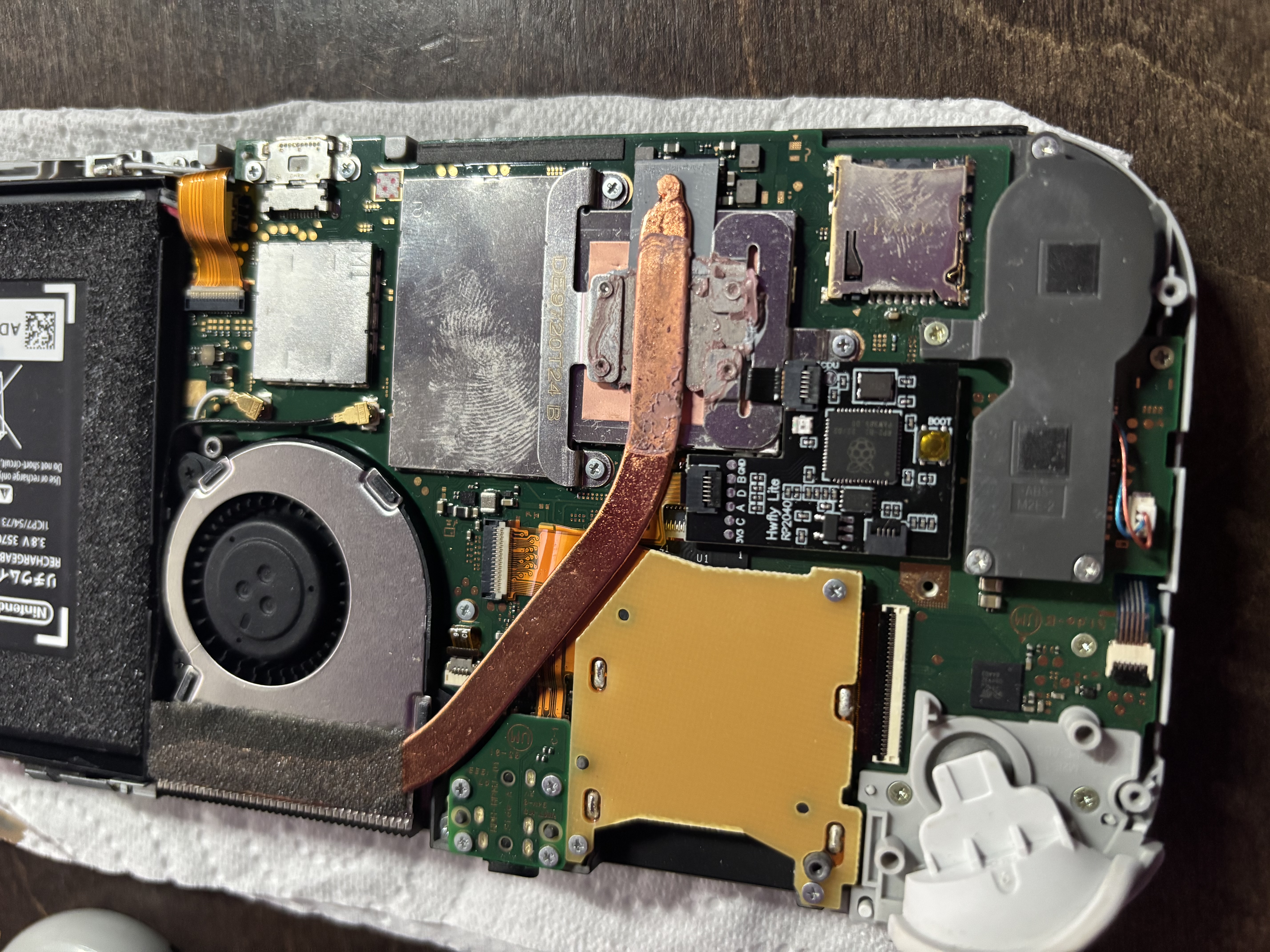

emmc partitions seem fine. also you sure it's an hwfly chip? hwfly been out of production for almost a year now, you probably got a rp2040 based picofly, send a picture of your modchip.
some picofly (also some hwfly clones (v4.1 v5) except instinct) are known to cause interference on emmc data lines, disconnect the chip and see if console boots to ofw
I disconnected the modchip and it just shows the nintendo logo for a second and shuts down again. modchip looks like this:
could EmmcHaccGen help?
yeah that's not hwfly, it's picofly/rp2040.

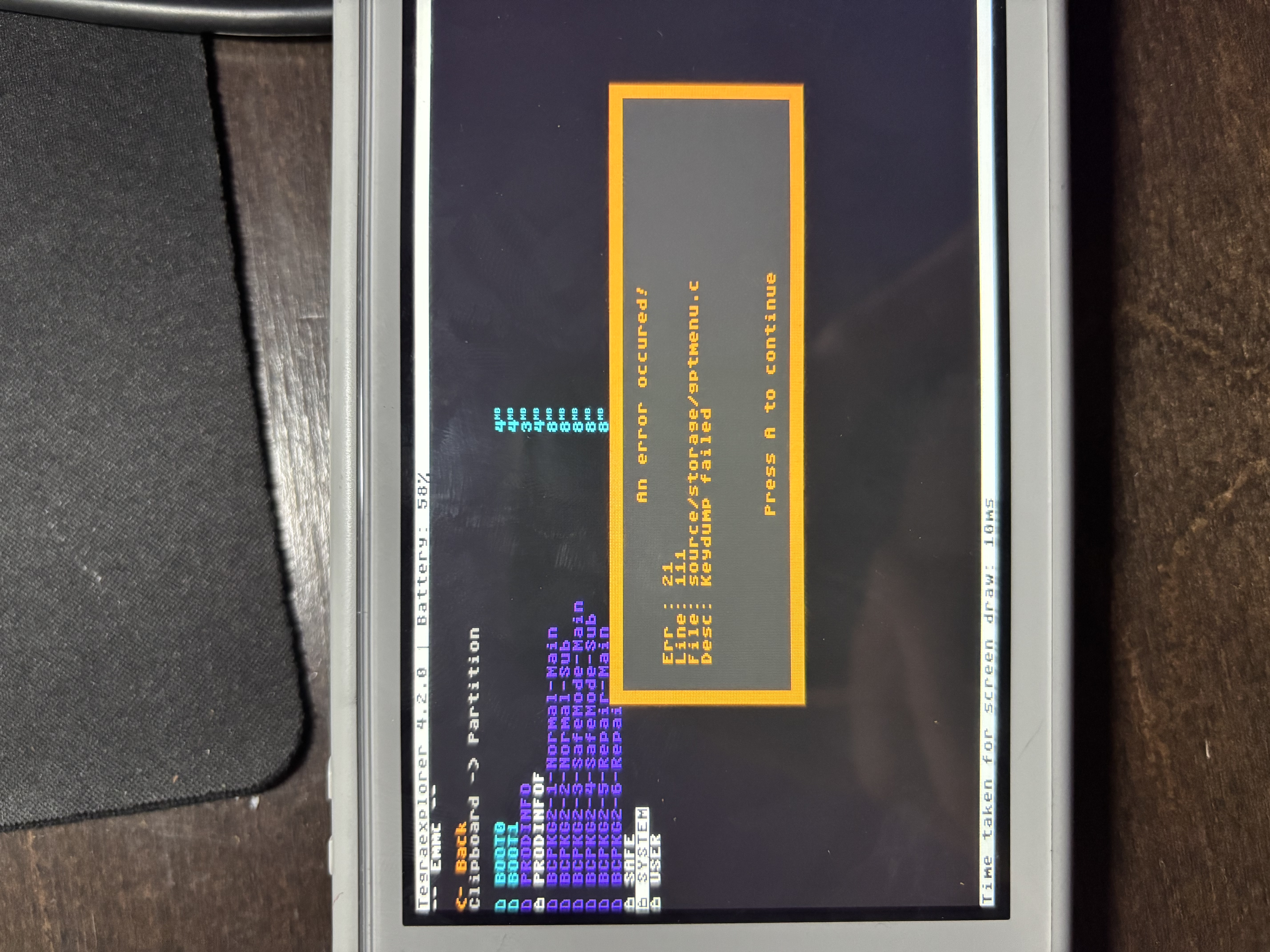

thank you! I tried it all. I can‘t even perform a systemwipe bacause of an error in tegraexplorer, which won‘t let me into the SYSTEM folder, neither. I formated the user partition after mounting in nxnandmanager and got a fuse error while booting. this is the error in tegraexplorer
if you can't even boot maintenance mode something's very wrong. reconnect the modchip and do a full backup in hekate, also dump your prod.keys. First try to format user partition in nxnandmanager, if that doesn't help you need to generate system titles with your own prod.keys, format system partition and reinstall system titles, that should fix it
where can I find a „how to“ about reinstalling system titles and formatting the system?
Did you dump your keys in lockpick before loading tegra explorer? Seems like tegra explorer can't find keys.
What's the fuse error? That shouldn't happen since you can't even boot ofw let alone updating it.
