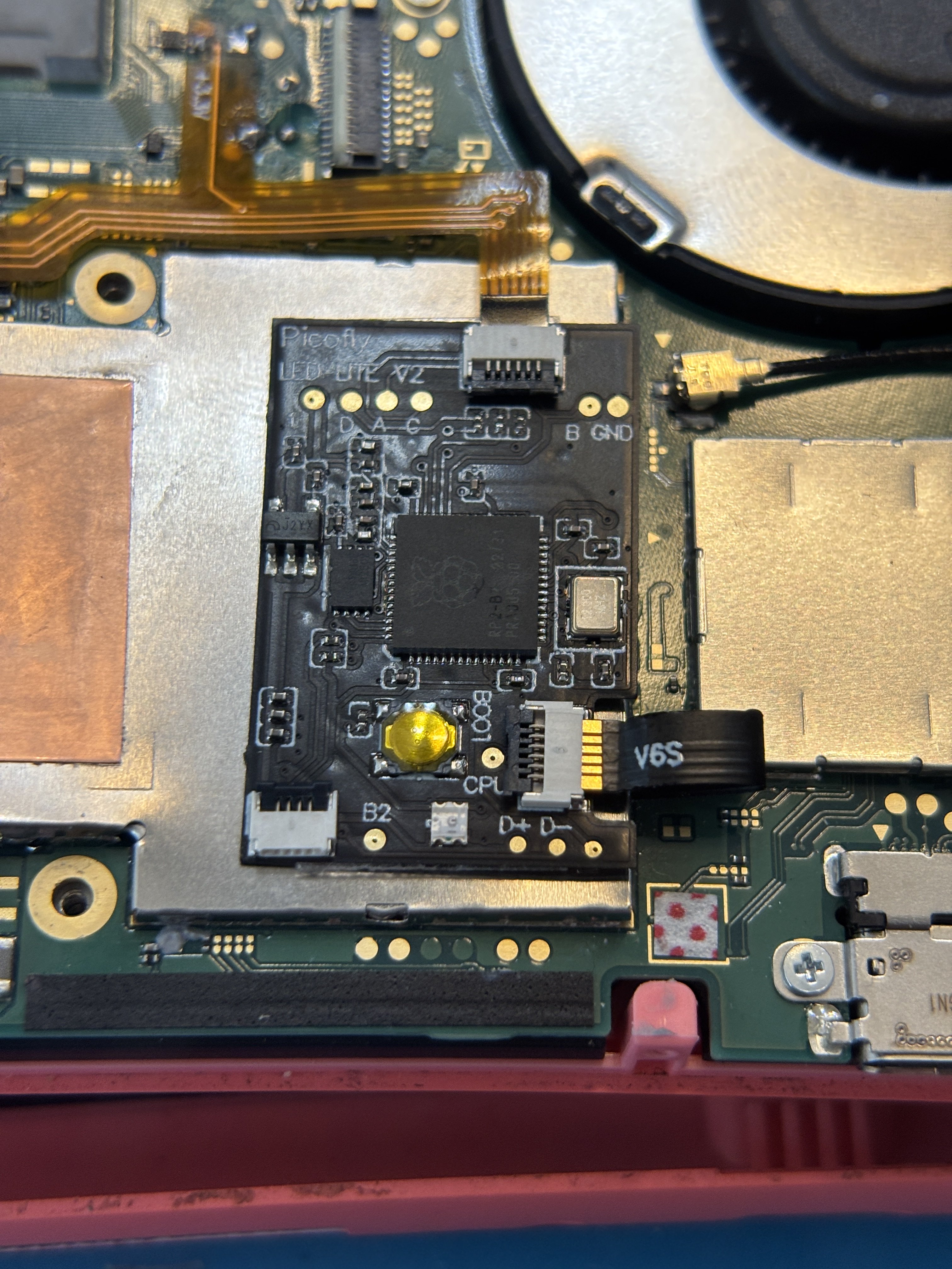

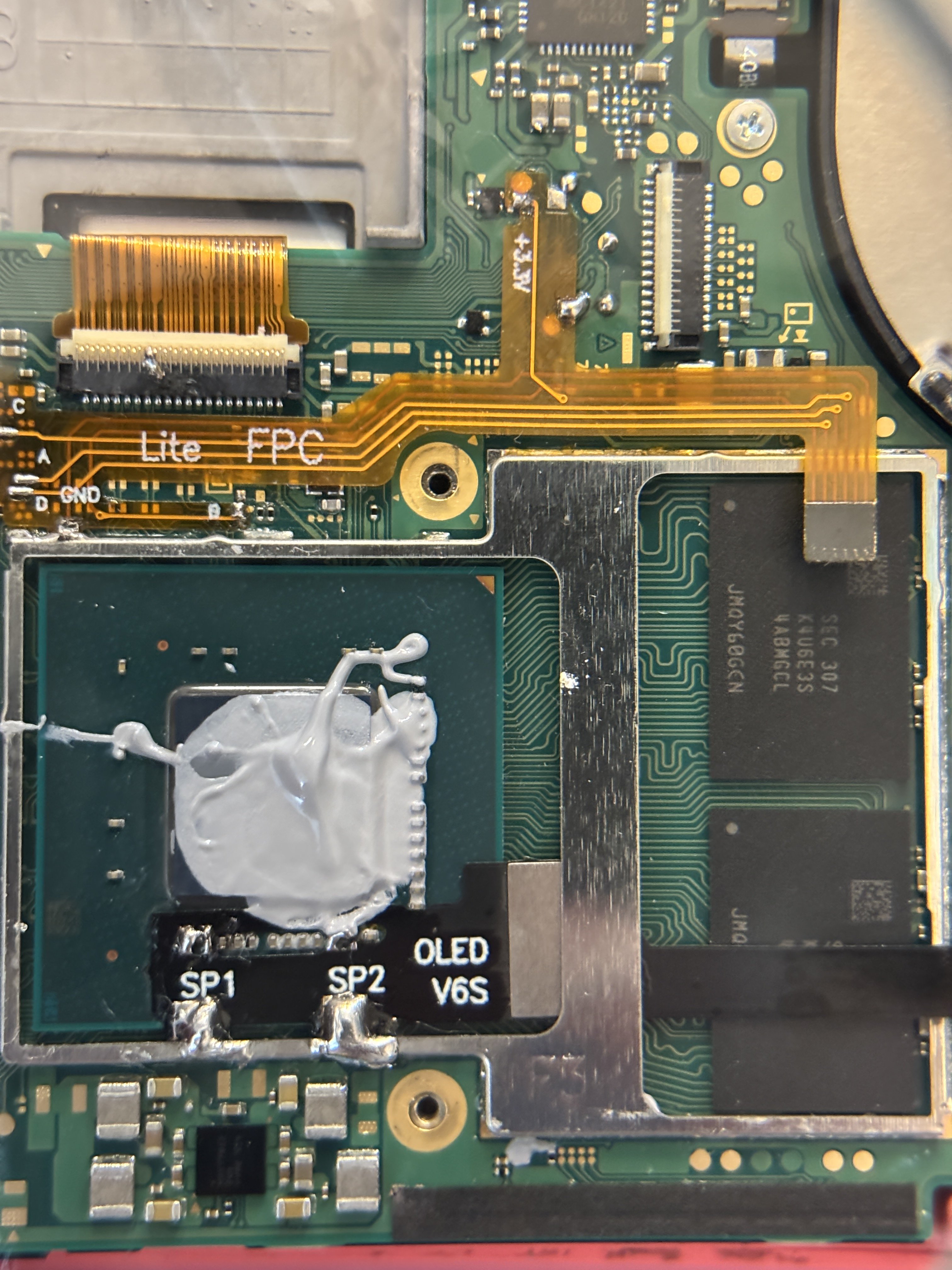

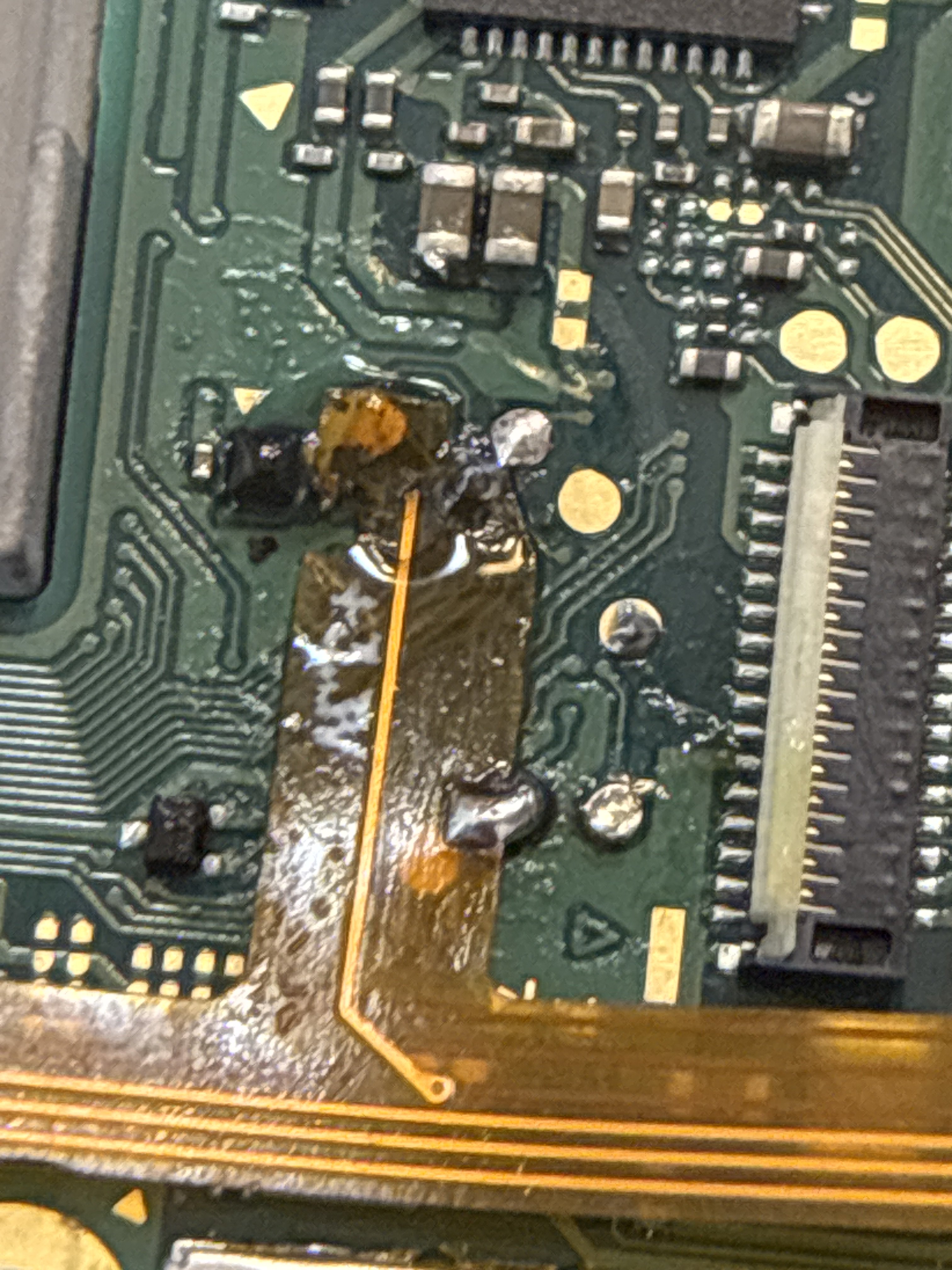

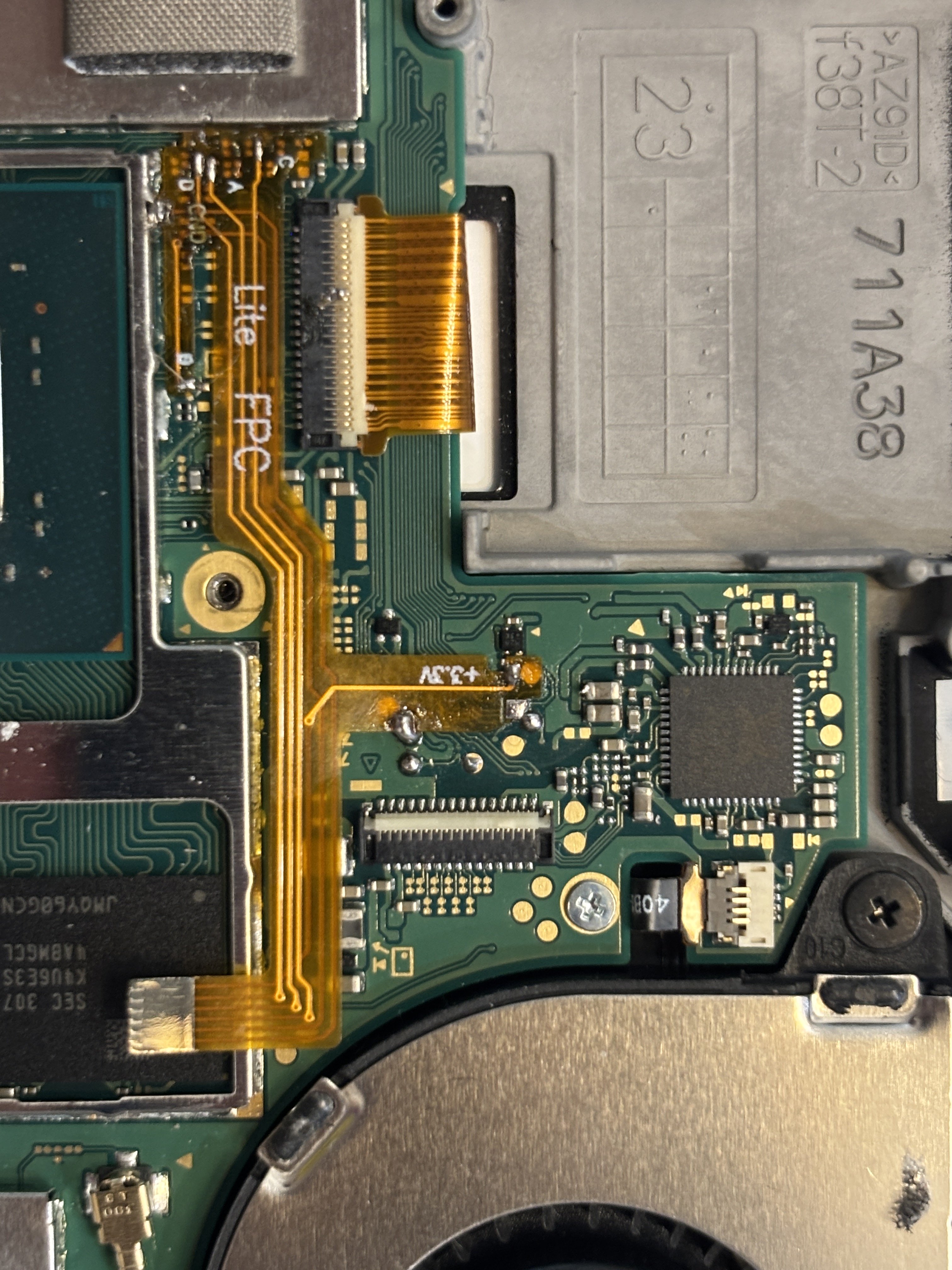

So Im doing a mod chip install the soldering seems alright. However, there’s no power from the system or mod chip.
Idk what to do currently checking with a multimeter, but if you see anything wrong or have any ideas it’d be appreciated.

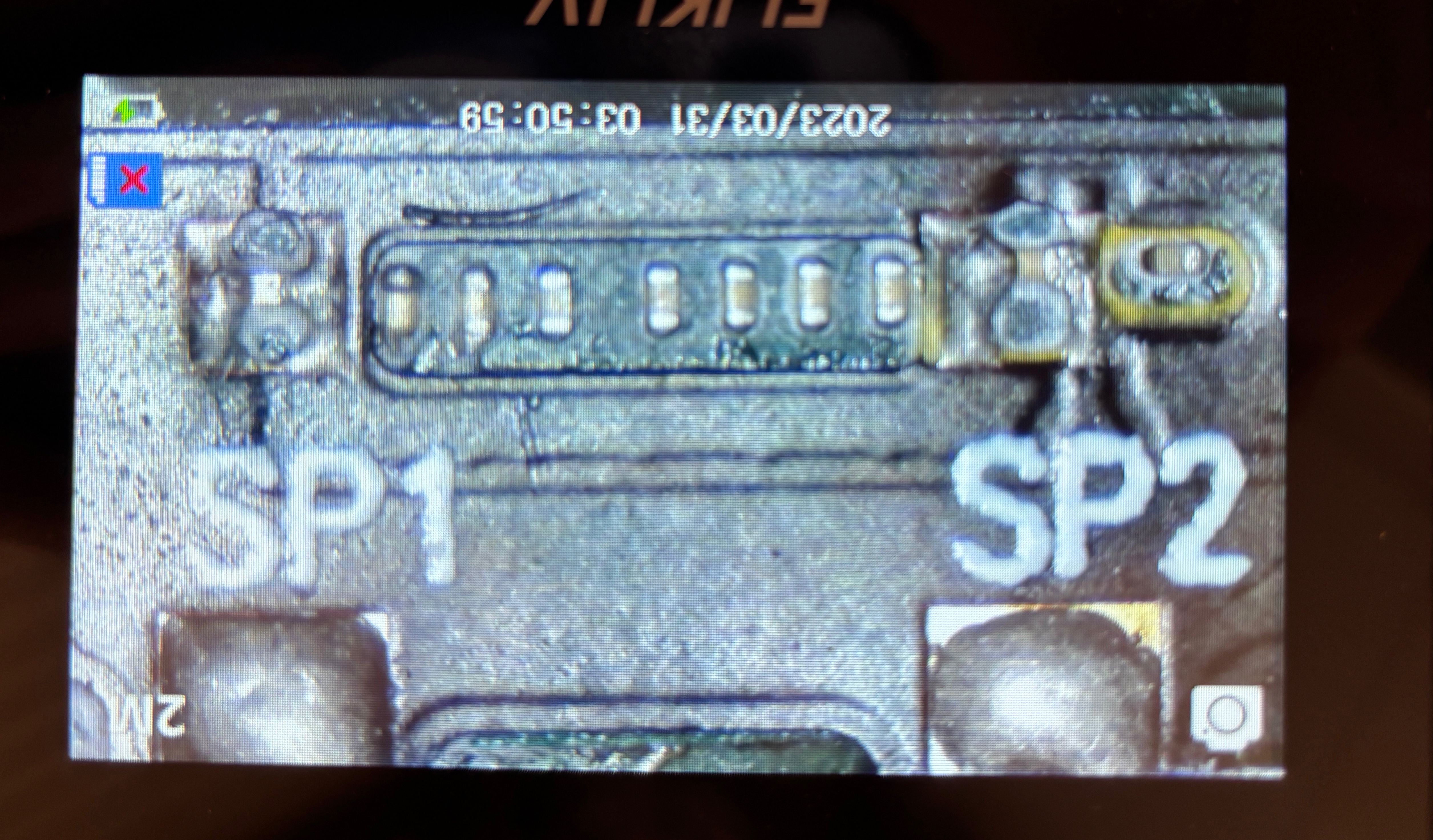

That cap on SP1 looks shorted.
Same with SP2.
