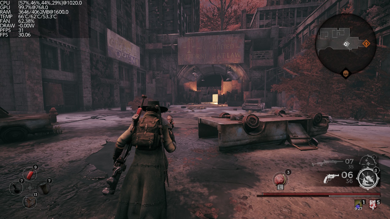

I've noticed that my Switch stops charging battery when I play in docked mode (different games). Usually it takes 15-30m before it stops.
Tested through Status Monitor Overlay and DRAW drops from ~2.0w to 0.0w.

And yeah - SoC temperature is higher than what it should be. I recommend changing thermal paste.
What is the average temperature for docked games with ~99% GPU load on Erista?
I already changed thermal paste back in November on MX-4. "Remnant" is the only game on my system that has that 63-66 temperature in docked mode for some reason (51°C in handheld cuz 460mhz). XC3 or DQ11 for an example usually has it around 58-61°C.

I captured exact moment when it stopped charging, and apparently it's 51°C for the battery.
Also, after some much more testings, that only happens in demanding/bad optimized games. "Digimon World: Next Order" has the same issue, but Xenoblade 3 or some pixel indie games does not.
So maybe that is indeed is overheating.
