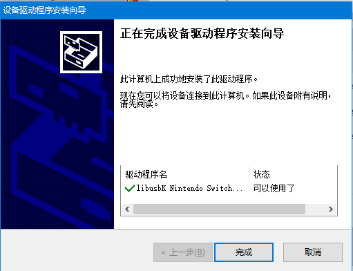

Okay on the windows computer reinstall the tegrasmashgui driver,
https://github.com/eliboa/TegraRcmGUI/releases
For the computer to detect the switch you need to have enough charge for it to show up, if the driver is setup correct.
I think that means the driver is installed correctly.Will let the switch charge for a day and see if I got any luck.
Also,maybe a dumb question, if I disconnect switch's battery and connect to my computer,will that bring up to RCM mode?
Well try to push a payload as you installed the driver already, the libusbk is what you needed.
Emmm...the computer still didn't pick up the switch.Will let the switch charge for a while and see if any mircale happens.
