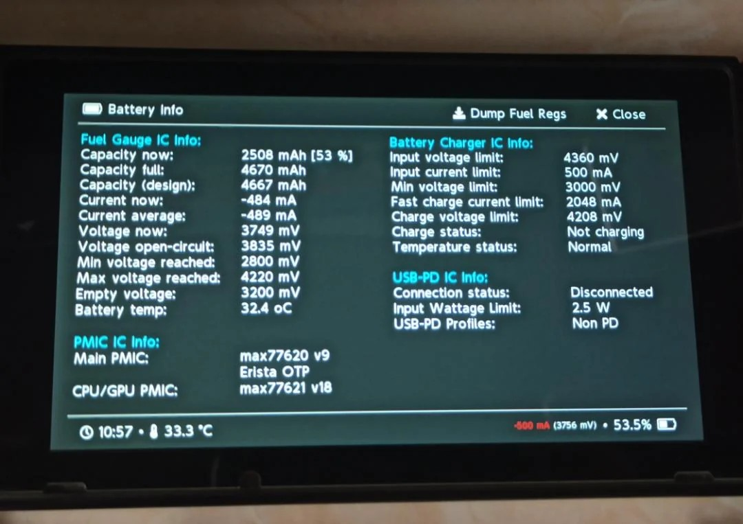

I have a problem witch my switch!!!It drains the baterry very fast, it drains 500 mA I think that's not good at all, and I already replaced the battery (sorry for my bad english)

Is it modded? If so, enter hekate , goto tools, and check battery info. Diviide capacity design, by capacity full to get a percentage of your battery health. Example:
You see it draining 500ma in hekate? That's not normal, usually it should be around 100-200ma depending on model (oled/v1/v2). also post a screenshot of battery info in hekate, it could just be a calibration problem
look at this :/

If you do a Google search for 'hekate battery menu', there are quite a lot of screenshots where the battery drain is around 500mA.
The playtime on a full battery should be about 3~7 hours.
If that is the case with your Switch then I would not worry about those Hekate numbers.
If you get far less playtime like 2 hours, then there might be another issue.
Well the battery actually do not survive the night..? The battery doesn't last the whole night uhh it drains very fast
did you max out backlight settings on option?
well the backlight is low the most time..
So I had the same problem,and I got the same answers.
I have 2 Mariko Switch consoles with nearly the same age, so I could compare and knew something war very wrong. But no one gave me a good answer online so I ran a few tests.
In Hekate the power drained with the same speed on both consoles. But in sleep mode on emummc I lost 30% in the same time the other lost 2%
In stock mode the battery also lasted normally. So I decided to format my emummc and updated everything from scratch and now the battery is working properly again. I assume there was a corrupted sysmodul/patch that burned through my battery power
