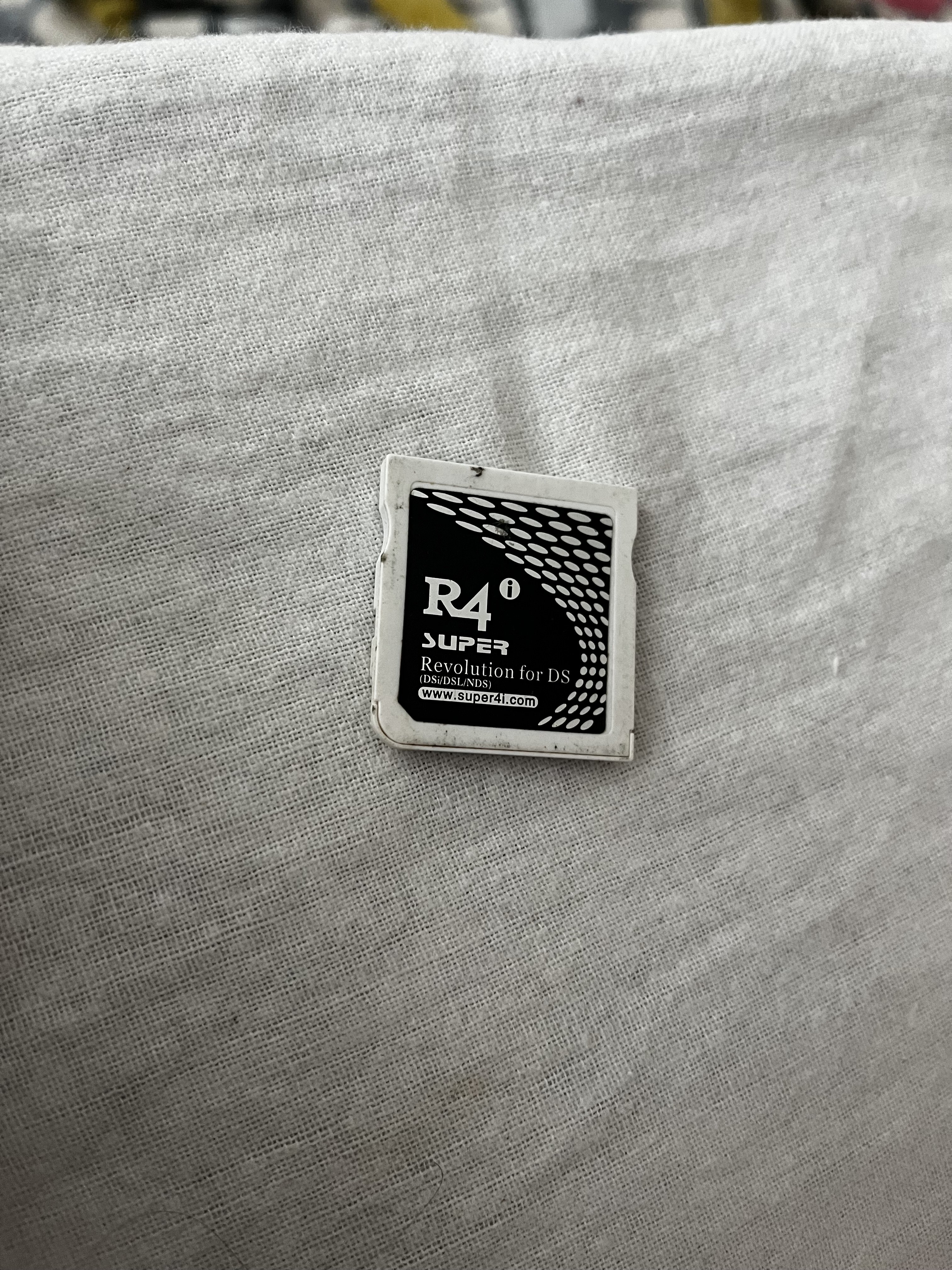

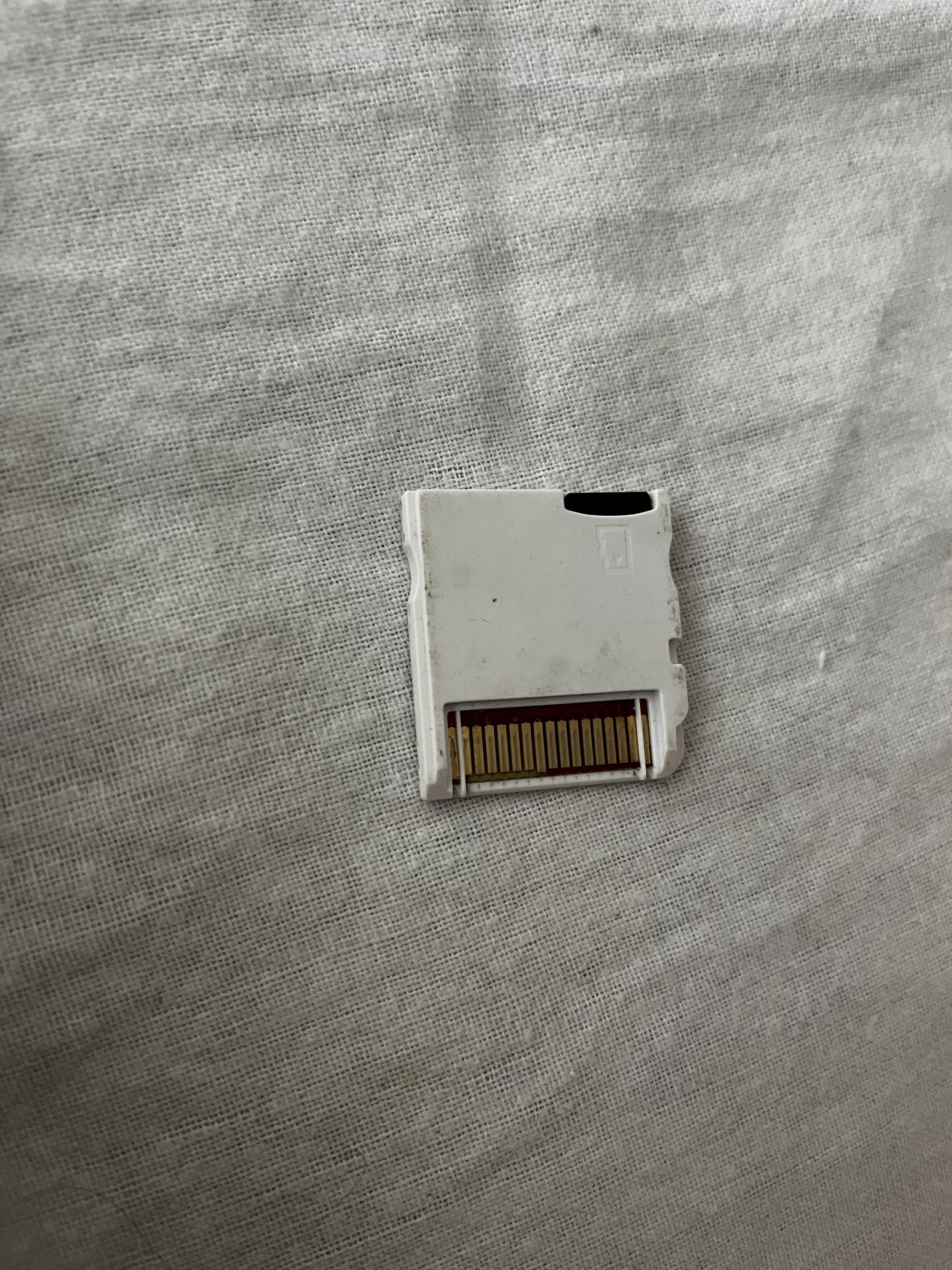

Hi Guys!
I was looking to set up autoboot on my super-4i flashcard,
I managed to download the original firmware from the github repo but the autoboot feature isn't working,
it looks to be similar to and Acekard+ 3ds in terms of file names and structure but moving the
_ds_menu.dat file to the root of my folder causes the card to no longer boot ://
if anyone has any info or knows how i can fix i would greatly appreciate as the default version of woodmenu that is included is terible and has no option to change skin :((
many thanks!

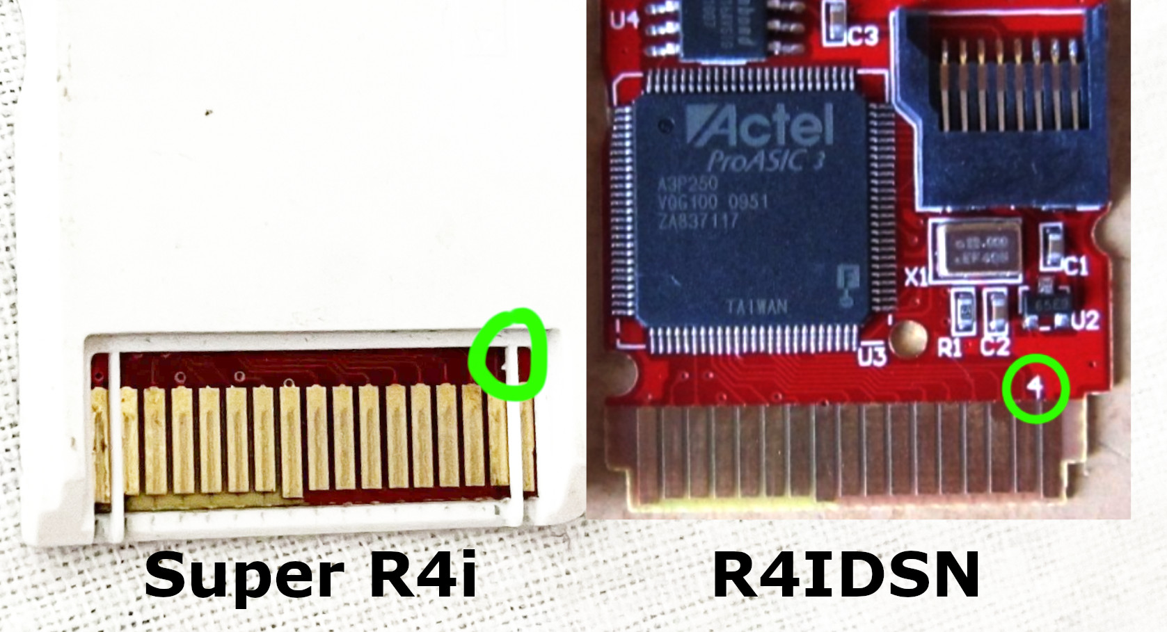

Yes Ofc here you go
EDIT: Characteristics such as the traces from the cartridge contacts, closely match to the R4iDSN hardware.
TWiLight Menu++ does not officially support the R4i Super yet from what I can tell. However, you can install the BL2CK kernel on your flashcard. You need to do a fresh format of your SD card to FAT32, then extract the kernel files to the root of the SD card. Then create a new folder called "Games" and transfer all of your ROMs inside of it.
https://archive.flashcarts.net/super4i.com/BL2CK_1.31.0.zip
